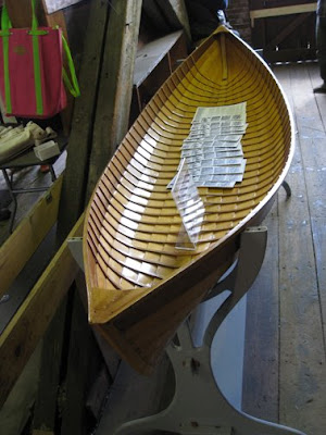

I always thought that the canoes that Rushton made for George Washington Sears had Elm ribs and stems... Was a nice Sairy Gamp at the Maine Boatbuilder's show built the traditional way. (The Apprenticeshop, I think?) I wonder if the ribs were elm in that one?
