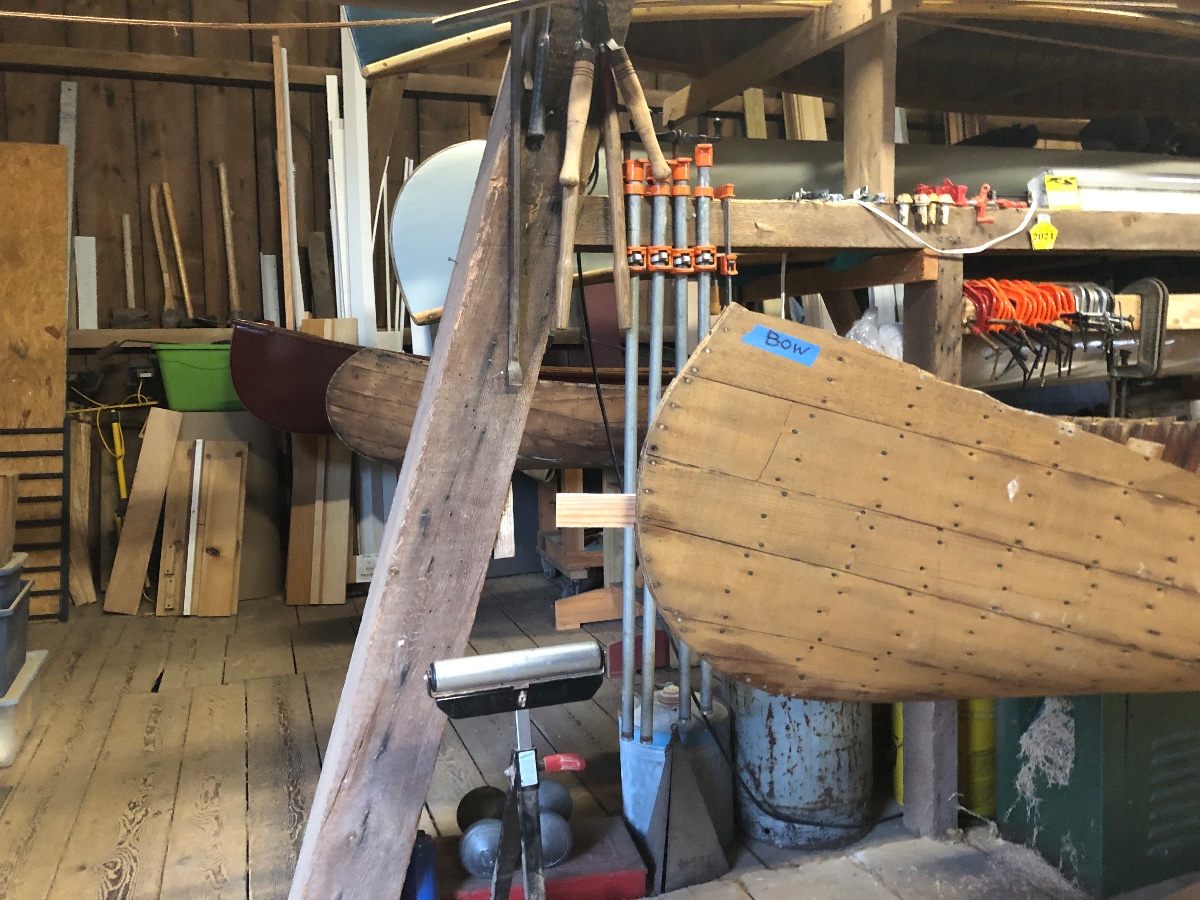

My 1927 Old Town 50# is put aside for a bit after repairing rib tips and stem tips... and the 1938 50# is currently in center stage undergoing inwale repairs and re-fitting into the canoe once I have stripped varnish from the portions which will be inaccessible once re-installed. I couldn't avoid digging into two new canoes...

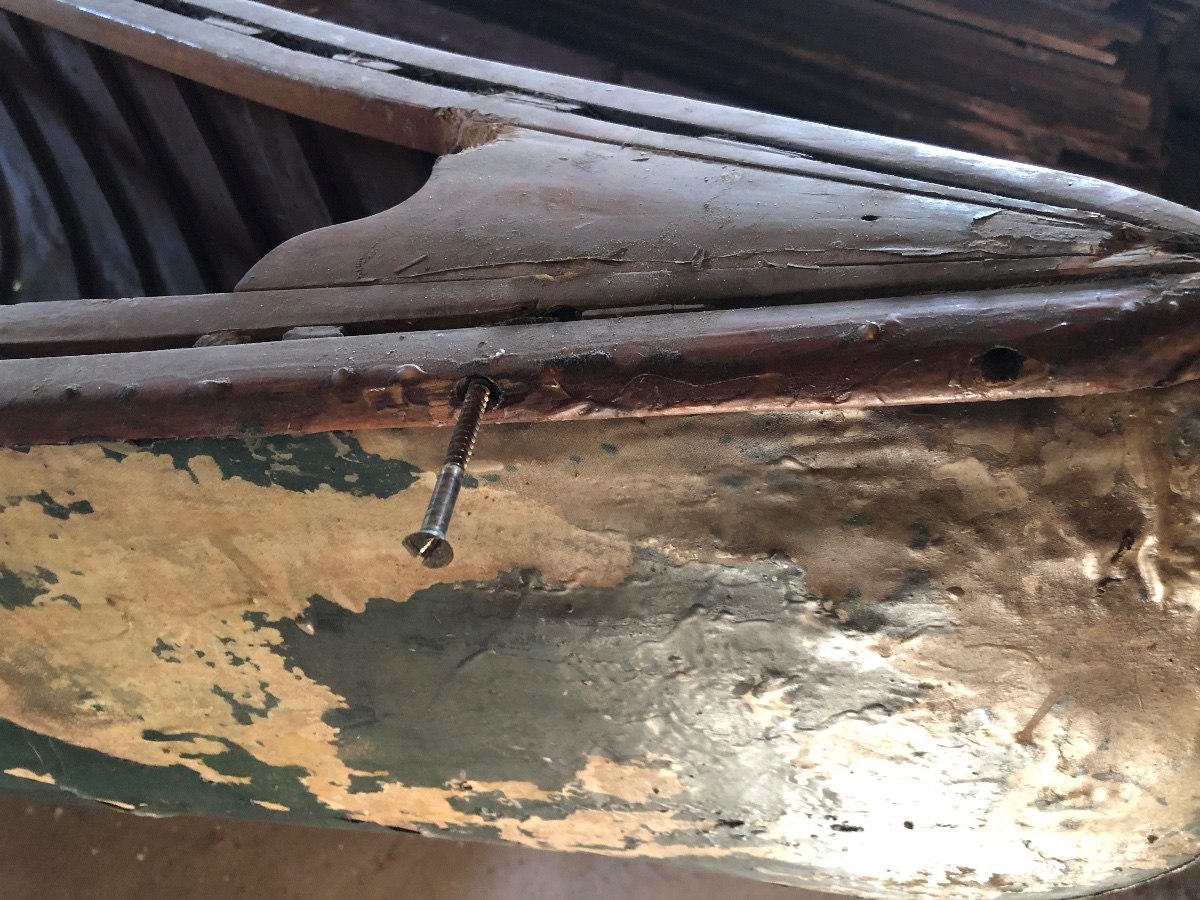

It's 'fuller' in the ends, or as some might say, the cheeks. The outwale is attached from the interior, through the inwale except at the decks where it's screwed from the outside as normal, note that the screws at the rear of the decks are huge- 2.5" long and #6 gauge.
And the outwales are D-shaped, quite nicely and without a rabbet, so the canvas top edge is visible between outwale and rib:
