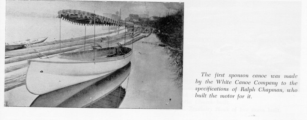

The images below show the canopy brackets on my Old Town Charles River model canoe. It shipped in 1907 but there is nothing on the build record about these brackets. The last photo shows Dave DeVivo's courting canoe with a canopy from the Assembly a few years ago. Another style of canopy is shown at http://forums.wcha.org/attachment.php?attachmentid=5855&d=1220041394 on a slightly larger canoe. Another more colorful one is attached below. The old canoe company catalogs show a broad variety of canopies on canoes. Let us know what you decide to do.
