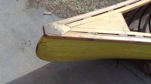

Hmm. Would lowering the ends explain the gussets/caps? Sorry, I forgot to include this pic earlier.
attachment.php
That picture is quite revealing...Benson's comment about previous work is well summarized in that photo. The inside rails and deck are not original. Neither are the outside rails It does appear that when the work was done that the form of the boat was also modified. This type or repair is an option for resurrecting a badly damaged boat...
It also appears that the canoe has been covered in fiberglass...arguably that is not an ideal covering for the hull.
