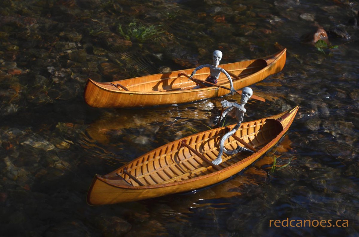

Good to see that there are others out there doing silly things!
Many years ago I made a cedar rib model and a few other all-wood variations for fun. I don't have other pics on hand of it except this, which was the result of me thinking one year that maybe the wcha needed a halloween theme for the calendar...alas, it would seem that I was the only one who thought this a good idea; but now I finally have a reason to post the pic. :-)
Many years ago I made a cedar rib model and a few other all-wood variations for fun. I don't have other pics on hand of it except this, which was the result of me thinking one year that maybe the wcha needed a halloween theme for the calendar...alas, it would seem that I was the only one who thought this a good idea; but now I finally have a reason to post the pic. :)
Excellent - yours even got thwart tags. I like the way the skellys are looking at the camera! Mine just get to be paddled by an artists model.
