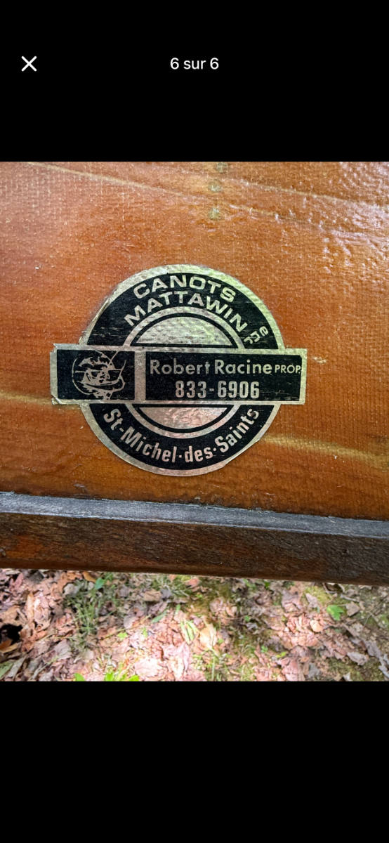

Ribs are 1 7/8" or 2" wide, edges beveled but no taper, spaced 1 3/4" to 1 7/8". Planking can vary but usually was 3 1/4". Sometimes a serial number can be found on the inside of the forward stem. The label seen in the first picture was used from 1960 to 1968 only. Decks are usually 11" long but this can vary. Often, they had "U" bolt on the decks. The are usually the same thickness as the inner rail.

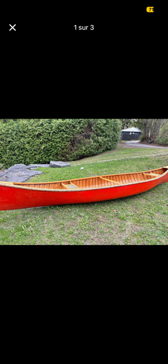

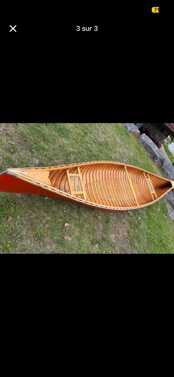

I recently purchased a beautiful, pristine red Mattawin cedar canoe here in Quebec, and I am trying to narrow down its exact production timeline. I read through the helpful "Canots Mattawin" reference thread you posted back in 2008, but I have a few conflicting clues that I am hoping you can help me untangle.
Here is what I know and have observed about the canoe:

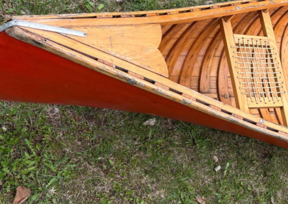

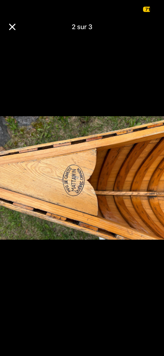

  • The Logo: My canoe features the authentic circular black ink stamp printed directly on the wooden deck ("Mfg. de Canots Mattawin, Québec, Canada").

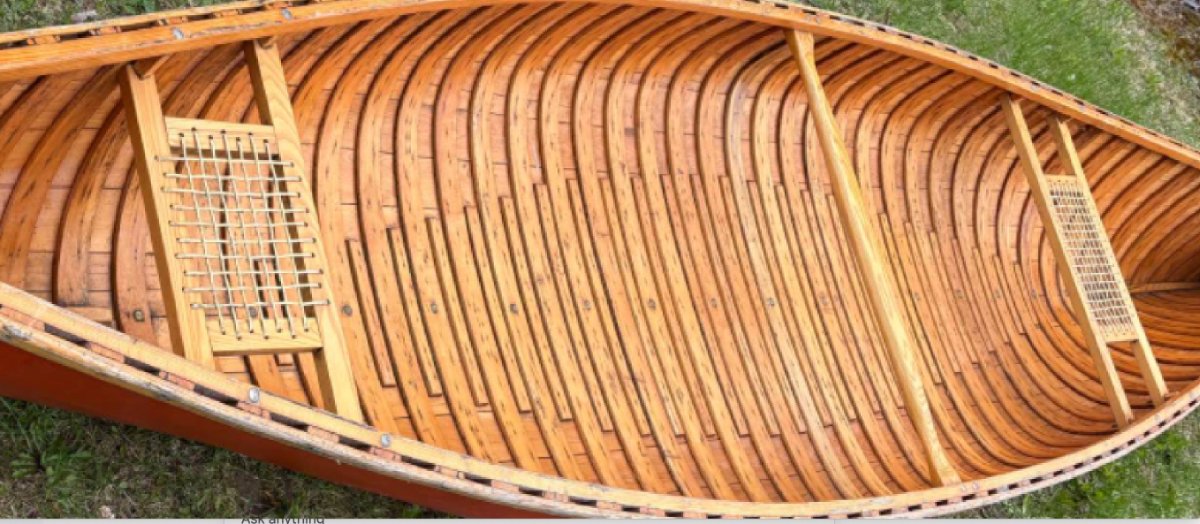

  • Interior Construction: The ribs are very tightly spaced, beveled on the edges, and have no taper. The thwarts and inner rails appear to be mahogany.
  • The Seats: The seats feature a synthetic or cotton cordage woven in a perfect square grid pattern.
  • The Hull: The exterior red hull is completely smooth and glass-like, with a high-gloss finish and no canvas texture.
  • The "U" Bolt: There is no U-bolt on the deck, but there are two pre-drilled holes where one used to be.
According to your 2008 post, the label seen as an attachment was strictly used from 1960 to 1968. However, when I contacted the seller, she mentioned that her father bought the canoe in the 1980s.
So I presume that circular black ink stamp was used sometimes after 1968.
Based on your knowledge of Robert Racine's workshop history, do you think this is a 1980s canoe?
I have attached photos of the interior construction, the ink stamp, and the profile of the hull for your review. Any insight you could share on its history would be greatly appreciated!

Thank you John ! She really is a handsome canoe, which I acquired for $400 only. I feel very lucky to have found such a great deal for a traditional cedar canoe!
Regarding the decal, I wanted to share an interesting finding that might challenge Louis's timeline (which mentions this black and gold label was only used from 1960 to 1968). I recently came across another Mattawin canoe for sale featuring this exact same black and gold sticker, and that specific canoe was documented as being built in 1976.
It seems Robert Racine might have used this logo/sticker design for much longer than previously thought, well into the 1970s!
