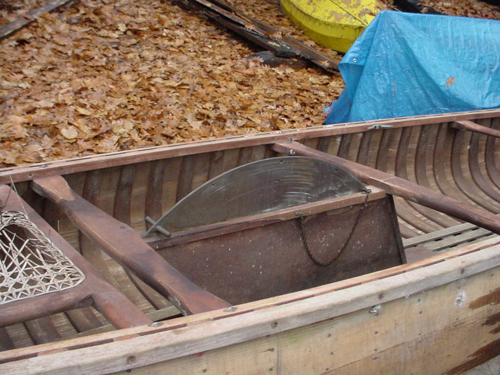

Also, do you face the leeboard brackets up or down?
Several Old Town catalogs show them with the brackets facing up. With the brackets facing down, it will be more difficult to reach the lever bolt as you raise and lower your boards.
I usually mount the leeboard brackets face up to help keep the canoe dry. A close examination of the picture at http://forums.wcha.org/attachment.php?attachmentid=10026&d=1268689103 shows a small wave that rises vertically up the leeboards as you start to go faster. Having the brackets up increases the speed you can reach before you start getting wet from spray. I think that they look better mounted down but I will only rig them this way if I don't expect to be going fast.
I prefer to keep the sheet in my hand and will use a pulley on the boom for a mechanical advantage that eases the strain. This is also shown in the picture mentioned previously. I have a sailing canoe that has old cleats for the sheet on each inside rail as shown at http://forums.wcha.org/attachment.php?attachmentid=6486&d=1226688183 and http://forums.wcha.org/attachment.php?attachmentid=6489&d=1226688183 but I don't use them.
The easiest way to change the boom angle is to move the point where the halyard attaches to the spar. I usually keep the aft end of the boom raised slightly. The table at http://forums.wcha.org/attachment.php?attachmentid=1064&d=1136757320 lists the original locations of the Old Town gooseneck / jaw and the halyard attachment point for various sail sizes. The message at http://forums.wcha.org/showthread.php?969 has additional original Old Town sail rigging information if you are curious. Happy sailing,
Just remember that if you turn the bracket over, you also have to turn the leeboards over to avoid the dreaded "airfoil effect" :)
