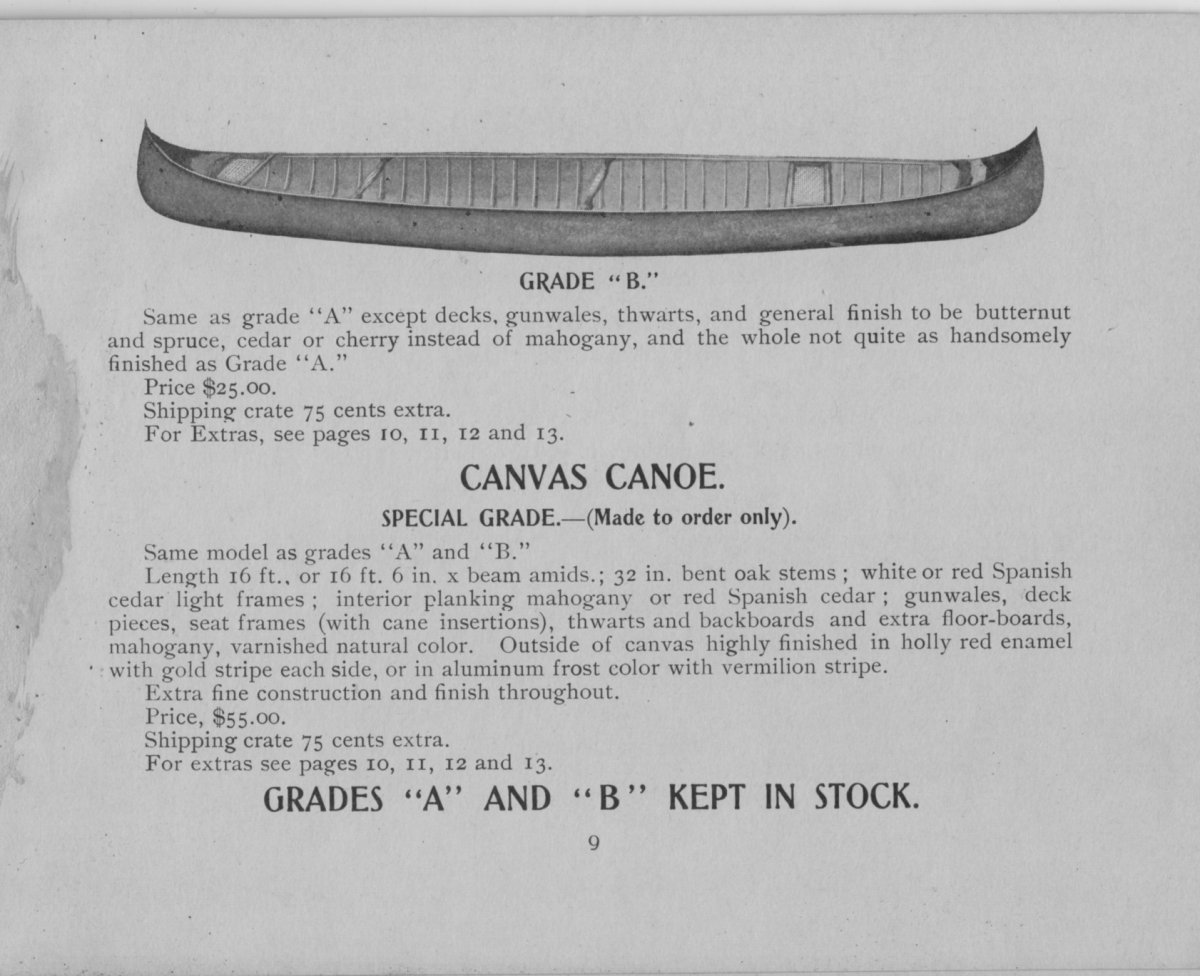

I have also seen a boat like Michael Grace's canoe (one owned by a Chapter member) that is attributed to Racine canoe company ,
I was thinking Racine when I saw Michael's photo, too.
Do you have dimensions, Al? Can you determine if the yoke and seat stringer are original to the canoe or later additions? In several ways, it looks like it could be of St. Lawrence River origin.
No I have no exact dimensions and have not yet physically seen the boat. So far all I have is pictures and a rough dimension of about 13'. Not much to go on, I know. Let me see if I can post some other pictures. I think I posted the 'best' of them. The stems are rather odd for a guideboat built canoe. That, and the very flat nature of the floor is not guideboat-ish. It almost appears to be an all- wood built version of a wood canvas canoe shape.
