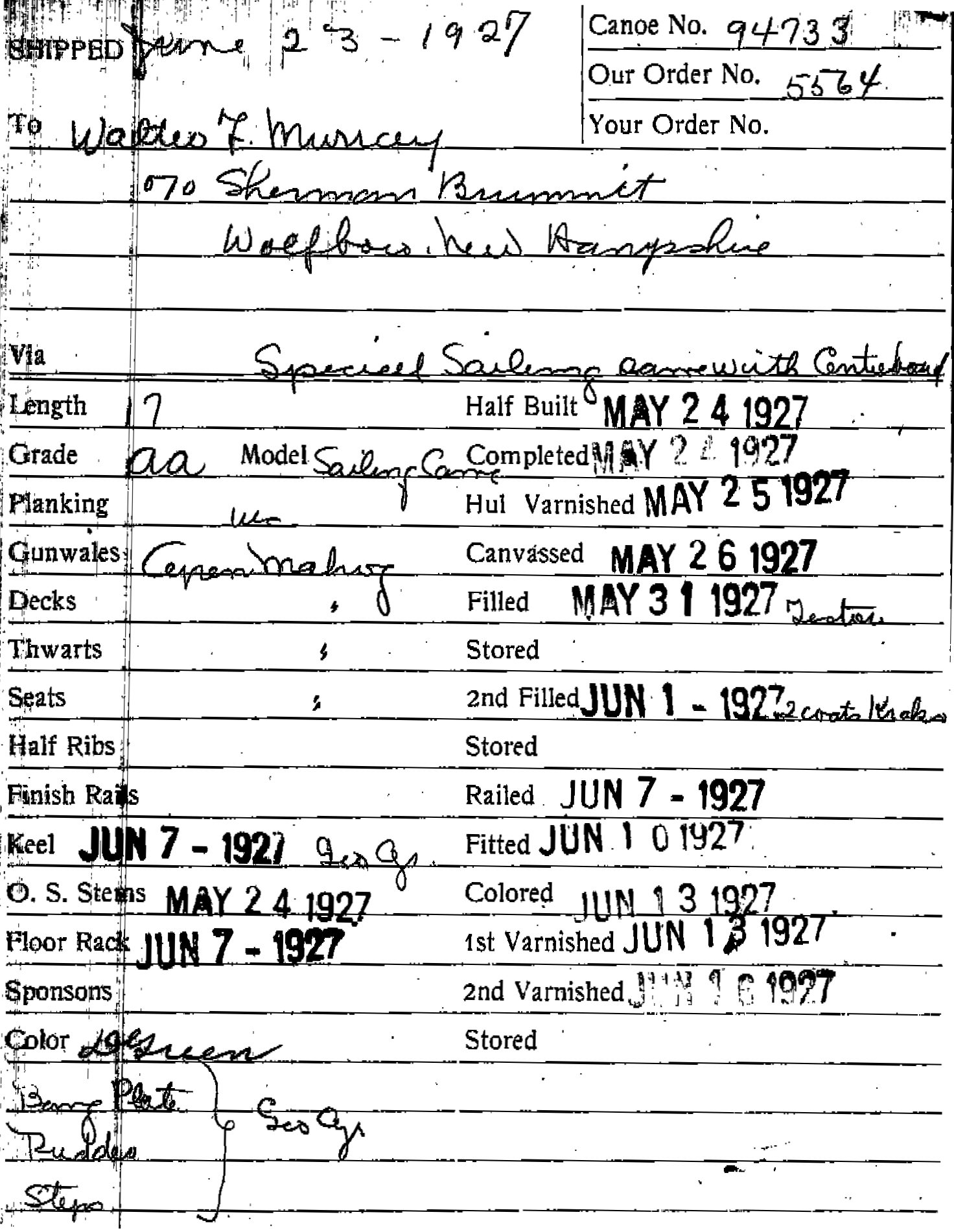

This does seem a bit late for a round hole mast step but I don't know exactly when they changed to the square hole ones. The canoe at http://forums.wcha.org/attachment.php?attachmentid=6475&d=1226605573 from 1927 has a factory step with a round hole and the one at http://forums.wcha.org/attachment.php?attachmentid=4224&d=1204470667 from 1936 has square ones. The catalog pictures of the sailing rig changed between 1931 and 1932 as shown at http://forums.wcha.org/showthread.php?4107 so this may be when the mast step changed as well.
