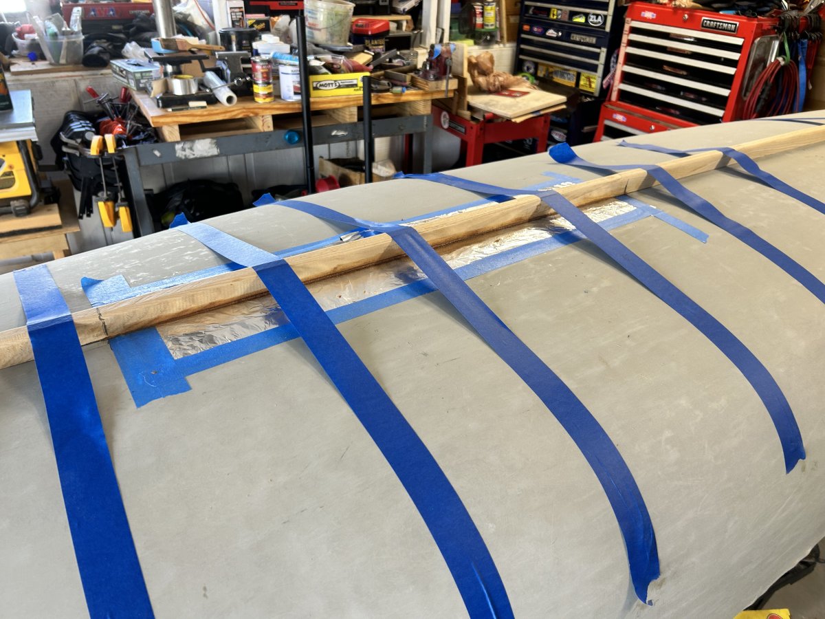

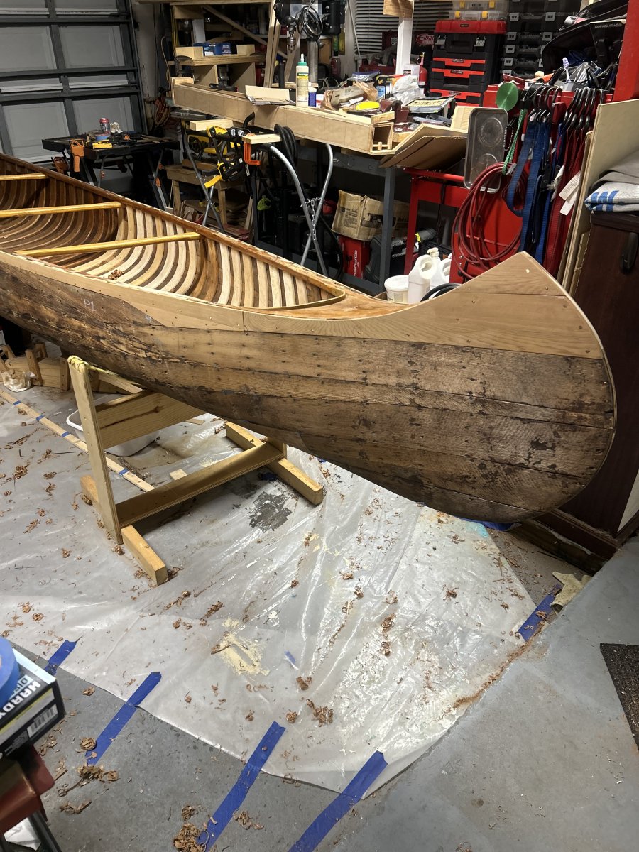

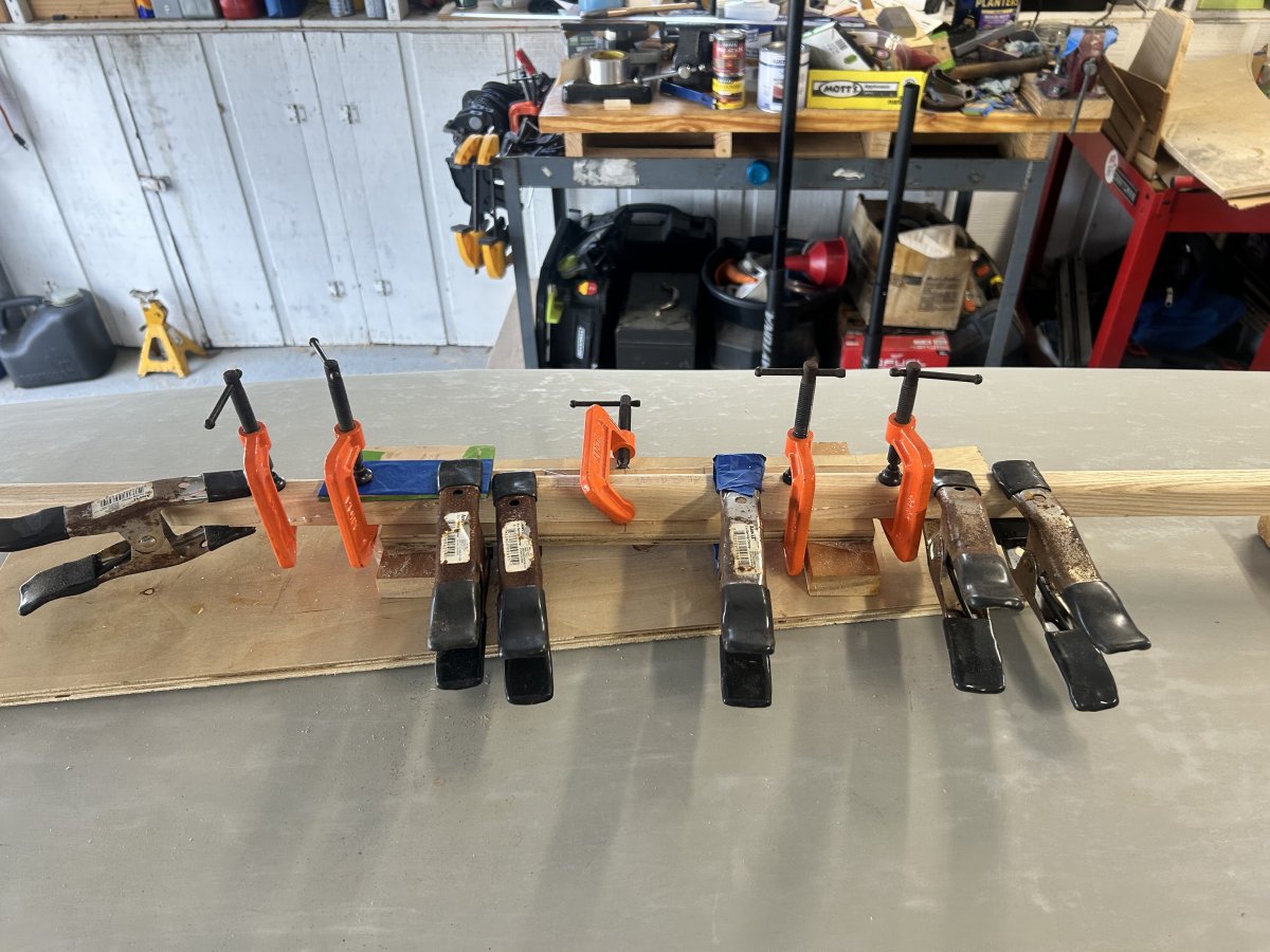

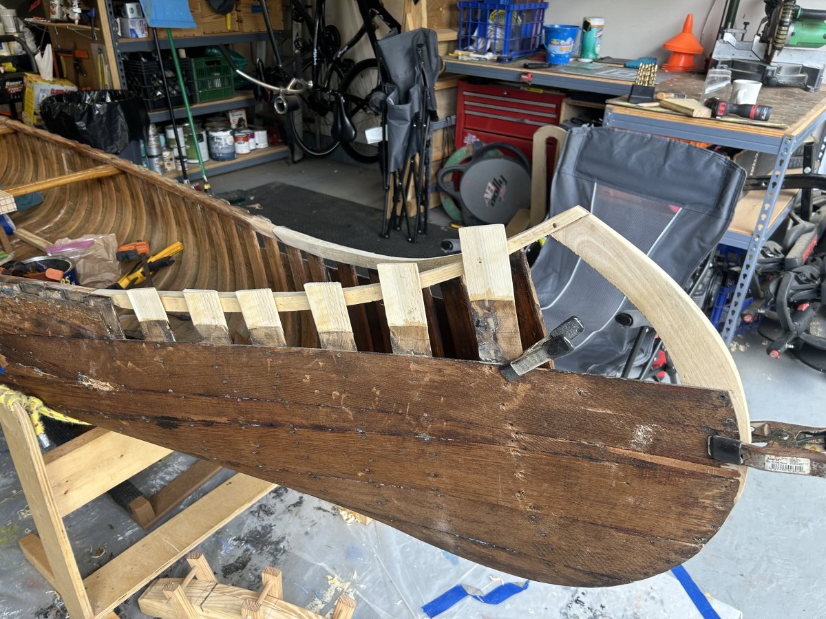

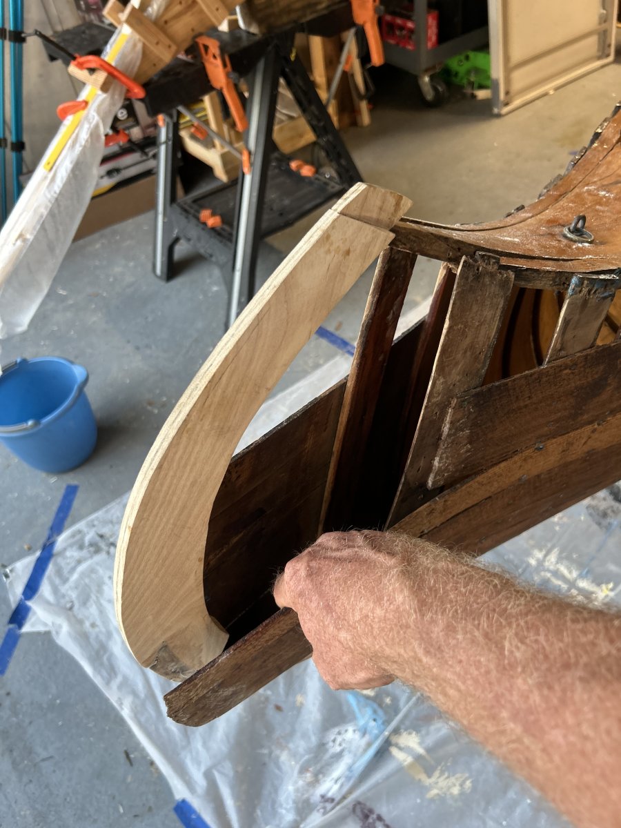

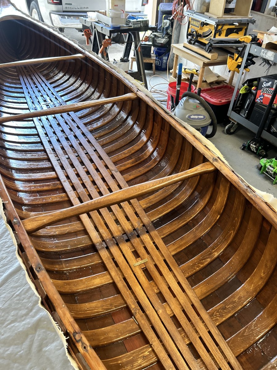

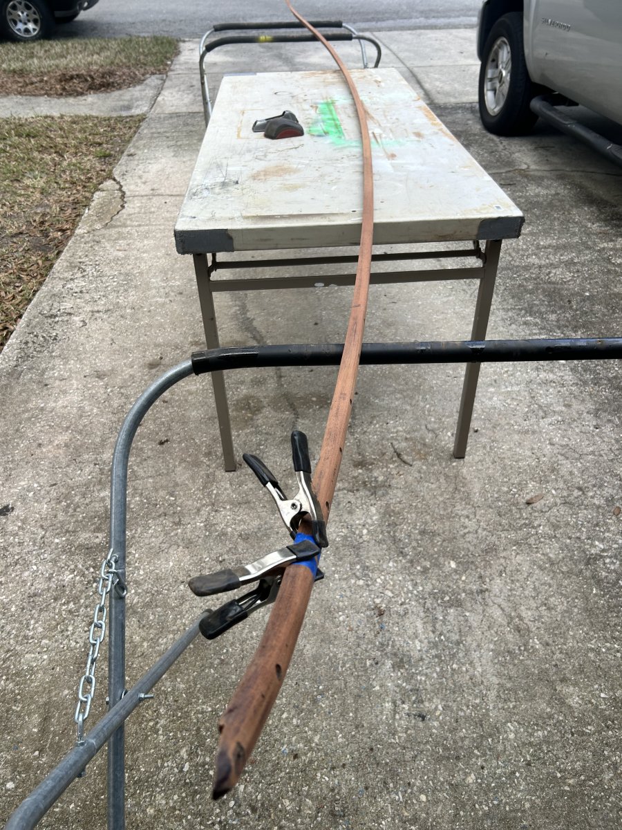

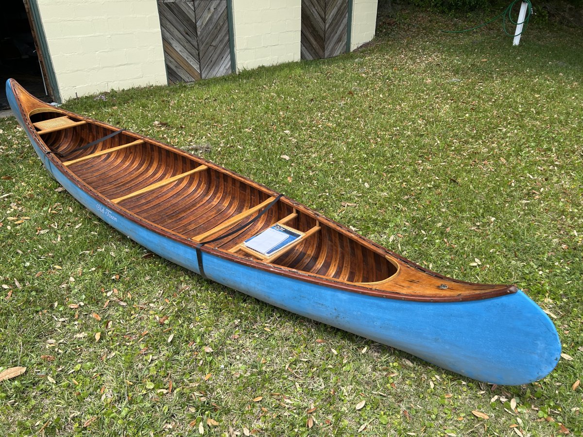

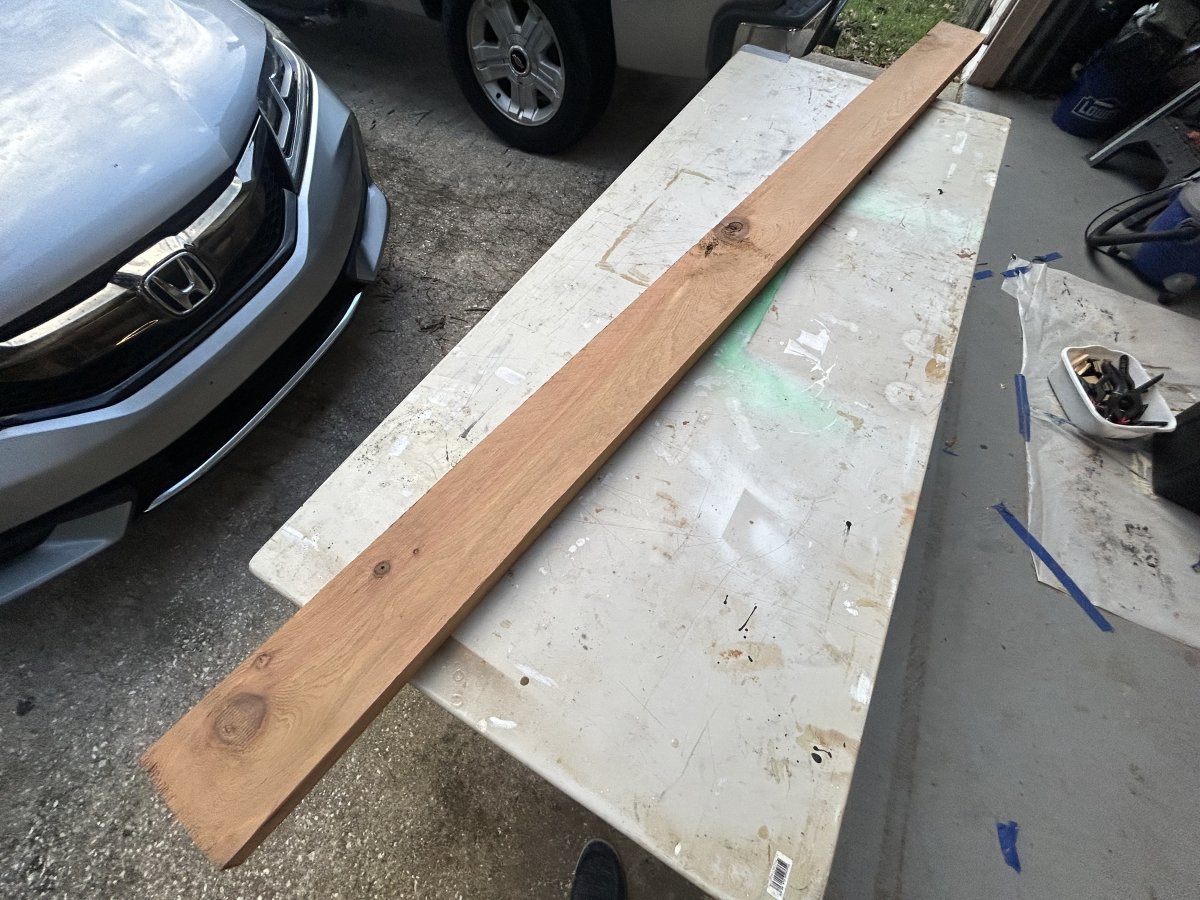

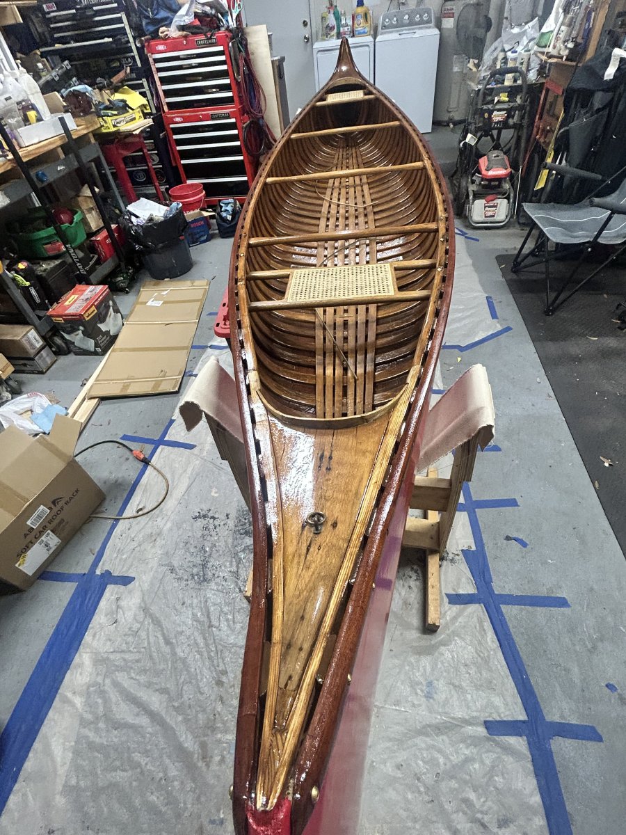

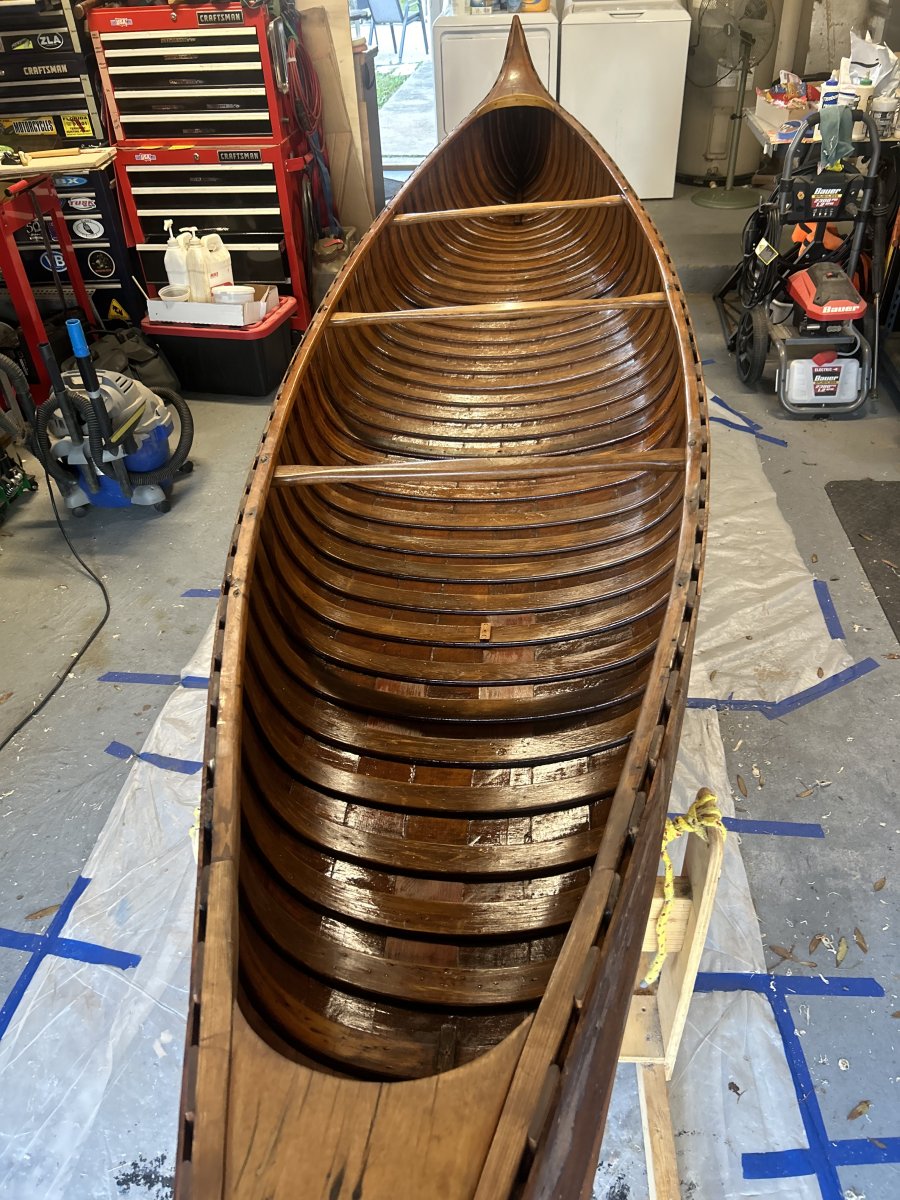

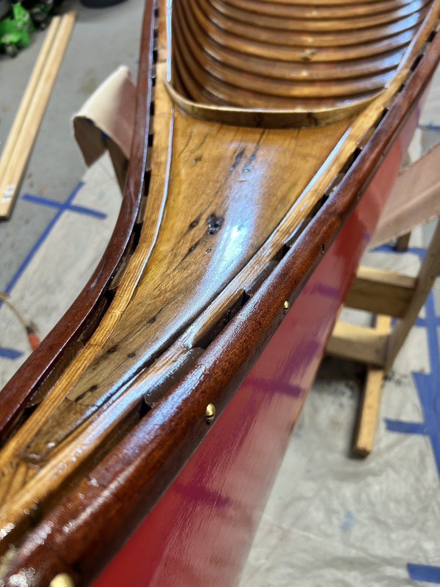

The finishing touches are all that remain. One issue was the front deck coaming, currently in 2 pieces. I tried several different techniques to bend new coamings of Cherry. I really didn’t like the bright yellowish oak pieces the previous repair looks to have installed. It’s only 1/4” thick, but I couldn’t get it the cherry to work. Most likely the wood grain orientation was just wrong for this application. I ended up using epoxy to glue the piece back together and then screwing it into the deck and inwales with new brass screws. I did strip the varnish off, which removed most of the bright yellow color. A bit of early american stain and they blend in nicely. Time for varnish inside, then put in the floorboard and seats. Only one thing left now: Brass Stem bands.

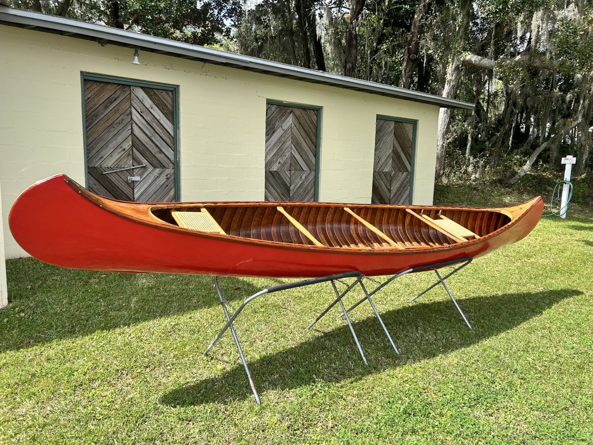

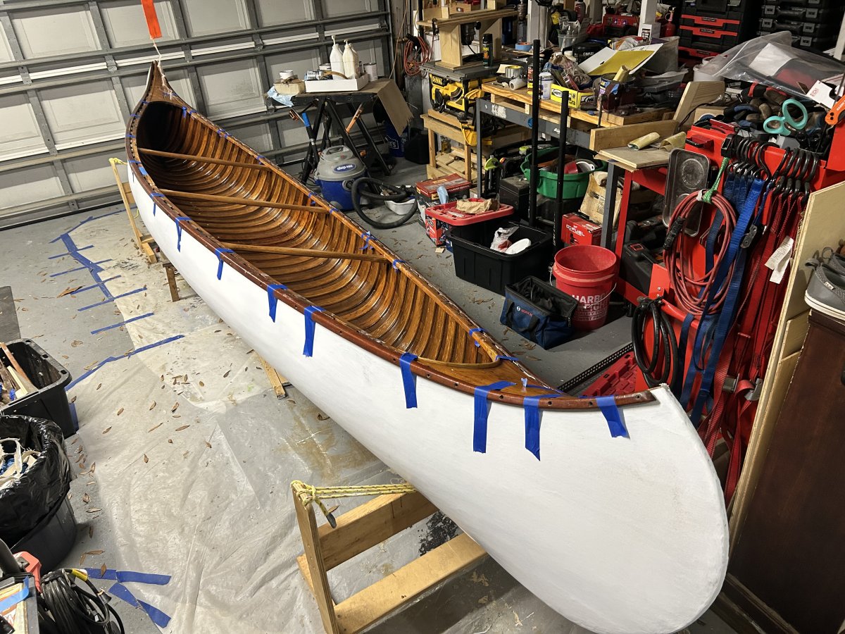

The boat was safely transported back to the club boathouse and has been curing. I’ve received the Old Town water decal from the WCHA store to put on the front deck, and the boat will need a few more coats of varnish on the decks and inwales. The club’s annual annual spring gathering and open house is right around the corner - June 6th, where everyone will have a chance to paddle this piece of history. I’ll be back with some action shots.

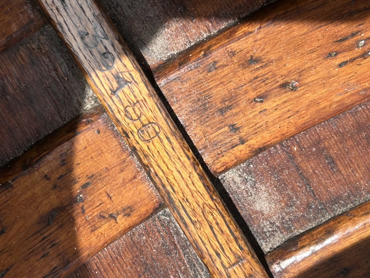

Thanks Worth, original serial numbers on each stem, both bow and stern are original ribs, a lot of original planking. I purposely kept the original inwales, and I’m fairly certain the Mahogony gunnels are OT. So Repaired? Yes, at least 2 major overhauls. Easily spotted, And that in itself adds to the character and legend of a boat like this.

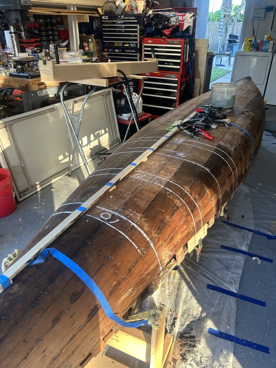

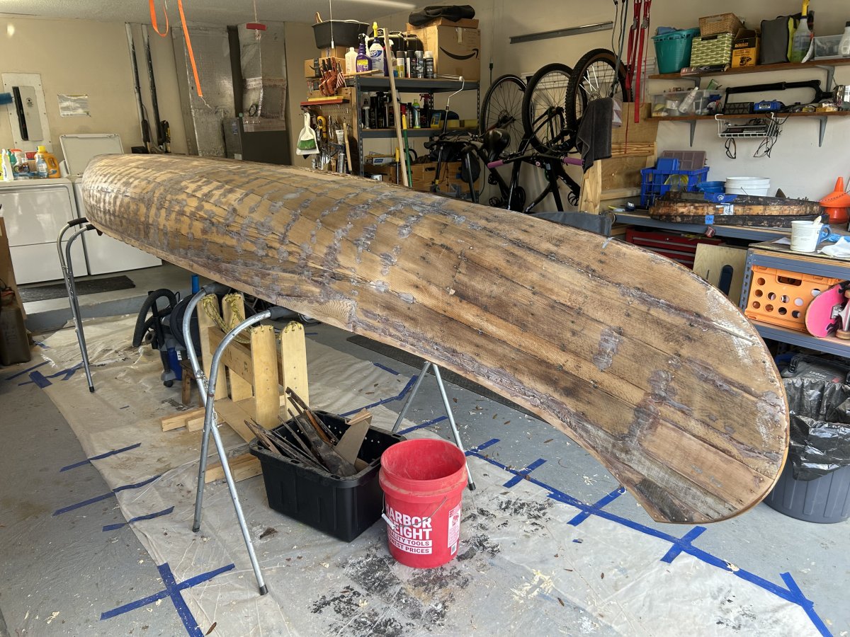

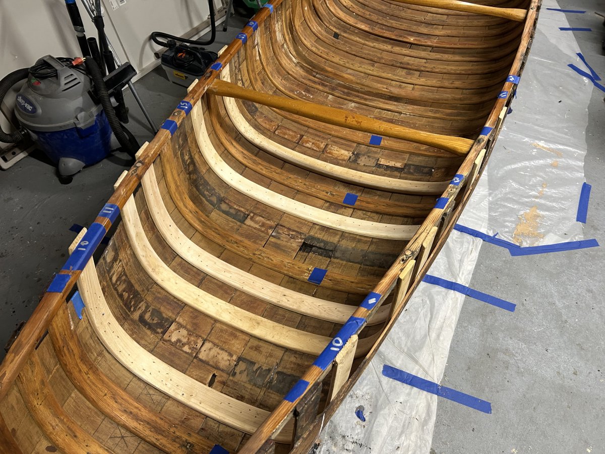

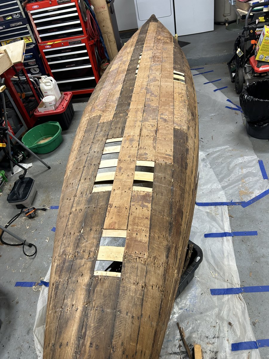

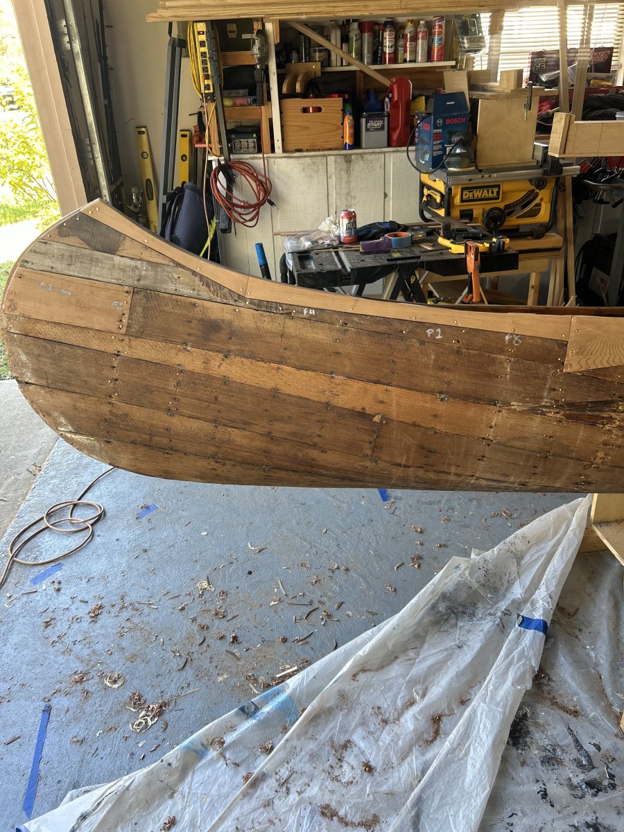

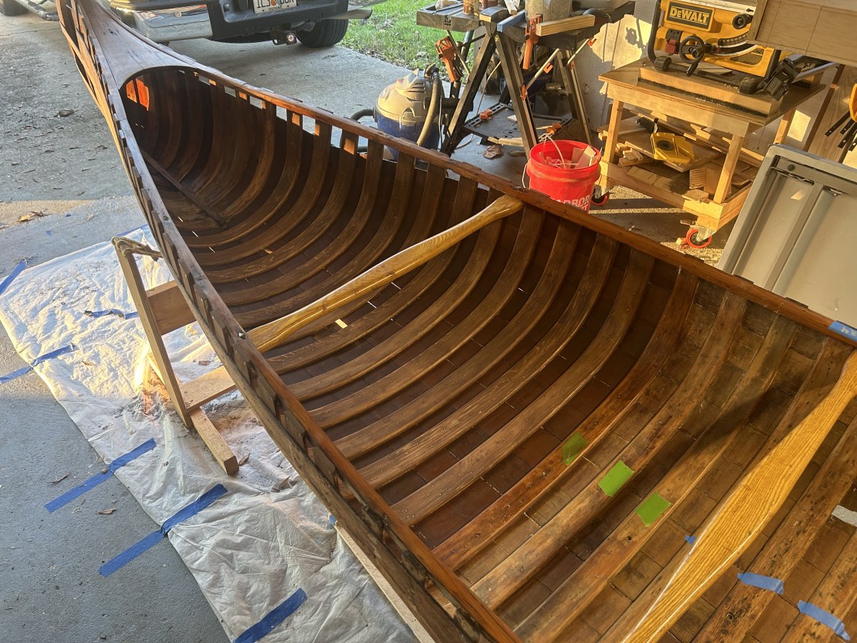

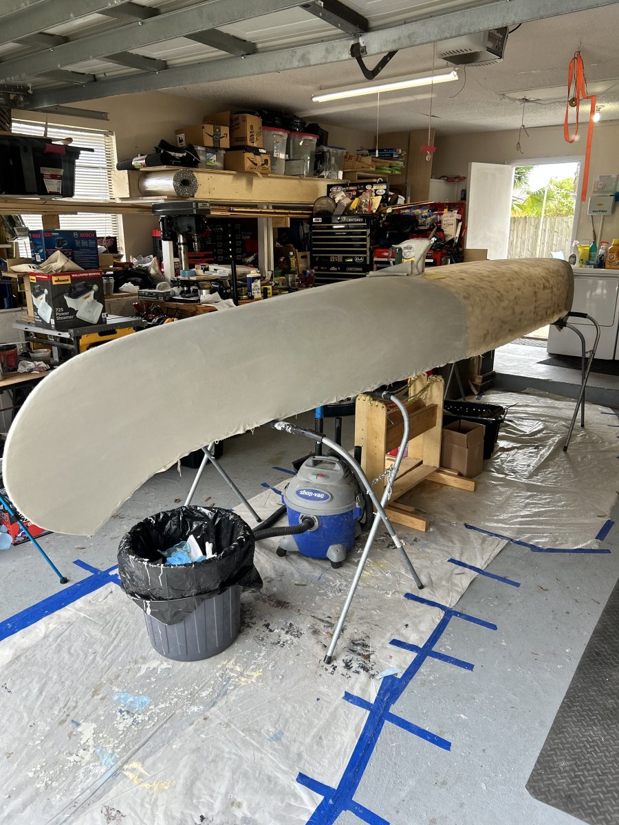

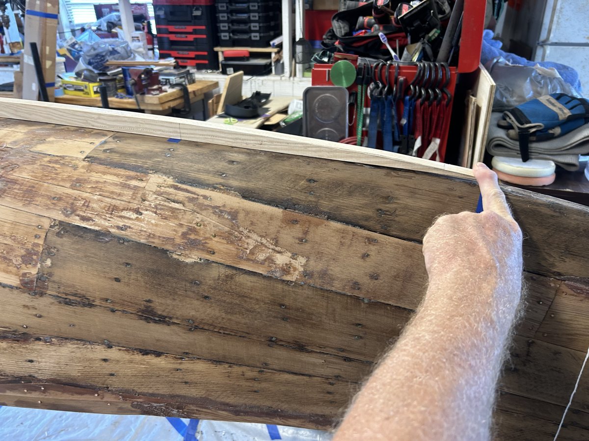

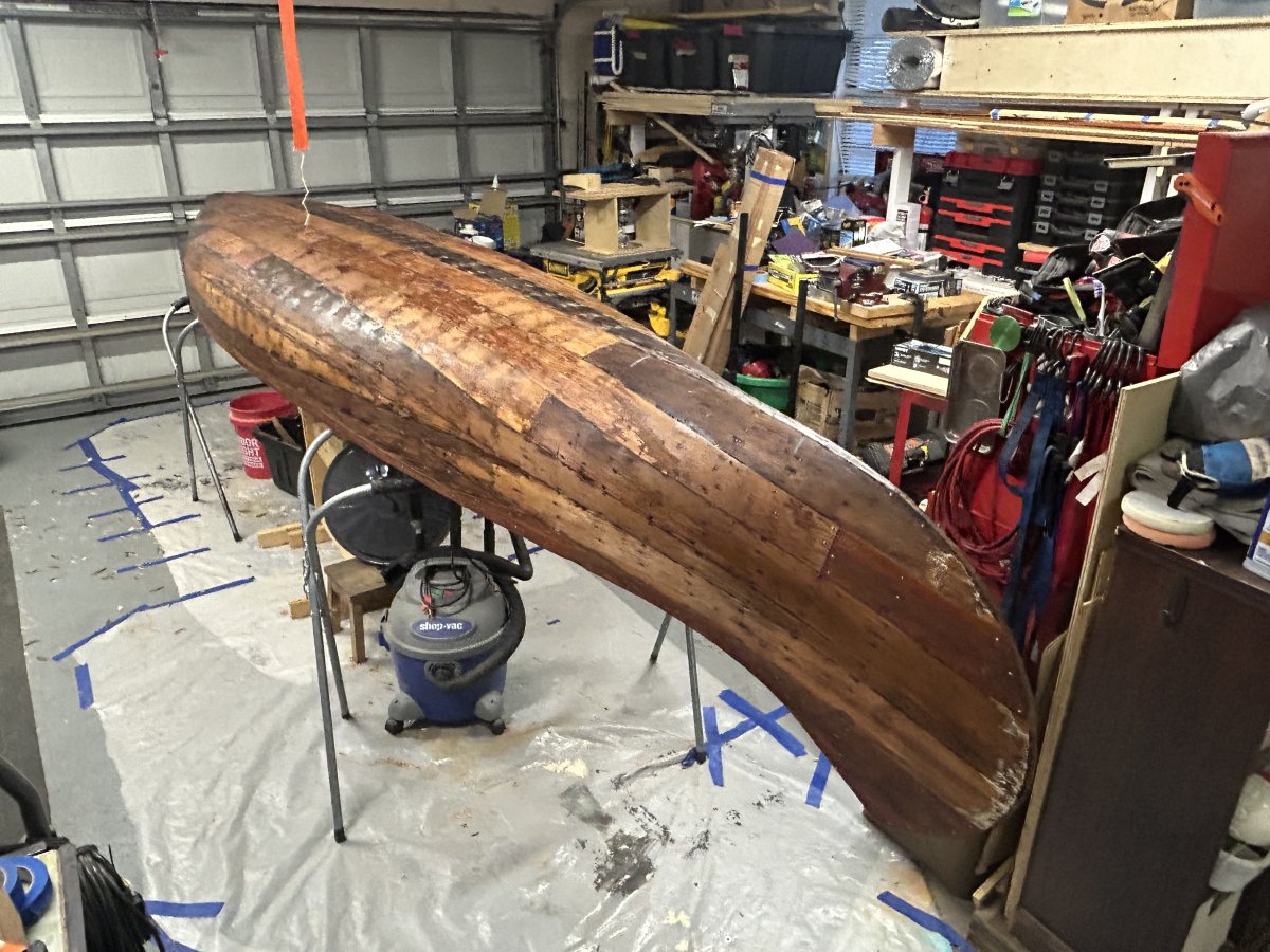

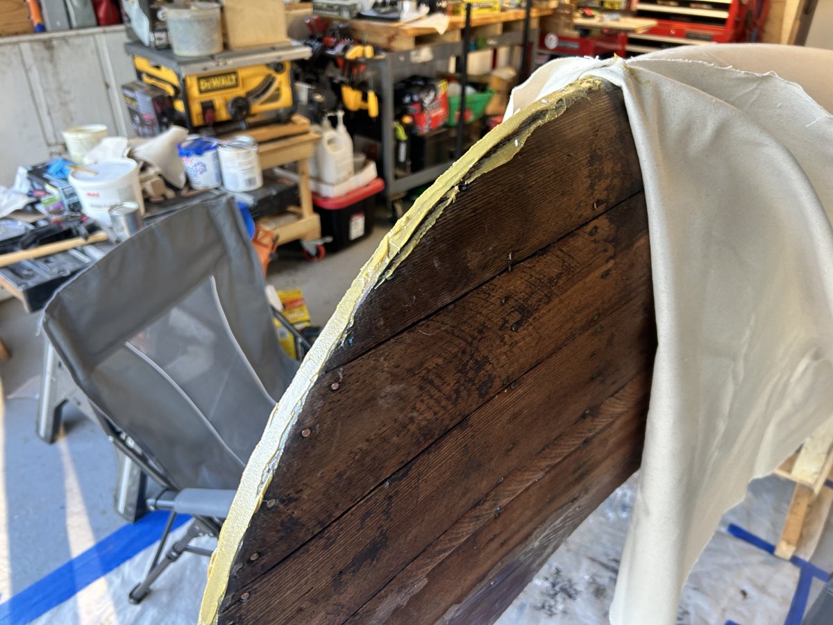

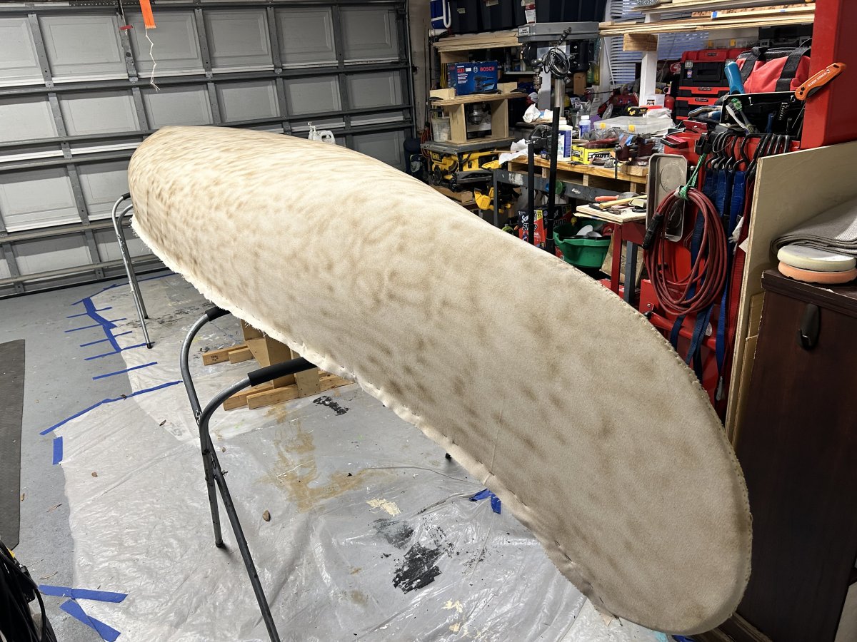

I breezed right by the info on finishing the hull prior to canvas. There were A LOT of tack holes to fill after replacing that many ribs. I also had to deal with some of the fiberglass removal damage that pulled the surface off the planking in a few areas. I also had some gaps between my new planking and the existing hull. I chose to fill these all with epoxy resin thickened with wood flour. Once dry I carefully sanded and planed the repairs down, doing my best to not affect the old planking. The result was pretty good, not great, The hull is stronger and tge imperfections seem appropriate for the age and condition of the boat. Here’s a shot before I put on the boiled linseed oil.
Nicely done. There is a lot of satisfaction from finishing up a restoration.
If you plan to do another, one thing that you might experiment with is leaving all of those tack divots unfilled. You would be amazed at how those disappear when you stretch a canvas over the hull. The temptation to fare and fill is strong, but realistically, only the worst spots tend to need that treatment. when I restore a boat that has had fiberglass installed on it, my last step on the hull is picking out all of the resin that has filled in over the tack heads. I do that for three reasons. One, those tack heads were driven down below the surface of the planking by a skilled builder deliberately. A good clinch does not allow the head to sit proud but it will also not show through the canvas.
Two, resin, fillers etc. in that tack divots tend to pop loose and separate if the hull is dropped, hit, dragged etc. during use. Those little bits would end up between the canvas and the hull.
Finally, and this is a personal thing, looking ahead to the next time the boat is worked on, what a PITA to unseat those tacks if you need to pull planking or replace a rib.
Mike
Thanks Mike. I have considered those things and it’s good you mention them.
Yes, to get the ribs out, I had to pick the resin out of each tack divot to pull the tack.
I did not fill over the new tacks. I filled vacant holes from previous tacks in an attempt to avoid excessive plank replacement. Preservation vs replacement. I did fair the damaged planking where the surface had been removed with the fiberglass. The tack hole divots should not pop out as I had a wet mix that soaked into the surrounding wood and the new rib underneath. We’ll just have to see if it worked.

The boat got its first float yesterday. Happy to report there were no surprises. She’s solid and paddles well. It is ready for the club members to enjoy at our annual spring festival and Open House June 7th.
I still have the OT water decal to apply and I think I’m going to put the club name on it using vinyl.
