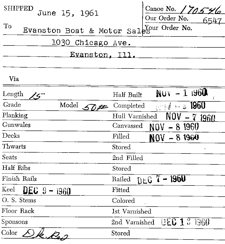

Welcome and congratulations, the Old Town canoes with serial numbers 17054 and 117054 are both 16 feet long so they aren't a good match. The Carleton with number 17054 is 18 and the Kennebec is 17 so those aren't any better. My guess is that you may have the Old Town with serial number 170546. This is a 15 foot long fifty pound model with a keel. It was built between November and December, 1960. The original exterior paint color was dark red. It shipped on June 15th, 1961 to Evanston, Illinois. A scan of this build record can be found below.
It is also possible that you could have another number or manufacturer if this description doesn't match the canoe. The list at https://www.woodencanoe.org/builders-suppliers includes a variety of suppliers for new stem bands. The store at https://www.woodencanoe.org/product-page/old-town-deck-decal-1956-1978 has the deck decals. Pages two and three of the 1961 catalog at https://www.woodencanoe.org/_files/ugd/537308_21a75ca1cddd452fb80d5bd2c384b589.pdf have more details. Feel free to reply here if you have any other questions.
