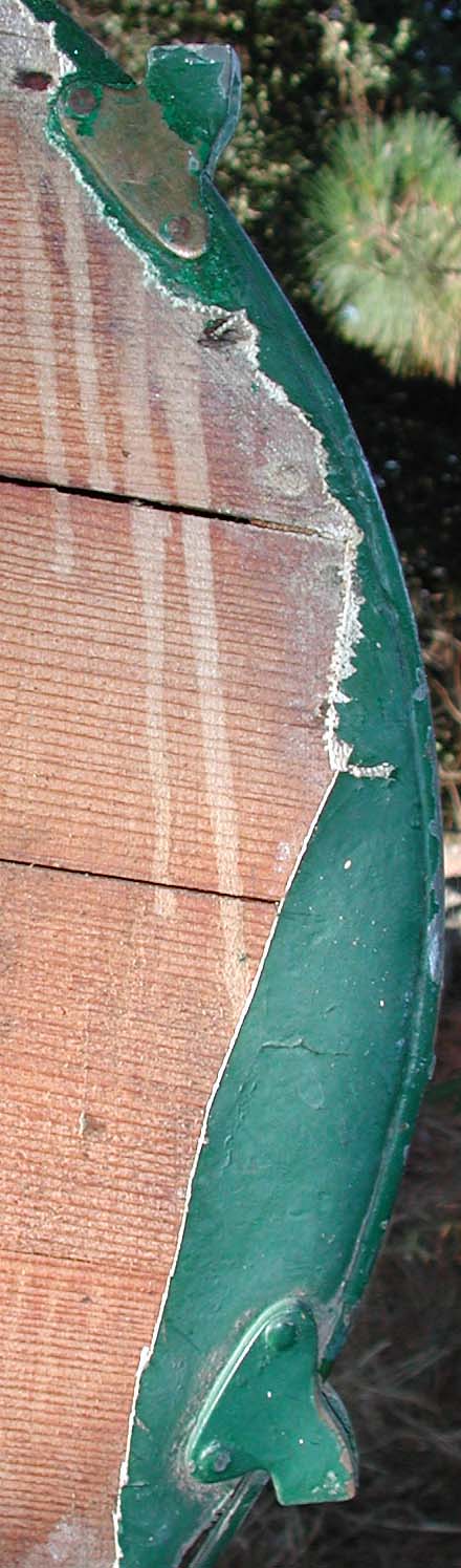

Thanks, Benson. The mast seat has the older, round hole... there's no other sailing accessories with the canoe.
Seller told me the canoe belonged to his brother, whose love for wooden canoes was inspired by Joe Seliga at Camp Widgiwagan. The canoe was restored by the seller's dad and brother.
The photo is really small, but I can't see a mast step at all. The mast seat has a round hole, but that's always been the case, so no help there.
The mast seat holes have always been round as Michael mentioned. The mast step is in the bottom of the canoe under the mast seat but is not visable in the picture you attached. The picture at http://forums.wcha.org/attachment.php?attachmentid=6491&d=1226694223 shows one from 1919 and the information at http://www.dragonflycanoe.com/otacc/ describes this in more detail.
You may also want to see if the stern has bronze rudder gudgeons. The ones shown at http://forums.wcha.org/attachment.php?attachmentid=5223&d=1214851540 are a newer style than the ones that would have been installed in 1915.
