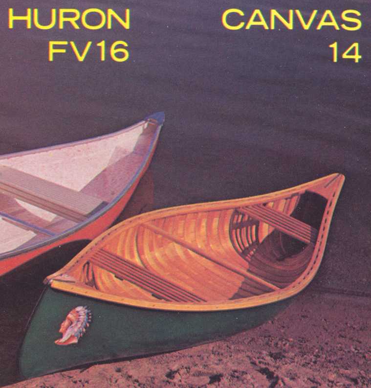

Palmer, congrats on your Peterborough.....the Indian head got me wondering though....could this be one of the 'Peterboroughs' made in Quebec after the Peterborough Canoe Co actually went bankrupt in early 60s....see http://forums.wcha.org/showthread.php?323-What-can-it-be for more. There is some discussion on Indian head decals on bow....see attached photos
But then the Peterborough Canoe Co. decal wouldn't be included on these Quebec 'Peterboroughs'?!?!? If it has serial number that would tell the story. Here is a list of possible Peterborough canoes from www.dragonflycanoe.com. (see Wooden Heritage Identification Guide link):

Jan is right....if it's not a Quebec 'Peterborough' which is not likely from the Peterborough decal (the Indian head decal still poses some questions)....Chestnut did build most of Peterborough wood canvas canoes after formation of Canadian Watercraft Ltd.
