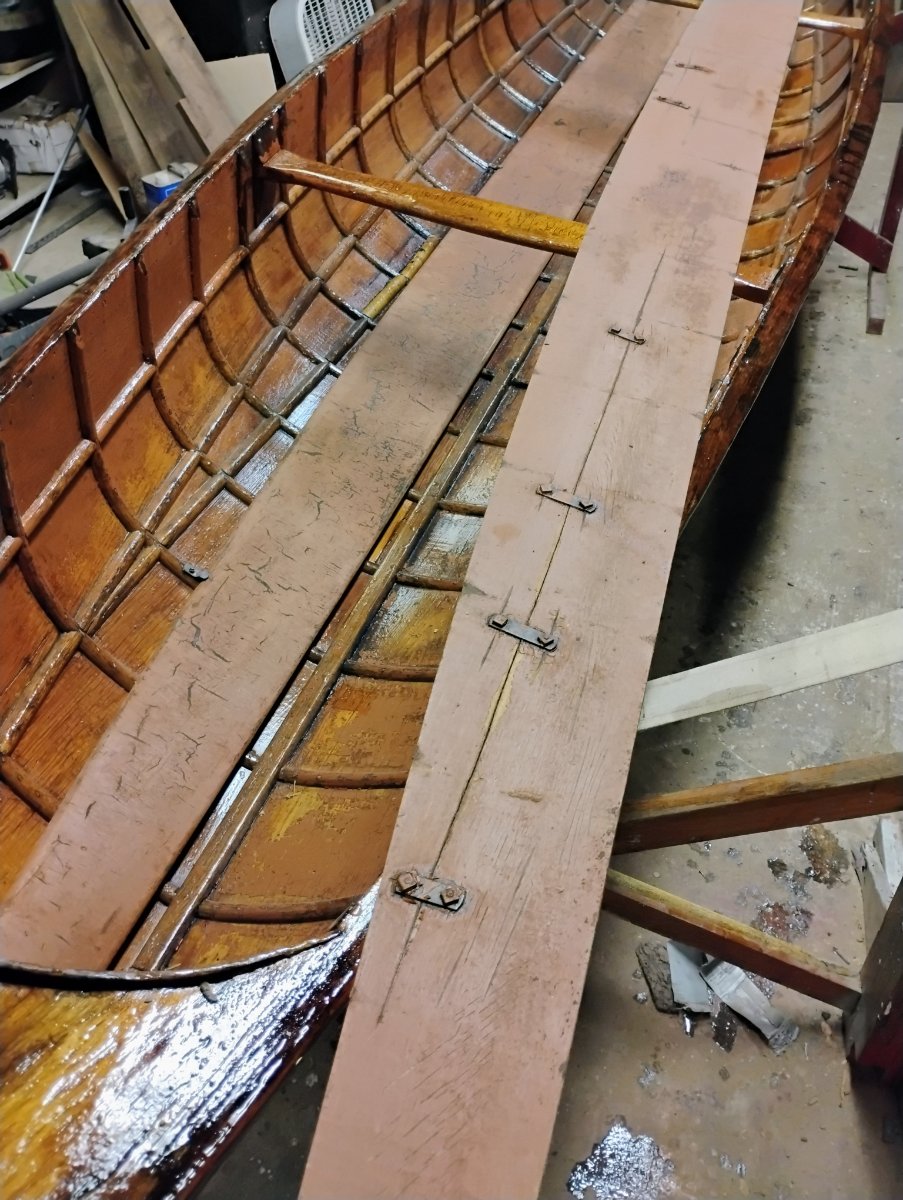

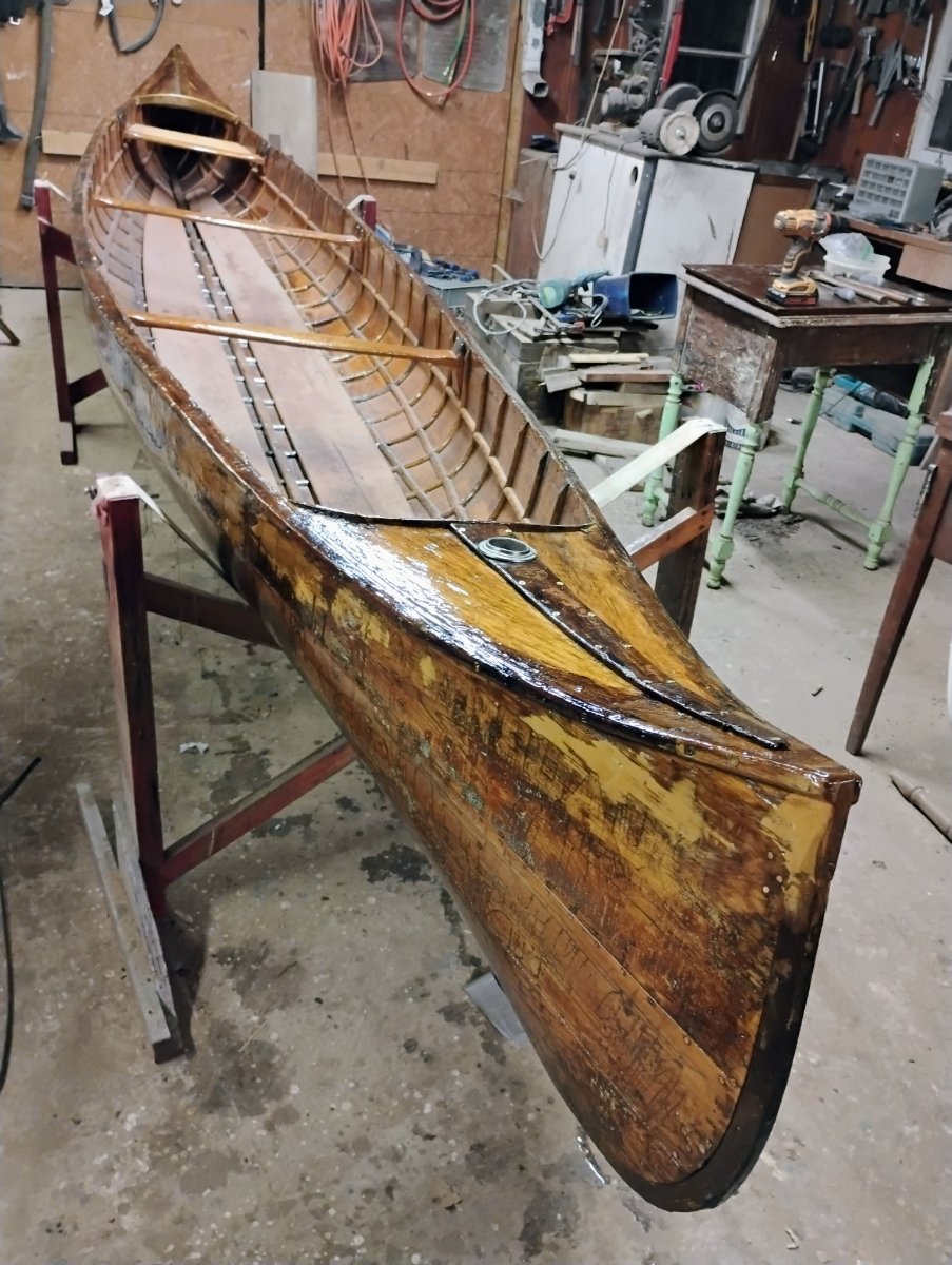

I'm back at work on the W T Bush wide board. I'm creating a new thread for more pictures. I need not apologize further. The intention is to get the canoe in the water. This is my first attempt at rebuilding a wide board. Without the canvas to cover mistakes and possible leaks I've opted to overdo the filler and varnish. Simplicity of rebuild has been my goal. I'm gone a lot from home and need this boat to go north after ice out. I have life problems and when events get bad the canoe is the result.
These basswood wide boards seem to be a transition between birch bark and wood/canvas. I imagine the builders were settling in among old growth timber. Very large trees were common in those early days of European settlement. This "three board" of course is built from local boards from quite large trees. The floor boards are equally wide. One split board and was repaired. I'm not going to refinish the floor boards. They chronical the history of the boat that I've now covered with filler and urethane.
I'm trying to recover the stenciled name. QUINNEDAUG seems to be an older spelling of the native American word for "Long Lake."

Leaked bad , only got few hundred yards before I turned back

Someone who paddles these regularly can answer. Should I soak the canoe few days before going out? I'm sure the wood will expand. Maybe stop leaking??
Mine hasn't been on the water for a few years. It wasn't too bad and was getting better before a winter out of use at which point it leaked badly. I wondered if moving it when it was very dry, flexed it more causing more leaks. It didn't seem to get much better after two days soaking.
Basswood is pretty common around here, Western NY. They grow quite large. There are quite a few enormous ones in a grove that I regularly hunt so large boards off of one of these would not be all that unusual. They wood is very soft and easy to work, has precious little value for much of anything. Hobbyists like it because it is very workable and cheap. The trees seem to rot and fall as they approach their maximum size. I Have to deal with one that is currently down across a stream and another that has dropped across one of my trails. My guess for why it was used it simply that it is so easily workable and that (if you opted to fell it) that it is so easy to get a large board from one.

Yes, This canoe was well gone when I got it 15 years ago. As a learning project it's been great.
I took it outside, put it upright on the sawhorses and started filling it with water. It became quickly obvious where the leak was.
The bottom board is scarfed onto the stem band. Leaking badly. So....I'm not going to remove the board. Maybe pry it up a little and put in bedding compound. Maybe glue it down. Or tip it on end and reach inside to add a lot of paint until the leak is filled.
Any other ideas?
