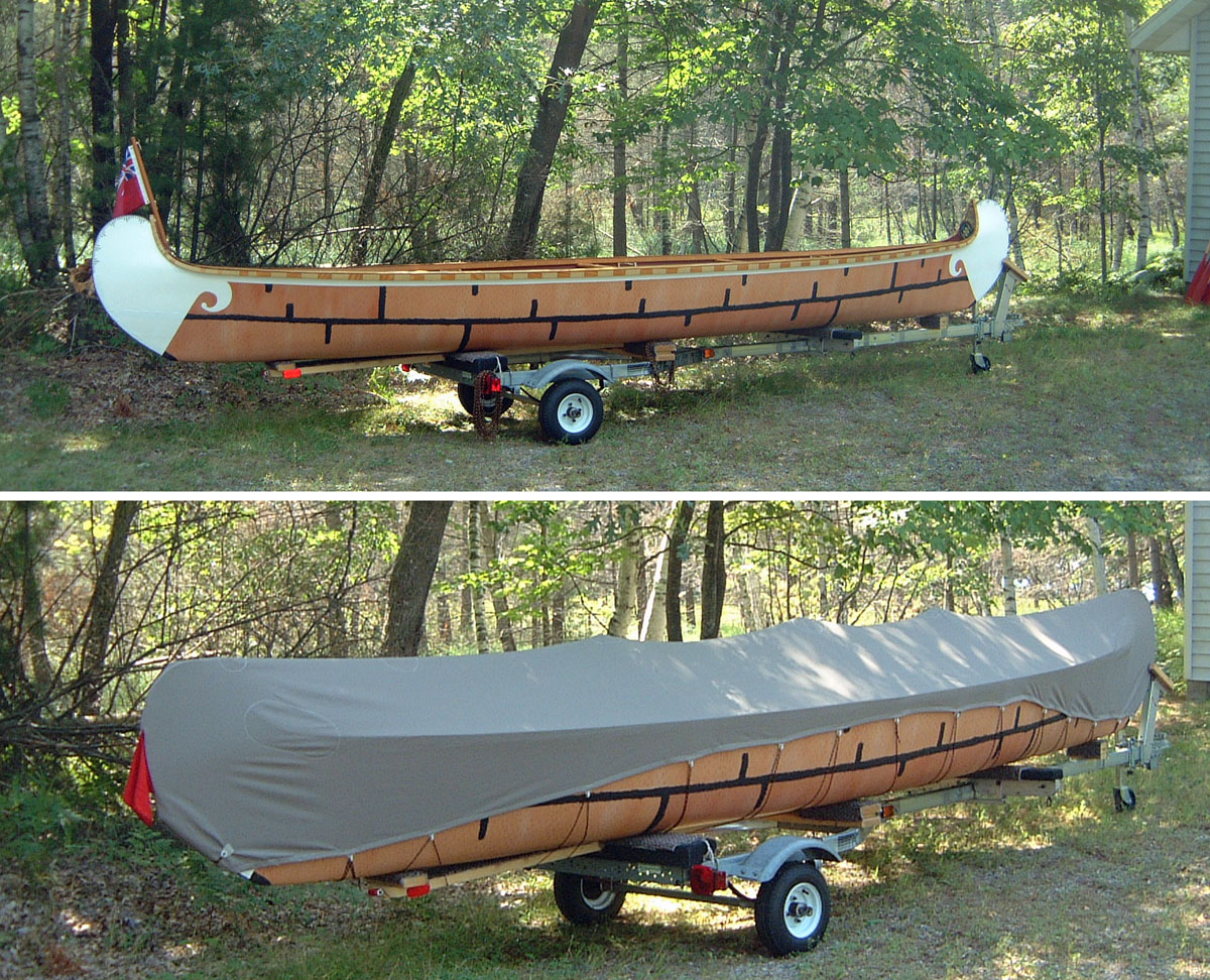

I transport my 22' stripper upright on five very simple carpet-padded bunks. The back one had to be mounted to a lengthwise 2x6 because the boat is longer than the trailer. It's certainly not very sophisticated but used what I had available and has worked fine so far. I built an Odyssey acrylic canvas cover, so that it can't fill with rainwater if I hit bad weather. Since the rib spacing on an Ogilvie is only about 1/2", I can't imagine it being too weak to survive just fine when spread over several padded bunks, and there is no penalty for having more than the typical one or two that most boat trailers come with.

View attachment 56305I transport my 22' stripper upright on five very simple carpet-padded bunks. The back one had to be mounted to a lengthwise 2x6 because the boat is longer than the trailer. It's certainly not very sophisticated but used what I had available and has worked fine so far. I built an Odyssey acrylic canvas cover, so that it can't fill with rainwater if I hit bad weather. Since the rib spacing on an Ogilvie is only about 1/2", I can't imagine it being too weak to survive just fine when spread over several padded bunks, and there is no penalty for having more than the typical one or two that most boat trailers come with.

Todd, the boat is currently up at our lake house, about four hours away, but I can give you the basic rundown for the trailer. I originally bought it for my 11' long, Mini 12 Meter sailboat, a fiberglass keelboat with a hollow keel. To sail it you add 350 lbs. of lead shot bags inside the keel for ballast. It was the smallest Karavan boat trailer and actually made for trailering a single jet ski. I took the bunks off and made new ones for the little keelboat. After a few years I sold the boat, but the buyer didn't need the trailer.
So, when I needed to move the big canoe, I started by splicing a longer tube onto the tongue. The main bunks were just padded 2x6 lumber bolted crosswise to the frame. Those nearest the stems were very narrow, as the hull is and the second one aft of the bow was attached to the tongue with an old Holsclaw crosswise bolt-on bracket which holds a board on edge, topped with a padded 2x6. The lengthwise hunk of 2x6 hanging off the back end was put there to hold the stern stem's padded support as well as clearance lights. Not fancy, but it works, and you really get lots of thumbs up driving down the road towing this canoe. Unfortunately, I'm getting too old to mess with it, especially after two open heart surgeries in the past ten years. Someone will eventually buy it with the trailer - or if not - I'll re-purpose the trailer once more. Does anyone make a wood and canvas jet ski? :)
