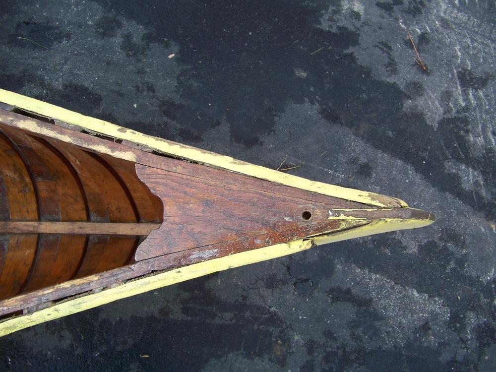

I'm in the middle of restoring a 15' Old Town 50 Pounder from 1945. This canoe has a very short deck - about 10" long - and only attached to the first two half ribs whose ends are tapered to virtually nothing. I'm concerned that the deck is just not anchored to the ribs too well. Seems to me that when you hold the canoe by the deck all the canoe's weight is being supported by the rail located between the 2nd and 3rd half rib.
So I'm thinking of adding carry thwarts. Of course the problem with carry thwarts is that adding the bolt hole weakens the rails. I'd use #10 screws to lessen the damage, but still...
So I'm looking for advice. Add carry thwarts?, or not?

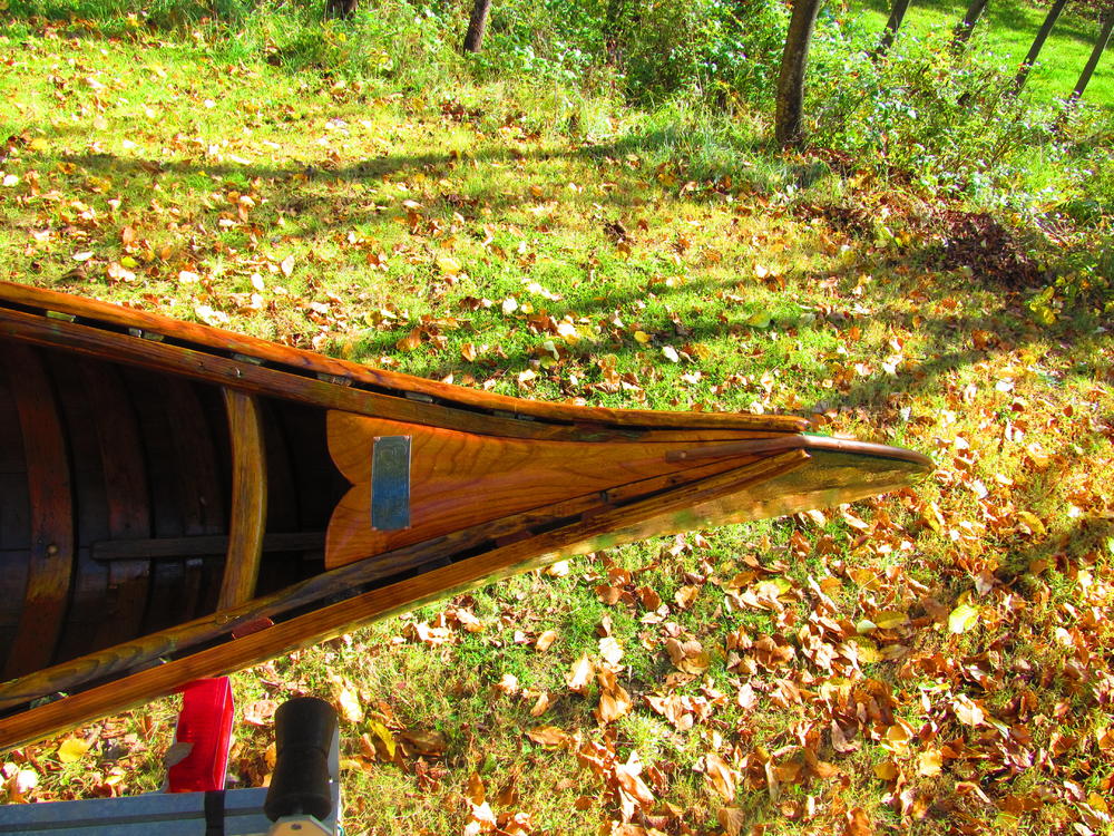

Ok... I think I'm convinced it's the right thing to do. And I'll use #8s. I sold a Carleton a few years back that had a carry thwart (a single one at the bow) and an OT CW that originally had sponsons that had 'em as well. Wish now I traced then so I could replicate. Especially the Carleton's - it had a very soft 'C' shape to it - see pic. Thanks for taking the time to reply guys.

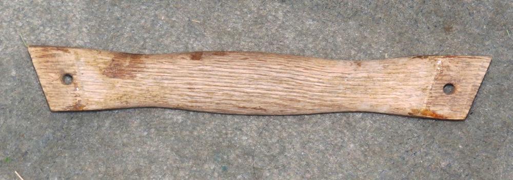

I have carry thwarts from a 17' OT HW that are, at the moment, out of the canoe. I just put one on the copy screen of my computer's printer copier; the copies (top and bottom) could serve as full size templates. Not the nice "C" shape of the Carlton -- just a nice standard-shaped small thwart. Send me a PM with your address and I'll send them off to you, if you wish.

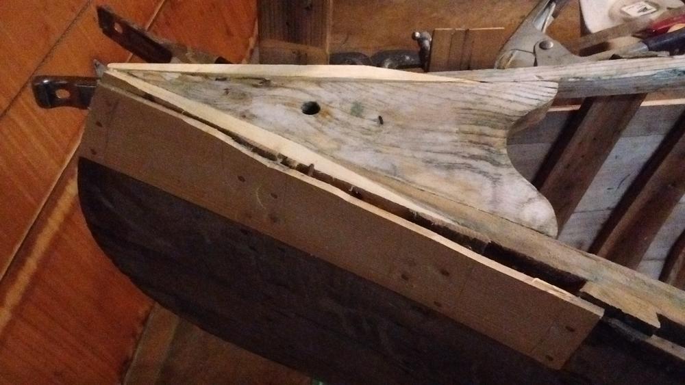

I have a 15' 50 pounder. As on your canoe, a previous owner did me the "favor" of drilling a 1/2" hole in each deck (even nicely placing one slightly off-center, adding a certain asymmetrical je ne sais quoi to that deck), which provide me with an attachment point for a painter or tie down. I tie a small loop of light rope through the holes, to which I can tie a painter or tie-down. In several seasons of use, I never felt that the deck, fastened by screws through the inwales as Fitz describes, was weakly or insecurely attached. I have found the decks quite sturdy when using them to carry the canoe, or when attaching a line for a painter or car-topping tie-down.
That said, I am in the process of restoring the canoe, and I may add small carry thwarts. The small loops of rope are not terribly attractive and are inconvenient to remove and re-install. So if I do add carry thwarts, it will largely be for appearance and convenience, not because I think the decks are too fragile.

And... I'm amazed that you use the decks as an anchor point to help hold the canoe in place while atop a car! I'd be afraid the deck would be yanked right off! Obviously not though - you prove that. So let me think... The deck on the 15' 50 Pounder is attached to the inwales which are in turn nailed to the rib tips. But the side of each deck spans only two half ribs which are tapered down to nothing by the time they reach the deck - ring nails would pull right through them given a good tug. The first full width rib meets the inwale 2" to 3" away from the first screw holding the deck in place - not a very secure scheme engineering wise. BUT what I haven't considered is that the outwales also span this area, and they have nice big screws that go deep into the deck. So, I'm thinking the strength of the design comes from the outwales. First they re-enforce the inwales and provide extra strength, plus the screw passing through the thin half ribs cause the rib to be squeezed against the deck so that they can also add some holding power. So the moral is: be kind to your outwales!
By the way... Sometimes the hole in the deck were put in by the manufacturer. They were used to hold a short flag or pennant pole. I'm thinking that's the case with my canoe. Maybe not your though - the hole seems too close to the tip.

The images I have of the thwart are photos, which do not print out at the actual size of the thwart. I am in Maine at the moment, but will be returning to NYC where I can scan the thwart in a day or two -- the scanned image may print out true to size. Otherwise, what I have are copies of the thwart made by placing the thwart on the copier glass -- and they are true to size, but exist only on paper.
Greg - The more I think on it I think I'll make something like the Carleton's rather than Old Town's. So please don't bother. Thanks again for the offer though.

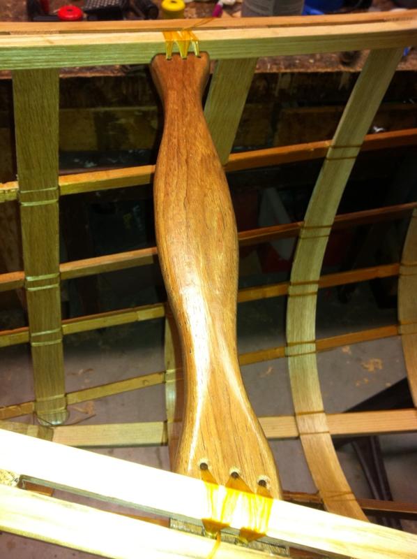

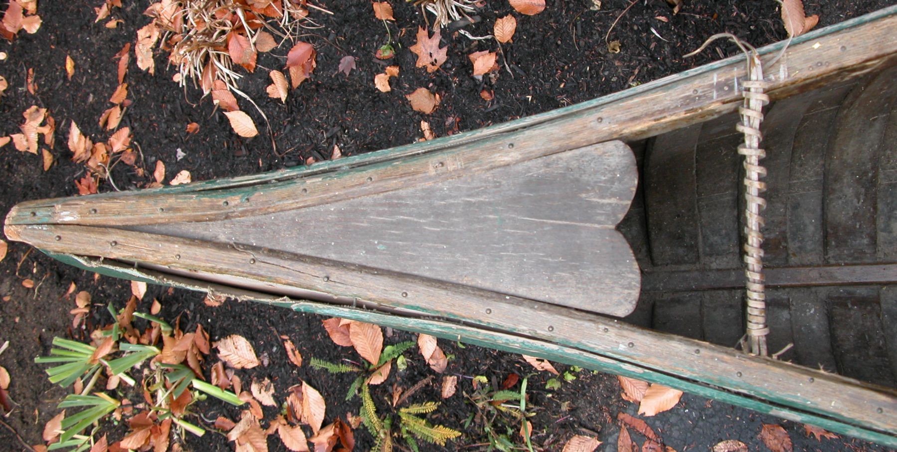

I ad carry thwarts of parachute cord lashed and woven similar to Benson's photo of the cane thwart. No holes, no added weight, works on open gunnels only.
Ya know, I'm starting to like the idea. I could carve out a Carleton-like shape and lash it in place without any holes in the rails. I have to think on it...
IMG_3126.jpgI made a skin on frame canoe once and lashed the thwarts to the rails with artificial sinew... Just a thought.IMG_3092.jpg

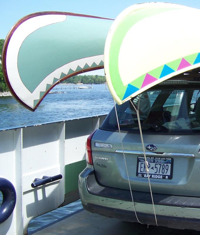

I've created a kind of harness, for canoes with no good attachment points at the end. Tie one end of the harness to the seat, wrap it over the hull, then underneath, running it forward so it gets close to the end, then over & back to the other end of the seat. Kind of hard to explain, but the goal is to stabilize the leading end of the canoe against the torque imposed by highway speed winds. Keep that in mind while rigging it, and it'll work.
