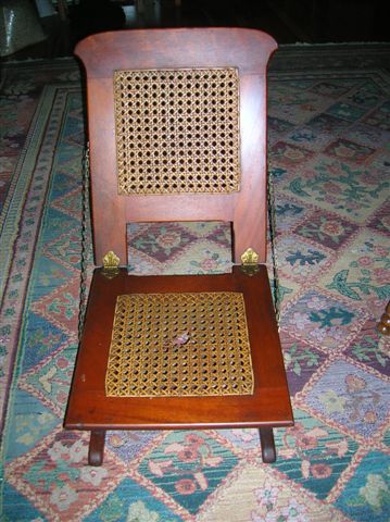

I did some digging around the old posts and saw something so simple and yet elegant too. I think this is perfect for this boat. A wood frame back hinged to the seat with chains anchored to the seat frame for support. I will probably use paracord or some 3 braid, but that gave me the idea I needed. Just need to learn to lace wicker or maybe cheat and use something else.
Here was what I saw, a canoe chair. Overkill for my purposes but I can use the idea and scale it down to make a simple folding back attached the seat.

The seat you show was, I believe, intended primarily for passengers, and is designed to be placed on the bottom of the boat. It was sold by Morris and other builders in the early part of the 20th century.
But attaching such a back to a seat placed at a reasonable height, supported by paracord (or perhaps something less stretchy) should work.

The canoe chair posted by Kudzu looks pretty darn familiar.... the rug does too... although Denis gave the rug to his daughter when we were afraid our puppy Bertie would piddle on it.
The chair is a Morris and is mahogany... Kennebec offered the same chair. Works nicely in the middle of our canoe that's missing its middle thwart. We'll probably take it to the Assembly, along with the other type that rests against the thwart and a couple non-Morris that may be for sale.
Kathy
Well thank you Kathryn for posting the photo. It gave me a simple idea to resolve my quandary. I am in your debt. :) But just a little!
