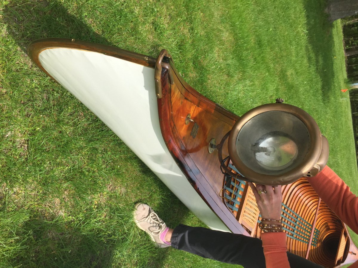

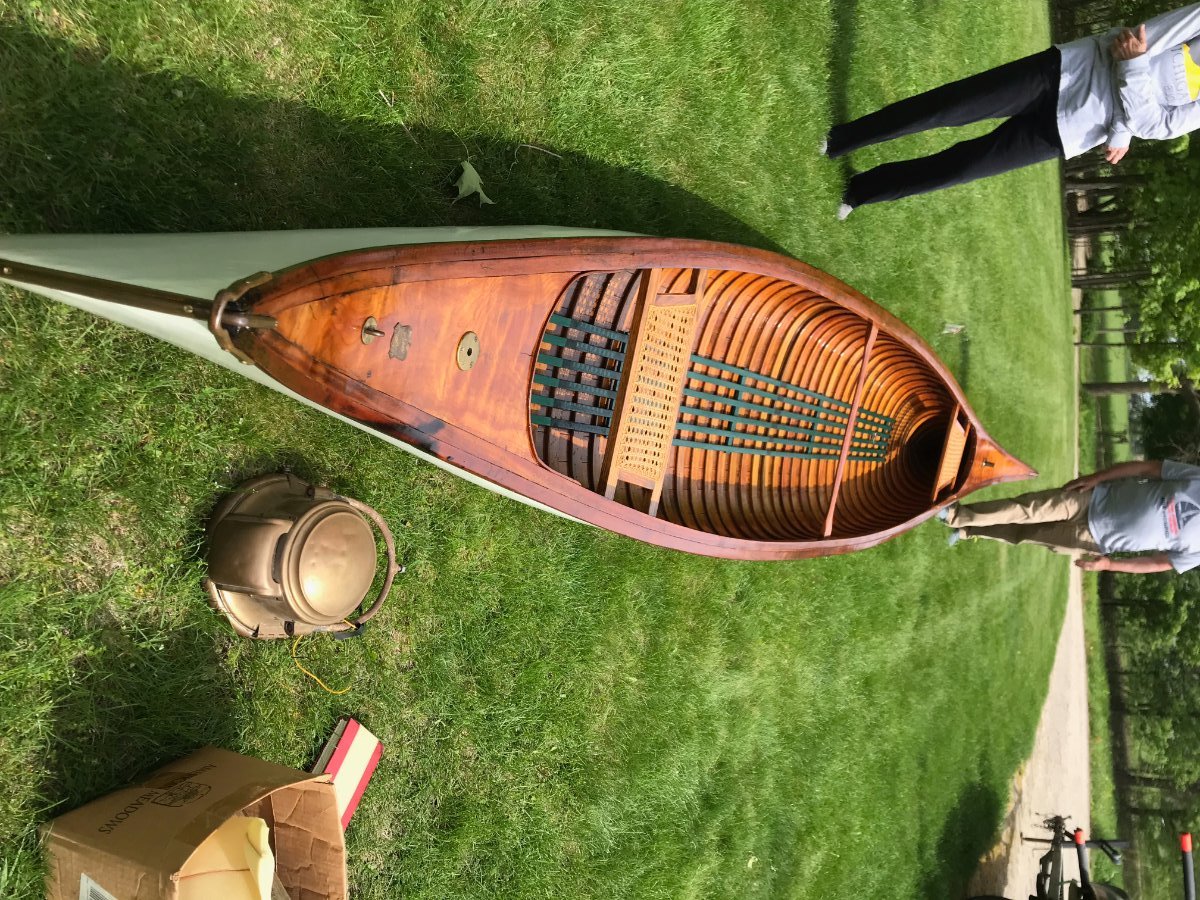

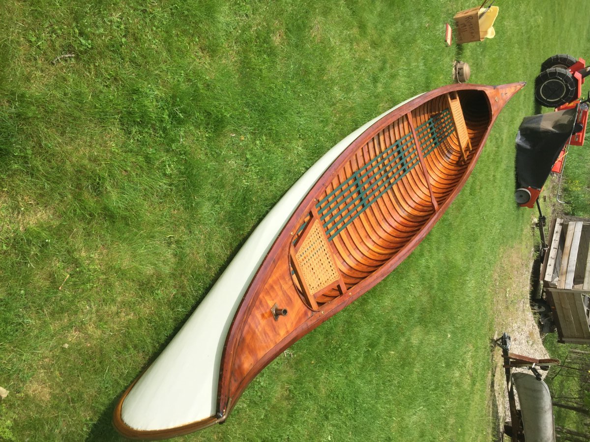

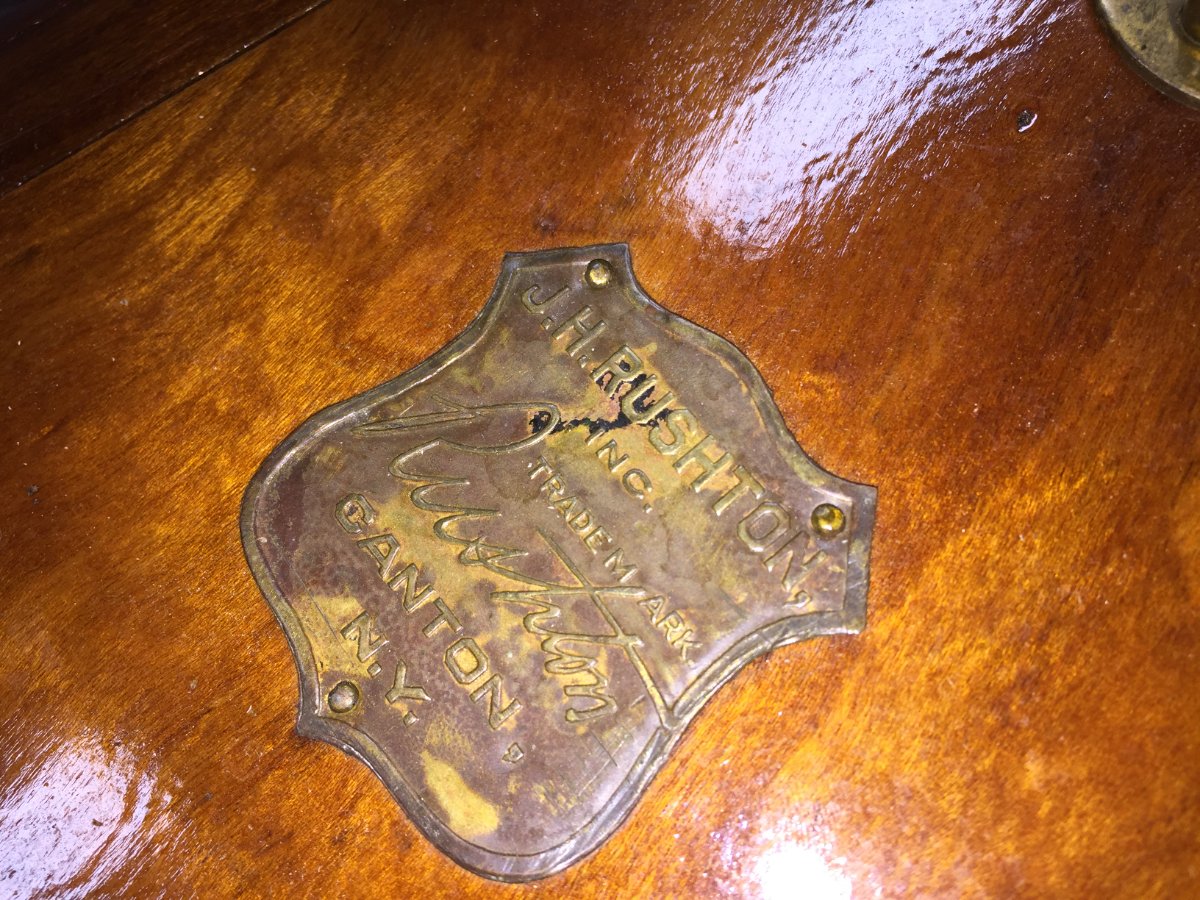

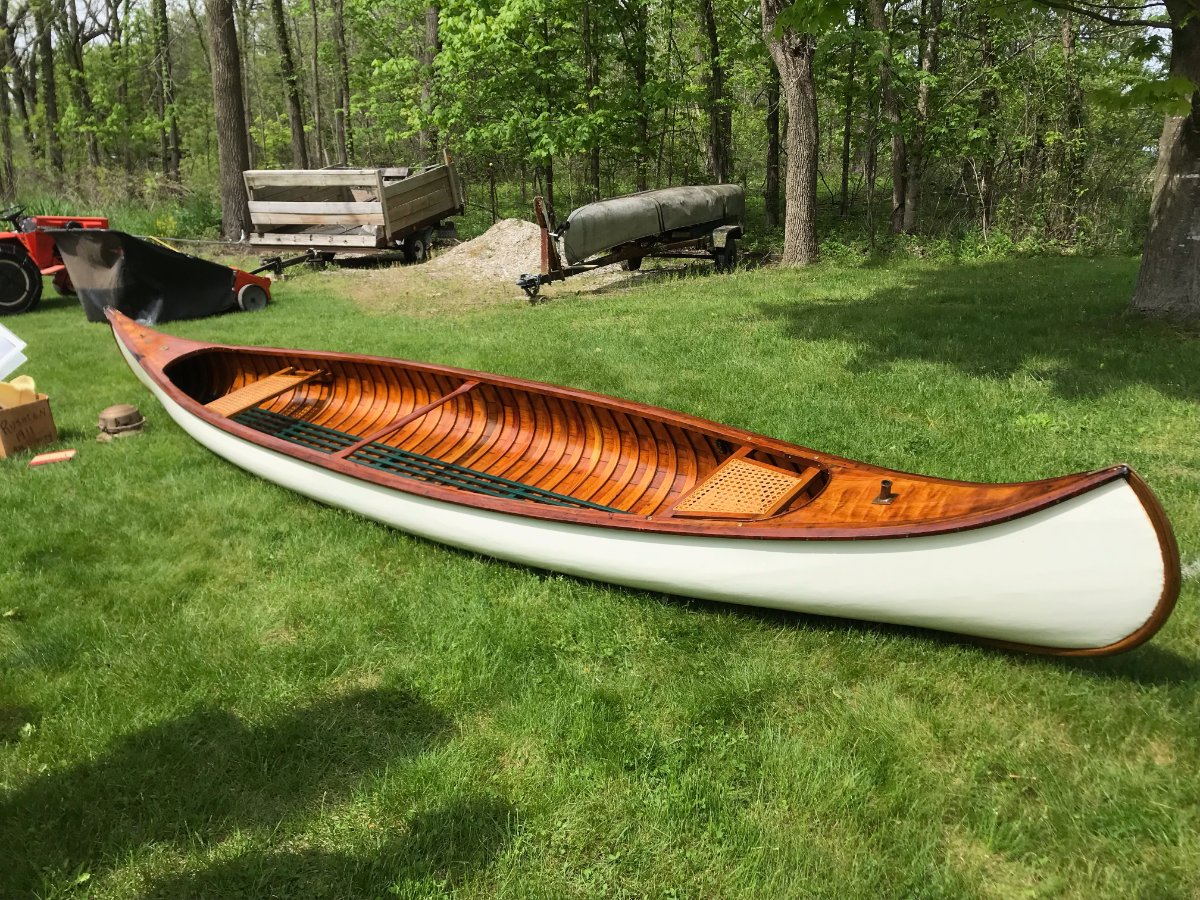

Looking for some input. I bought this canoe a couple years ago sight unseen. I was told it was an American Beauty, one of only two known to exist. It came with written testimonies from very reputable people all saying it is indeed an American Beauty. It was a special order 18'. It only has 21" ends ( same as a Indian Girl) not 24". Opinions?

I would think the 24' deep stems would be a qualifying feature, but maybe not. The other feature of the American Beauty that you should be able to easily discern is that the AB of a particular length was built on the of the next size smaller, and the stems stretch by five inches. This would affect the waterlines at the bows, and should be noticable when compared to a standard Indian Girl. If it wasn't stretched, then I would guess it is a special order IG with American Beauty-like decks.
What is the serial number? Given that it has the Inc. tag, it would have been built post-1905.

Whatever it is, it is a very nice looking canoe. The long cherry decks really trim one of these out. What I find fascinating is how well fitted these large cherry decks are and also that they seem to have been largely custom fitted. When I was making forms to make cowlings, I assumed that I would make one and that would do the trick. What I learned as I made the second form is that someone had shaped two entirely different radius so that the decks could properly span between the rails. To the eye, this was not evident at all.
I have also run across what was I was certain was an American Beauty. Dan kindly took me off the ceiling. The one in Clayton is one I am certain of, sadly, not mine, but a beautiful canoe regardless. You should take a drive up there to look it over. It might hold some clues.
Without asking specifically who the appraisers were/was, I will say that I have found that there are a number of identifications/appraisals done in New York state that I learned are probably wrong. One of them involved a boat that I own and others were boats I found for sale that had been appraised by folks who were shy of the mark. Most of the ones I have seen that were wrong date back (the appraisals) to the 70's/80's.
Yes, a very nice canoe! The catalog page that Dan posted notes at the bottom that the canoe can be had with a cherry floor grate rather than half ribs for a $5.00 savings. And, Good Lord, that is a massive bobstay on the bow of that canoe!
