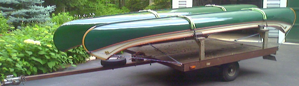

I'll second this. I made tubes from an old Polartec blanket to serve as anti-chafe on the mahogany gunwales of my 15' Barbour runabout. I use 2" wide ratchet straps to secure the boat onto a trailer.
