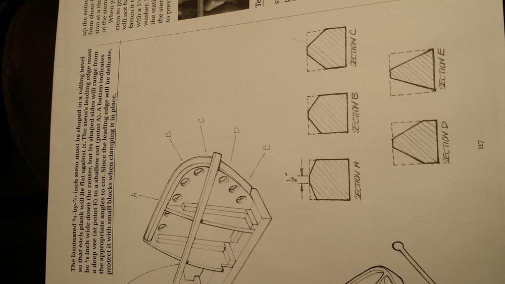

Seems I may have made a critical error in shaping the stem at both ends. Referencing the attached photo of Canoecraft pp 117, I failed to shape the stem at points "D" and "C" as suggested in the illustration. Instead, I shaped the stem in the very narrow shape of Section "E", and as a result, when trying to fit the upper planks onto the stem at the higher points, the plank is being twisted to some extent. Not a severe twist, but a twist nonetheless. My questions are:
1. Is some degree of plank twisting ok? If yes, then how much is too much?
2. If the answer to #1 above is no, then how should I go about correcting the stem shaping so that Sections D and C are in the right place?
Thanks for any advice you can provide.
