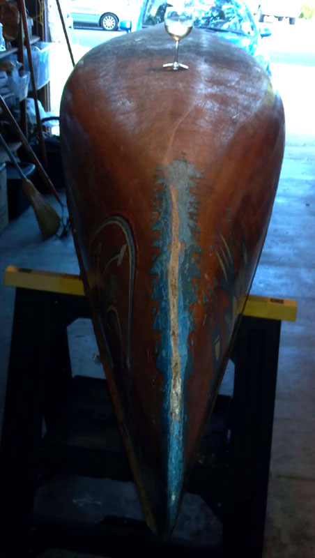

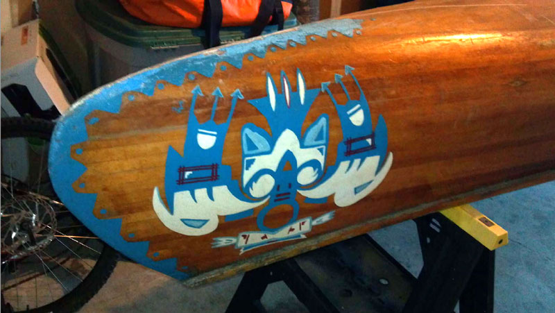

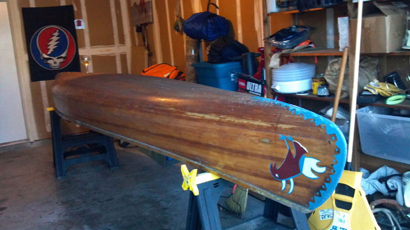

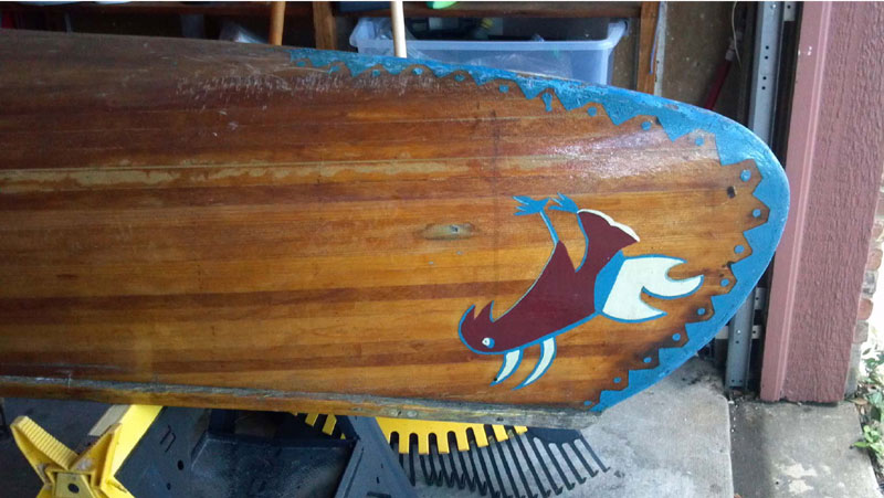

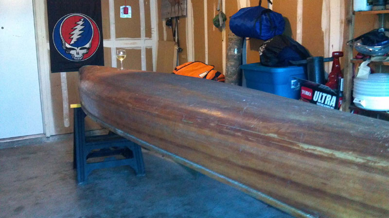

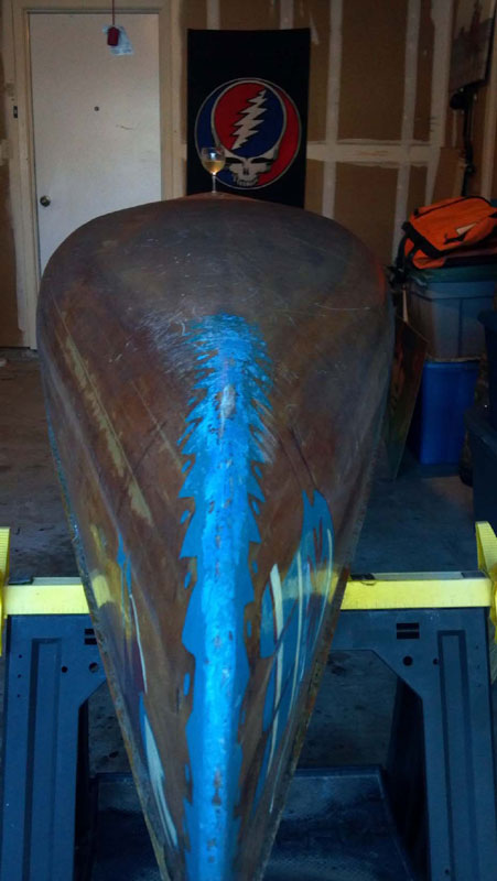

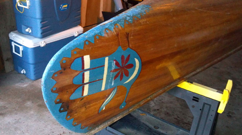

Here's some pictures after we moved it into a garage.
Don't have any of the inside, but you can see the gunwale conditions.

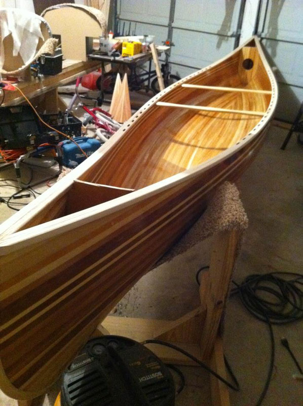

Here's a picture of the new one, just before it was finished.
white guide 4.jpegGreat pictures. Is the new canoe a EM White design? That was the first stripper I built and still our favorite canoe. Pete
Yes, it's based on that design.
We figured we go big with our first one as we were wanting an expedition boat that could handle a child and dog in it as well. What's the weight on yours? Ours came in a bit heavier than we were hoping, about 74, but it's a huge canoe so not completely unexpected. Much of that weight can probably be attributed to us having no clue at the time on how to properly epoxy, so there's got to be a few pounds extra on it from that alone.
You're gonna need a lot more wine.. Actually doesnt look too bad, hull wise. Please update us as it progresses.
