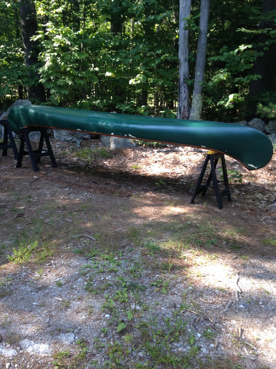

I have a 1919 Old Town Charles River model that needs to be painted. I'd like to keep the green color. I would like to know what kind of paint to use and where to get it. Another option would be to find someone in southern NH to paint it for me.

I'd like to keep the green color. I would like to know what kind of paint to use and where to get it. View attachment 38751

Although Kirby may give you the best color match I have personally found the Kirby paint to be very fussy to use and have had much better success with other brands.
I have been very happy with Epifanes but I have also had good results with Interlux and Pettit. Some folks have gone as far as using oil based porch or roofing paints....
There are a few tricks to painting a canoe but the most important detail is preparation. Your hull appears to be shedding paint down to the filler...that suggest a need for some very careful sanding before you paint. It's hard to tell if the filler is failing...if it is, it may take a bit more than a coat of paint to get things sorted.
If you search this site there have quite few threads about saving an old canvas...here is a cut and paste of a reply Greg Nolan made regarding a canoe that needed some paint....he includes some very helpful links and also references some helpful literature:

If you want to use the canoe after just painting, here are some links to some discussions in these forums about painting over old cracked or chipped paint when you want the paint to last only a season or three or five before re-canvasing:

My yellow Old Town 50 pounder (seen in some of the links above) saw 5 seasons of use with old canvas, chipped filler, crackly paint, and a few unrepaired cracked ribs and planks, for just a few hours of necessary work -- light sanding, spot priming, painting with water-based deck and porch paint (and a few more hours just messing around with unnecessary painting of triangle designs) -- I didn't have the time to restore the canoe without losing a season of paddling. Now retired (and having another canoe to paddle) it’s undergoing a full restoration.
Wood/canvas canoes are pretty durable, and they are meant to be used. Have fun with your new old canoe -- paddle it and take care of it."
