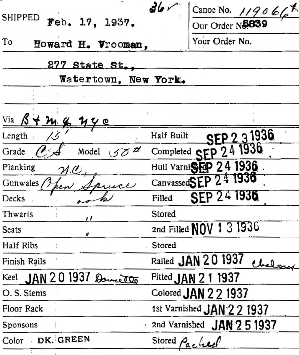

Welcome, the Old Town canoe with serial number 119066 is a 15 foot long, CS (common sense or middle) grade, fifty pound model with red Western cedar planking, open spruce gunwales, oak decks, oak thwarts, oak seats, and a keel. It was built between September, 1936 and January, 1937. The original exterior paint color was dark green. It shipped on February 17th, 1937 to Watertown, New York. A scan of this build record can be found by following the link at the attached thumbnail image below.
