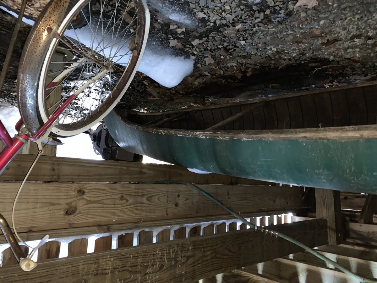

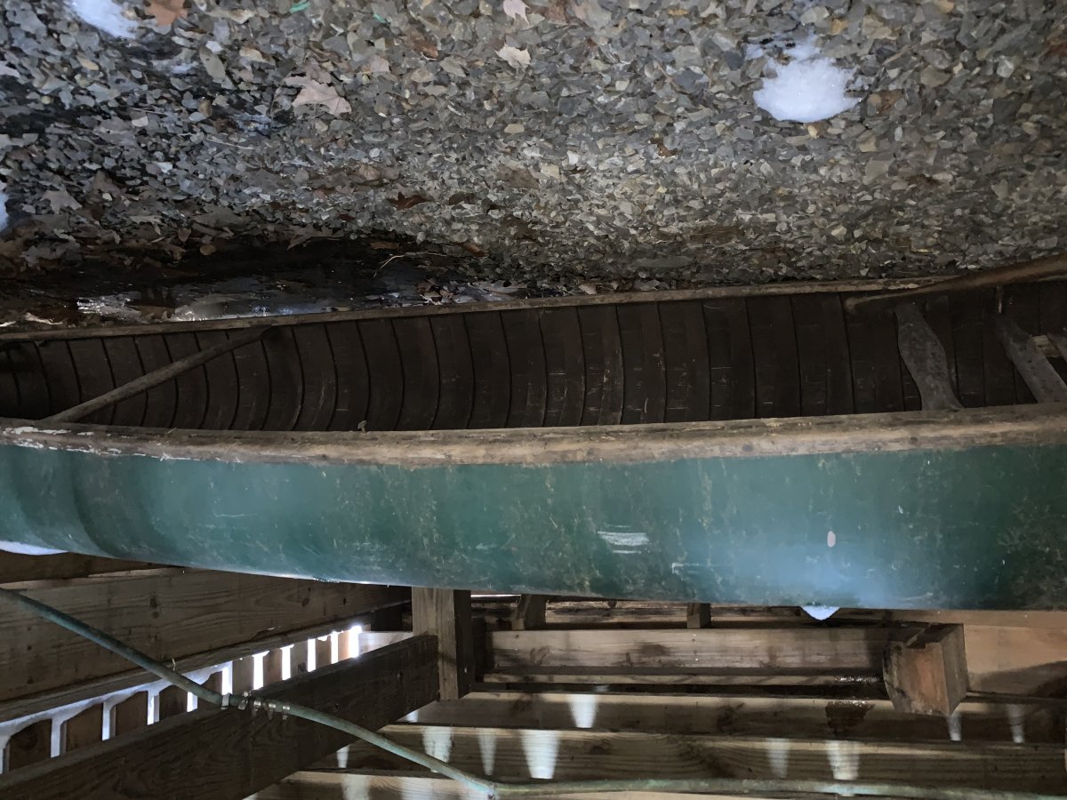

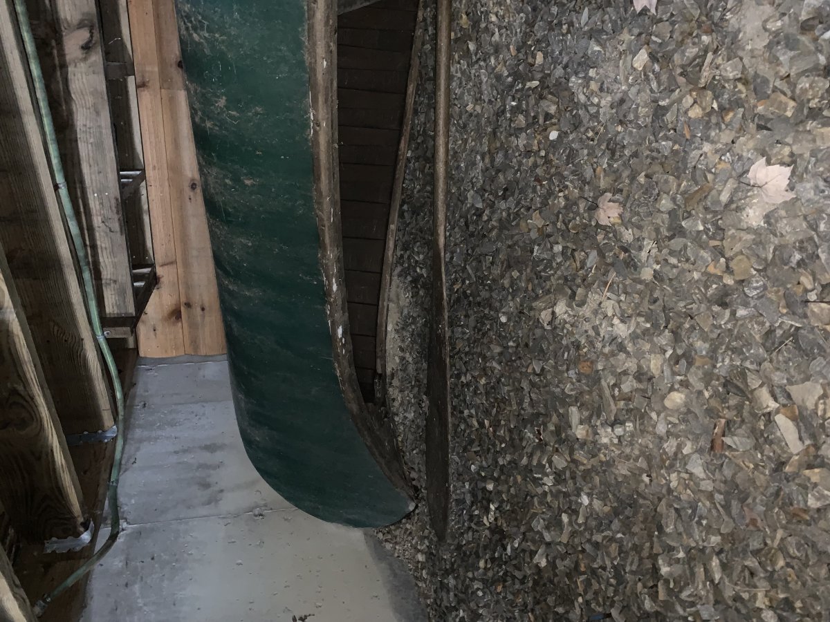

Hello everyone! A friend of mine has offered me a new canoe, well a new project for me. It would be my first canoe restoration and it has me excited. I don’t know what the boat is or have any information other than these few pictures. That is what brought me to this awesome forum, I can not figure out what exactly it is.
So my questions are pretty simple, what do you think it is?? I could have the boat in my possession this week, so I would have measurements and hopefully some markings.
My concern, however; is that this boat is not worth it... that feels wrong to say. Is there such a thing as boat that is not worth the time? Something that was never built well in the first place?
Thank you for your thoughts and hopefully some knowledge!

Your friend's canoe appears to be very restoration-worthy! It looks like a 17'-long Old Town from the WWII era. The photos don't provide much detail but it will probably need a significant restoration to make it structurally sound and water-worthy. But that's doable. If you enjoy woodworking and wood finishing, a wooden canoe is a real treat and a great learning experience, plus you'll end up with a gorgeous wooden canoe that you'll love paddling and that will make you proud. If you don't want to take it on yourself, there are canoe restorers scattered everywhere who do excellent work (http://wcha.org/builders-and-suppliers-directory).

The canoe appears to be in decent shape, but if the gunwale has been in contact with moist ground for a long time I would be concerned about rot in it. It's not difficult to replace the outwales, but the inwales are a different matter. While typing this, Michael's message popped up and I agree with him. Hard to see but the decks look something like Old Towns and the slat seats suggest a WW2 build. If so, then look for the serial number stamped into both stems on the inside, which will be 6 digits between 130,000 - 140,000. Post those numbers here and someone will look up the build record. Tom McCloud
