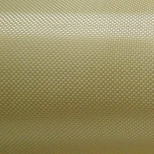

I got the book and had a look thru it. Of course it's mostly about building a new CS. I didn't realize that a single sheet of fiberglass cloth is used, at least by the author and hic co. The widest part of the delamination is about 18" so ideally I would find some cloth of that width. Here's is what I found on my brief search. https://www.amazon.ca/Fiberglass-Woven-Roving-Cloth-Plain/dp/B01N3A2QHA/ref=sr_1_14?
Is there any particular brand or supply source that you would reccomend?
Thx
It is a really good idea to only buy fiberglass cloth that comes rolled. Folded stuff, like that listing shows has a nasty habit of holding creases when you are trying to get it saturated and down smoothly. You end up going over and over with a squeegee or your roller trying to get it to relax. Glassing is tedious enough when everything is going well, no need to make it more difficult.
