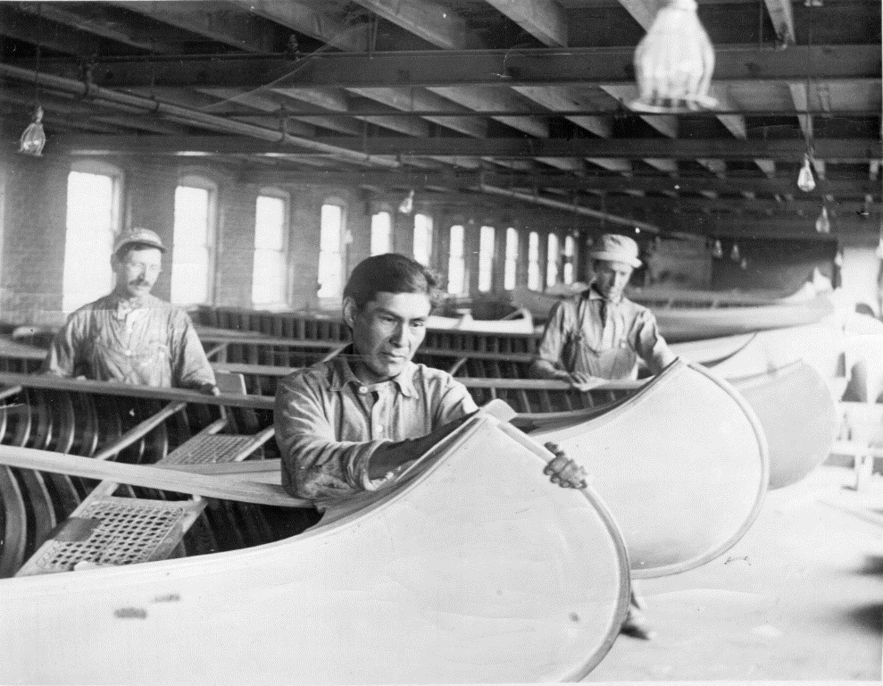

My guess is that rail caps were bent and nailed right on the boat. The picture below is the only one I could find showing people working on closed gunwale canoes at Old Town.
I wonder if they bent gunwale caps right on the boat - efficient for highly skilled workers, particularly if two or more of them worked as a team for the installation. But then the outside cap, particularly on canoes with a lot of upsweep in the sheer, might be tough to bend without breaking unless a form were used. The photo above doesn't really show anything with respect to cap installation. These are workers posing for a photo with construction-complete canoes. At best they are sanding or tacking (tack-clothing) the canoes prior to finishing.

Yeah, that twisting is a nightmare. And the compound curve of top caps... Good fixtures and nice clamps like Destacos - excellent way to go. I wonder too about how they shaped the caps, tapering to the ends. Did they cut to near-exact length, then taper, then bend (on or off the boat), and then maybe do any last-minute trimming with small tools? Caps like those on Morris are so precise including the chamfers - just so very well done. However they did it, they really knew what they were doing. Mad skillz! Here's real proof:
Regardless of what the Old Town factory photo shows it's still a cool picture and we are lucky to be able to see photos like this. I wish there were photos from other company's factories to see. Kudos to Old Town for saving them and Benson for sharing them with us.
