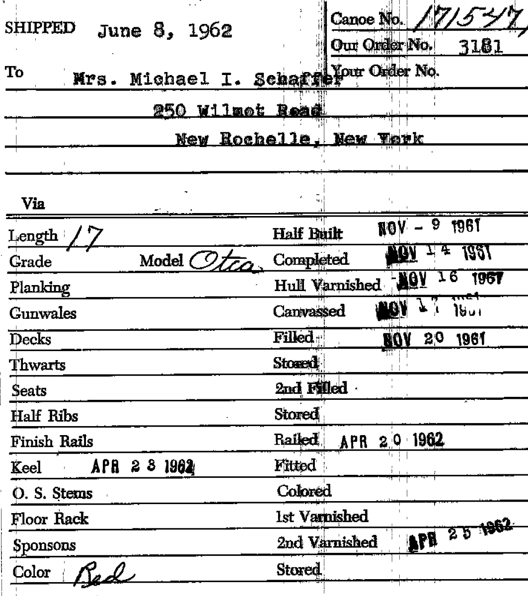

Welcome and congratulations, the Old Town canoe with serial number 171547 is a 17 foot long Otca model with a keel. It was built between November, 1961 and April, 1962. The original exterior paint color was red. It was shipped on June 8th, 1962 to New Rochelle, New York. A scan showing this build record can be found below.

Upon further examination the build sheet is correct. It has spruce inner gunwales, ash decks, thwarts,yoke and seat frames. Washered holes in bottom it seems to fasten keel. Discoloration on deck where a stem band was. Did this canoe have wood outer stems or just a band over canvas? Also what species of wood have been used for the missing parts ( outer gunwales, keel, and outer stems if applicable)? Thank you
There is no date on the "O. S. Stems" line of the build record so it probably didn't have outside stems originally. The specifications page at https://www.wcha.org/catalogs/old-town/specifications.jpg from the 1962 catalog lists mahogany for the outside gunwales. The keel was probably ash or another hard wood. Let me know if this doesn't answer your question.
