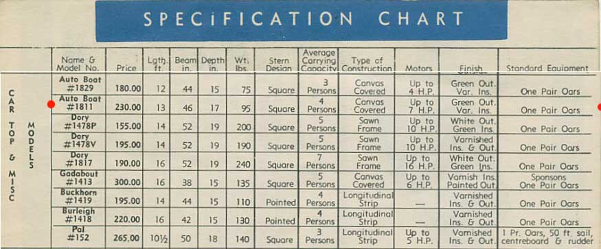

Thanks for the information guys. I think my description of the boat may be a bit misleading. I've since found a few photos online of a Peterborough Autoboat. It looks like the boat I am considering building. Below is the specs for a 12' Autoboat that was posted on this forum. Does this change your opinion about the suitability of a motor?
attachment.php
You're correct
Yes, but that is not a square back canoe. It may be "canoe" construction, ribs, cedar planking, canvas, but that is made for a motor and will do just fine. Good looking boat. Obviously a competitor to the Penn Yan "cartopper."
but even a short boat like this is not going to balance very well with out adding some weight to the front, I have used a 2 hp Honda on a 12 ft aluminum boat some in the past, always had a 5 gallon bucket full of water or rocks for the front.
