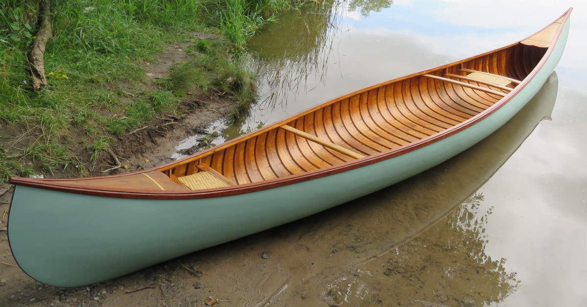

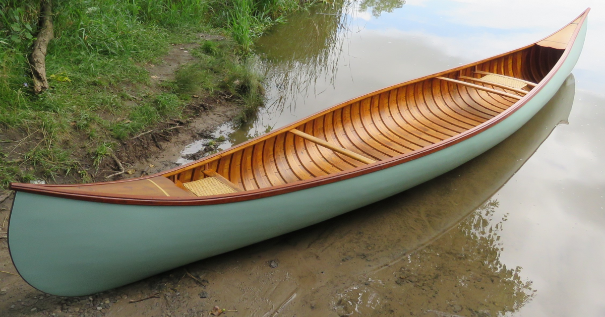

This is Kirby #01 Green Grey matte. It's too green for the Cnuts. I currently have this canoe sitting literally right next to the Prospector in my garage. The Cnut is a much more grey and muted color.

My restored Chestnut Chum in Kirby's custom mixed paint to match Sherwin Williams "Cornwall Slate". It was intended to be semi-gloss but came out rather flat. I'd go gloss next time.
Same canoe, outside:
And, a comparison of Kirby's colors vs. the Cornwall Slate:

Please Mike, excuse my ingnorance, but which is this beauty of a canoe ?
Etienne
Etienne, you have a discerning eye. That is a very unique old Gerrish.
