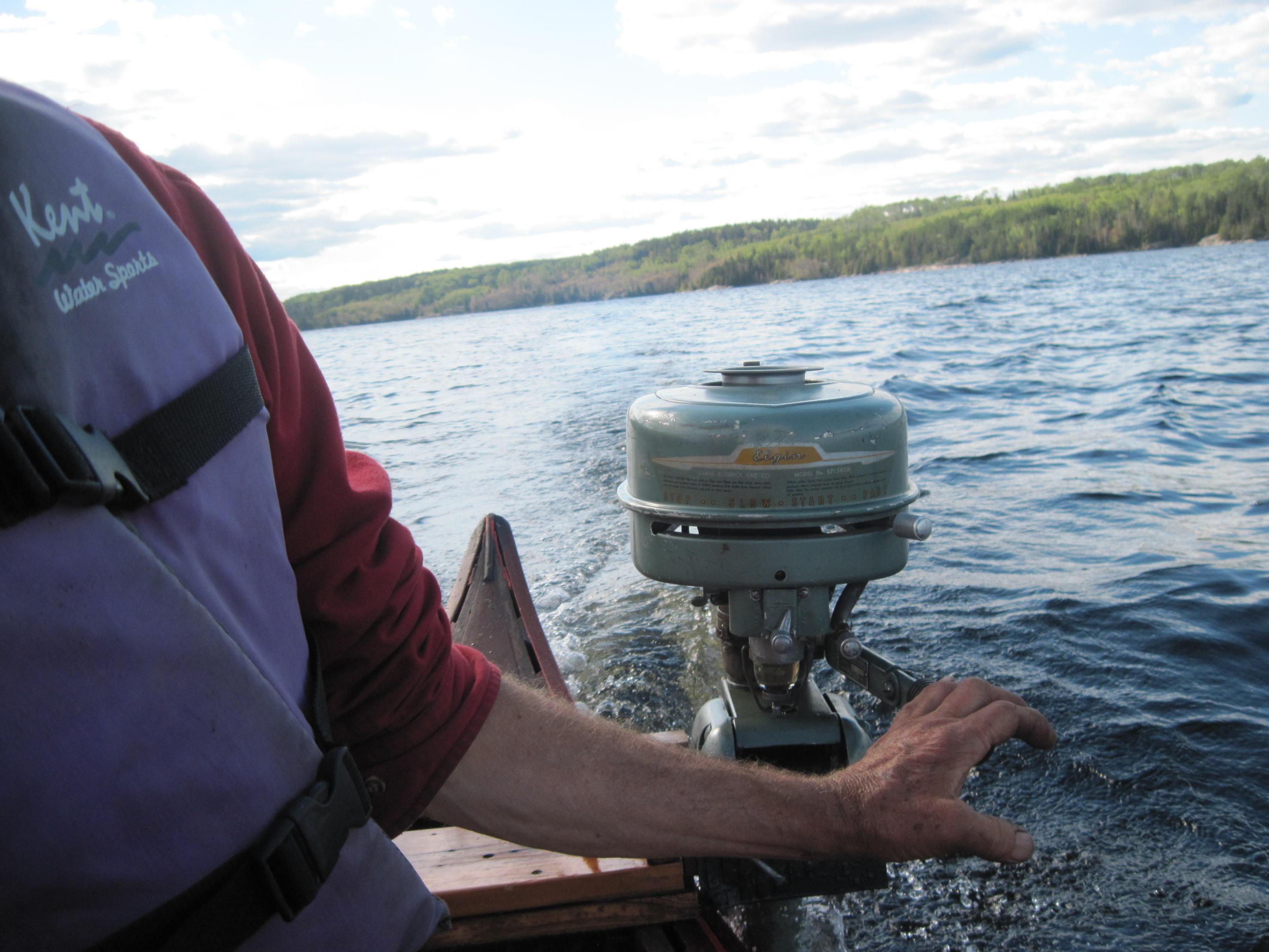

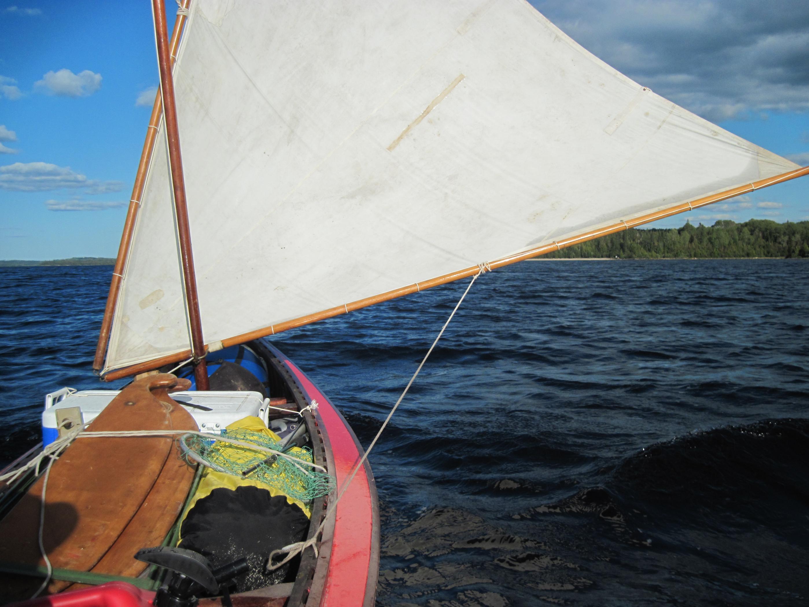

Here's a 1952 Elgin 2 HP air cooled powering a 17ft Old Town HW with sponsons. I'm on my way in and runing the tank dry. When the gas gave out I sailed. Motors are good when you're on a large lake and need to get back to camp miles away and against the IMG_2064.jpgIMG_2072.jpgwind.

I agree with Matt. Even that 2 HP was more than adequate. It weighs 28 lb and with care, balance, can be mounted and dismounted from the seat. I'm going to downsize my motor. One caveat, empty canoes with motors on the back are dangerous. Ballast the front or the power and wind combination will send you over. That front end out of the water while into the wind is near impossible to control. Someone suggested coolers filled with water for ballast as better than rocks since rocks will take you down if you capsize while the water in loose topped coolers will empty. Electric motors you can use the battery for ballast by extending the power cords putting the battery under the forward deck. You have more weight with a battery and trolling motor and mine seemed a bit slow on that same 17 ft Old Town. But the electrics are definitely quieter and easier to start/stop. BTW, you can make those mounts out of wood quite easily to fit your canoe.
