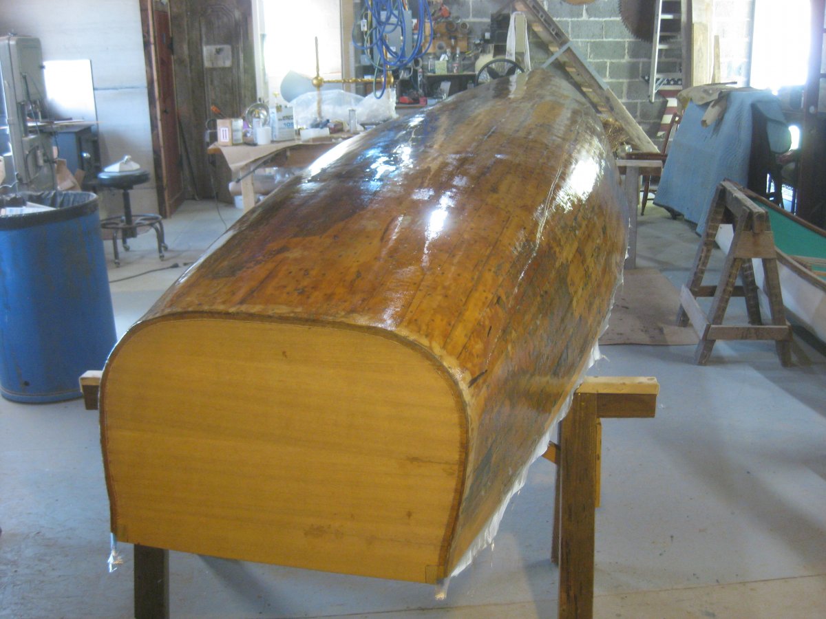

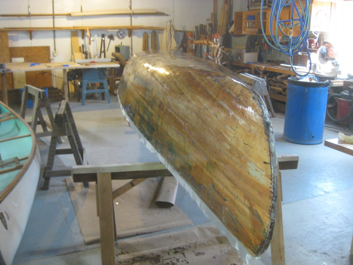

Here's a Grand Laker I just put new glass on and a new transom in. I don't enjoy working with glass but it wasn't to bad. Took the old glass of with a heat gun and then lots of sanding . Overlapped the bottom. It got a new keel and outwales out of ash. It got primed and painted in green. If the old glass is on there good just sand. Or you could always put one layer of 6 oz. cloth over it. 028.JPG 028.JPG 027.JPG
Those are 2 great looking boats Todd! the Yellow really does make the wood very warm. great job.

Here's a Grand Laker I just put new glass on and a new transom in. I don't enjoy working with glass but it wasn't to bad. Took the old glass of with a heat gun and then lots of sanding . Overlapped the bottom. It got a new keel and outwales out of ash. It got primed and painted in green. If the old glass is on there good just sand. Or you could always put one layer of 6 oz. cloth over it. View attachment 37137 View attachment 37137 View attachment 37138
