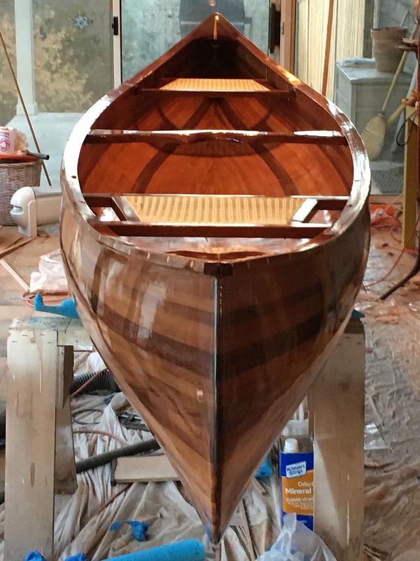

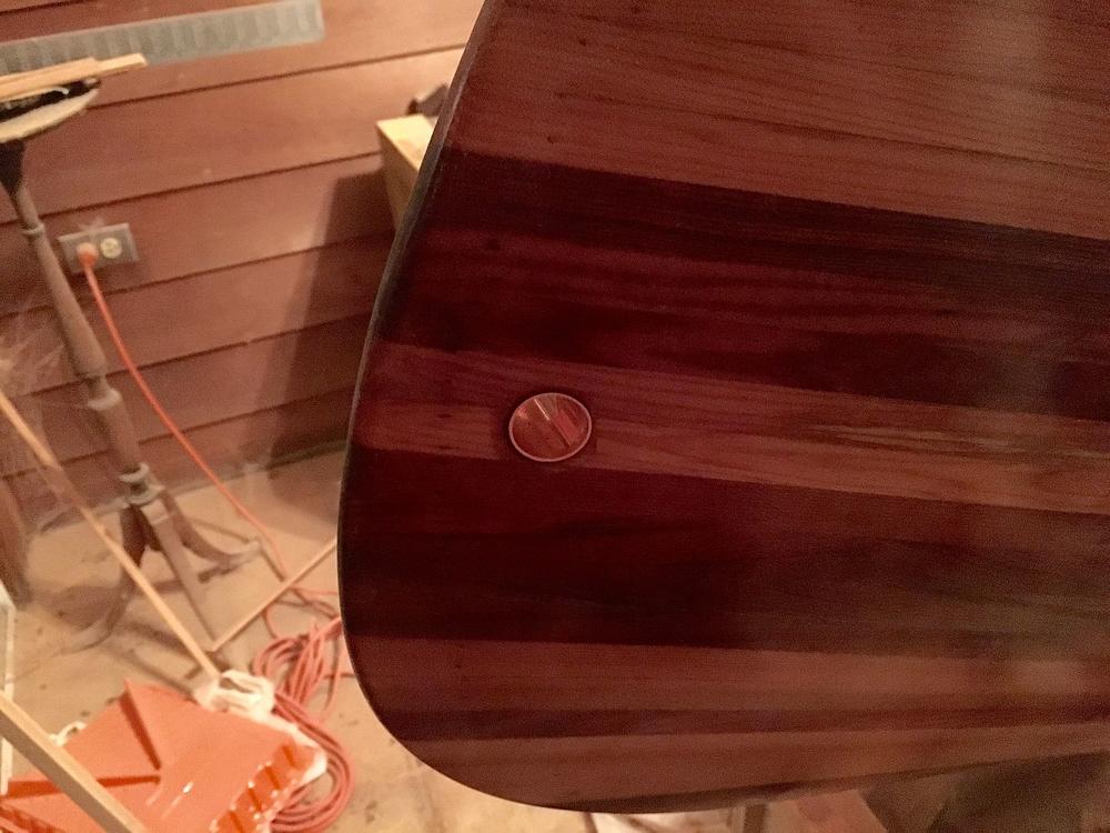

There is the Gilpatrick method. Drill through the hull near the water line and epoxy a length of 3/4 diameter copper pipe in place. FullSizeRender(28).jpgIMG_2776.jpg
