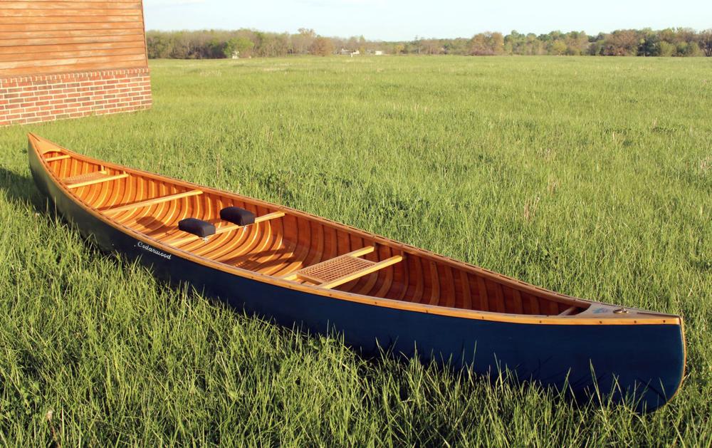

Thanks so much for all the timely information! Now, one more question if I may? Since the rest of the paint looks pristine, what about taping around the waterline and just sanding and painting the bottom? Oh, and here are the pics. The first one shows the abrasions. She's a beauty!
A beauty indeed!

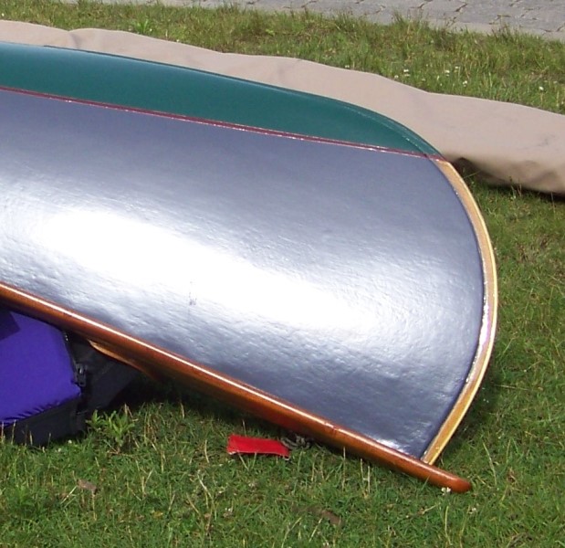

Here a some pictures I've taken of a few canoes on the lawn at our last few Assemblies at Paul Smith's College --
Your suggested two (or three) tone paint scheme can be quite attractive.
