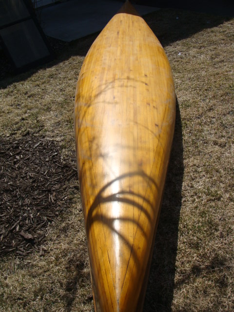

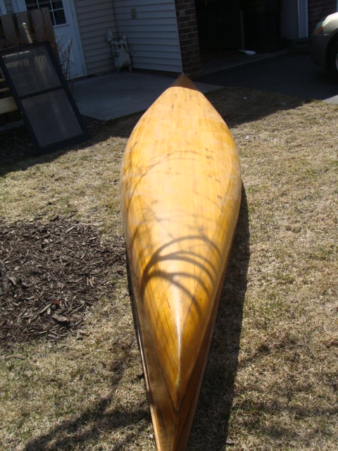

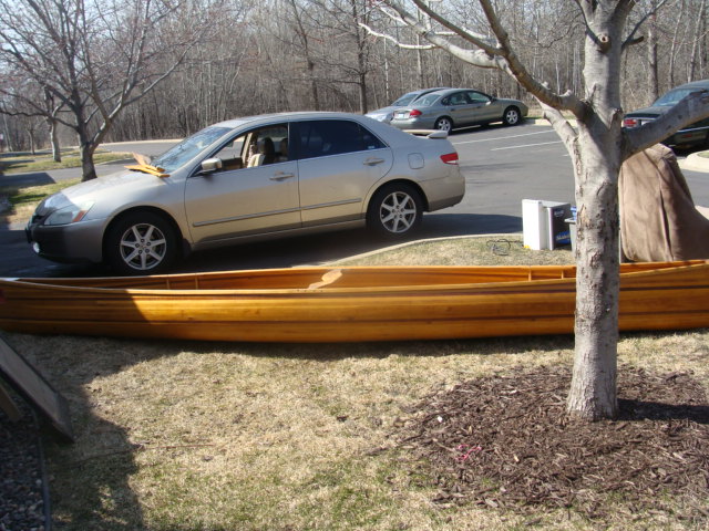

DSC00659.JPGDSC00660.JPGDSC00661.JPGHere are the pics of the stripper, as promised. Hopefully I can remember how to post them.
Okay...that's all the pics. Let me know if someone needs more of a specific area. For starters, would like to know if I need anything special to clean her up.
Just and FYI, all of the haziness that you see in the pics, is actually a THICK coat of dust, not haziness in the clear coat or epoxy or varnish, or whatever you call it.
Any info on this would be great. Also, I CAN car top her myself, although she is pretty heavy still. I think she weighs about 70-80lbs or so.

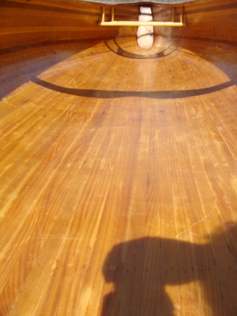

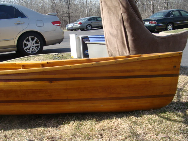

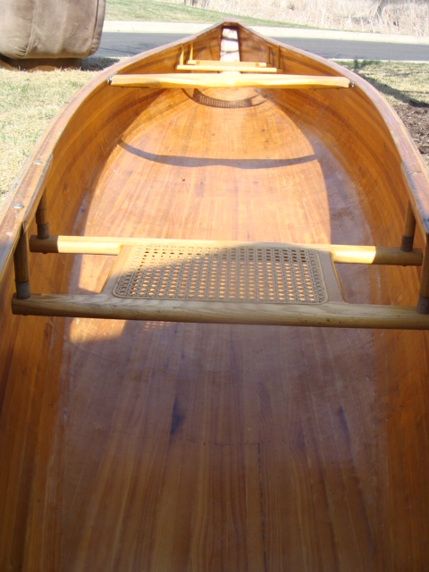

Jennifer,

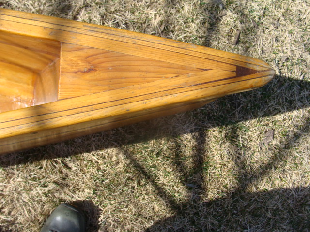

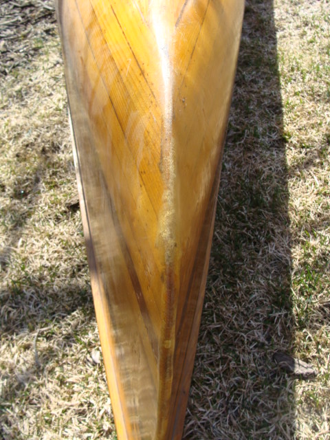

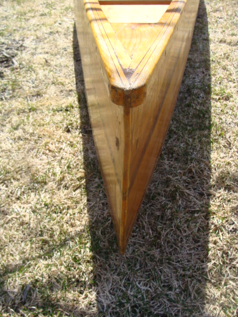

Yes, it does appear homemade, but in good condition. You can clean it up with some soap and water and a garden hose. There appears to be a little delamination of the glass in one of the photos of a stem, but it doesn't look too bad. You might consider applying a coat of UV protectant varnish. UV rays from the sun are deadly for clear fiberglass.
Norm
Mostly what Norm said. I've seen a few home-made strip & glass boats, and this would rate in the middle of the workmanship ranks.
That delamination on the stem looks like someone ran it into a rock at high speed. You might want to have someone in your area take a look at it -- it may need some work.
You might not even need soap to clean it up -- just the garden hose, and a Scotch-bright scrubber. But definitely get some UV protective varnish or polyurethane on it -- I'd give it 3-5 coats inside & out, depending on how impatient I felt to get it in the water.

I didn't see where you were talking about with the stem. I guess I didn't look it over that well. If someone can point out which picture you are seeing that in, so I can get a better idea. I made sure that the gunnels weren't pieced together, learned that last time. The hull has really NO scratches on it. The stem wasn't broken.

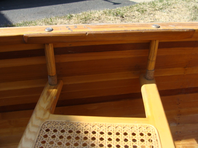

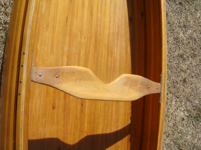

The brackets that the seats hang down from seem kinda flimsy, like they wouldn't hold up my weight. Would it be complicated to get some better brackets put on there that would still go with the stripper design and not look like a new silvery piece??
Also, even thought this is a really big boat for paddling solo, all I did when I was a kid was paddle 18foot grunmans solo, so I know I can do it. Where would be the best position to paddle in this boat?? I may even like to learn Canadian style, but I can't kneel in the boat, it's TOO uncomfortable and I'm not flexible. I could put a seat in the middle, but then I don't have a yoke to hoist the boat up. The boat is pretty heavy, but I CAN do it. Are there any other options for paddling in the center, or do I just want to paddle in the bow and paddle her backwards?? I like the nostalgia of this boat, the wood look and feel, I guess that's kind a why I keep coming back to these kinds of boats. Any advice on would be great.....Thanks!!

Your best option for solo paddling in this boat is probably to paddle it backwards, sitting on the bow seat and facing the rear. That would put you closer to the center of the canoe. You would probably want to a bit of weight in the other end to level the canoe on the water. The attachments for the seats look pretty standard to me, and I suspect they would be fine from what I can see in the pictures.
I've attached the picture that made me think there was some damage or delamination in one of the stems. Anything with a foggy or whitish color might be delamination. Can't tell if that's actually the case. It might be just the lighting.

What Norm said. That's the same picture I was concerned about; looks like it may have kissed a rock.

The big question to me, is, have you addressed the spot that looks like it's delaminating? You really should make sure that's not an issue before putting it in the water, if only because if it leaks into the wood, it'll take a LLLOOONNNGGG time to dry out...
