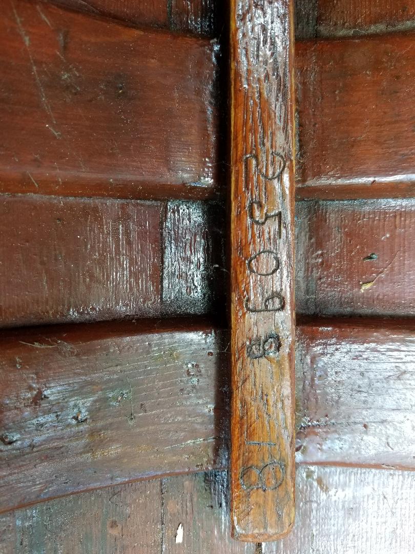

Almost 100% certain that the Old Town badge is not original but it does have the numbers 1913 stamped into it, which might be the year it was built if my other ideas are on the right track.
The search feature on this site is pretty good. You will find some information has already been posted about boat 25099. Here is a link that may interest you.
http://www.wcha.org/forums/index.php?threads/information-for-old-town-25099-18.11255/#post-58056
Or is that 25098, or 25095?

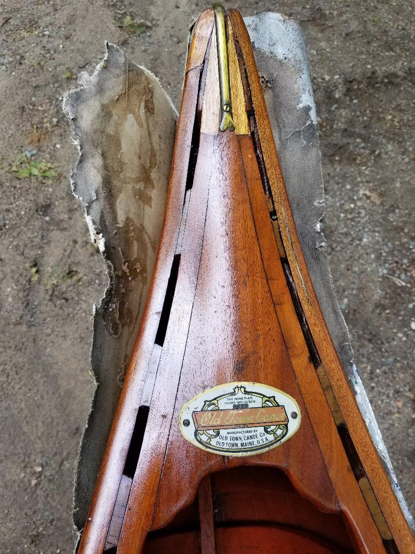

The stem numbers are not stamped into the stem...it looks like the stem has been replaced. Factory stems have the numbers stamped into the wood, not engraved. Check the other stem to see if the numbers are stamped. That should confirm if it is the same boat.
The tag that is attached to your deck is not one that would have been used in 1913. This one is the style that should be present.http://www.wcha.org/store/old-town-deck-decal-1906-1954
It should be a waterslide decal, not a plate. Those plates are quite modern and were sold at the Old Town store.
Thank you! I think it is 25099 but the other stem has the same type of engraving which was one of the things that made me think it wasn't an Old Town.

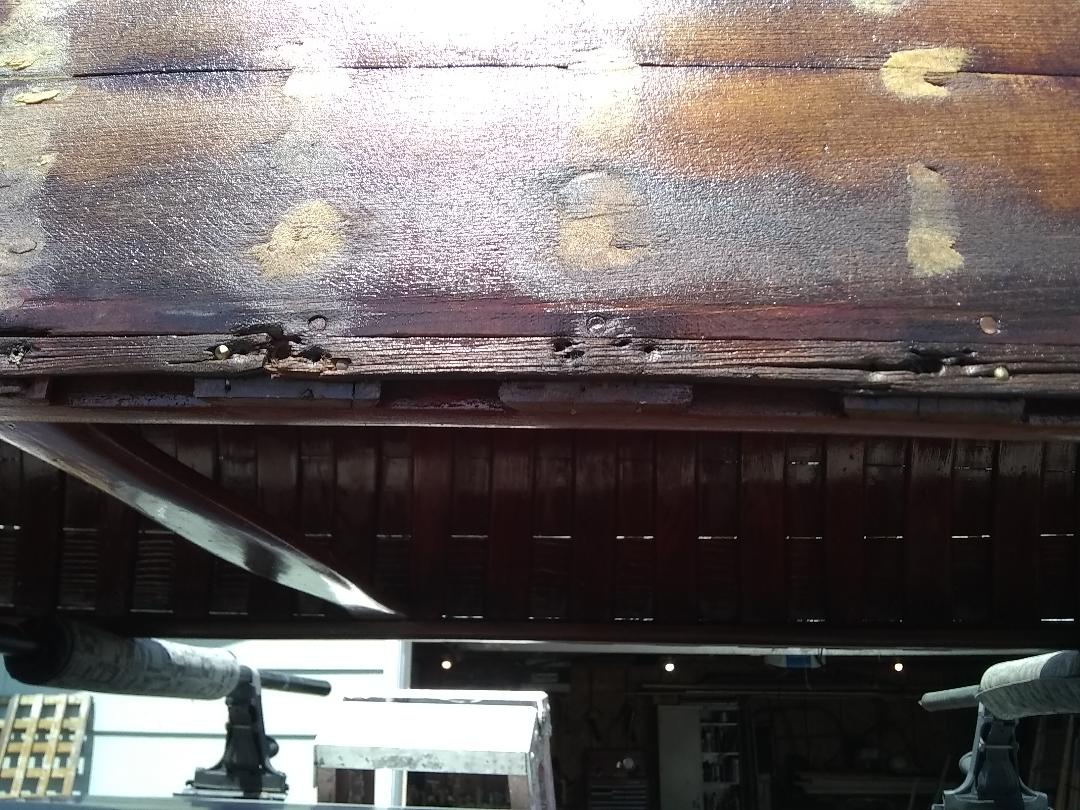

I would also like a bit of advice on replacing the last plank section that would be under the outwale. It seems structurally decent but you can see there have been at least two prior re-canvas jobs done and I am wondering if the next set of tacks will still hold as well?
I could replace those pretty easily, but sourcing the lumber might be the tricky part. I can get Western Red Cedar but it has been kiln dried and I have some old redwood that I could use, but I am not sure I can find a white cedar board to rip down and if I don't need to do the work, I would rather just skip it since it does seem fairly sound for such a thin piece of planking.
I took a couple pics of the area I am referring to. Thoughts?

Take my advice with a grain of salt...there are other folks that would approach things differently than I do.
I would remove those narrow boards and replace them. They've seen their good days gone. Before replacing them I'd be looking at the rib tips and decide if they need some attention. If that planking is so filled with holes the ribs must be almost as bad. You need the rib tips to be in decent shape in order to get the new plank, the canvas and then the outside rails to hold. Once you get a look you can decide on how you'll repair them...perhaps some glue mixed with sawdust or a wood filler. Some may require rib tip replacements.... Suddenly replaced stems make sense.
You should be able to rip that old red cedar into a useable plank...it's a narrow piece. Since red cedar tends towards brittle you might pre-drill before tacking it in place. Luckily that's a flat piece so it should be easy for you to repair. I punch small holes into planking using a small brad (as a drill) in my drill. Hold your clinching iron tightly up against the inside rail when you hammer the tacks in. The "pro job" requires you to hold at least half a mouthful of tacks in your mouth while you work.. grain of salt.
You should be able to get it back in the water for less than a thousand dollars... canvas, tacks, filler, paint, varnish, tools if you don't have them should include a tack hammer, a clinching iron and a small nail/tack puller... you should be able to get it done for much less if you don't add up your time.

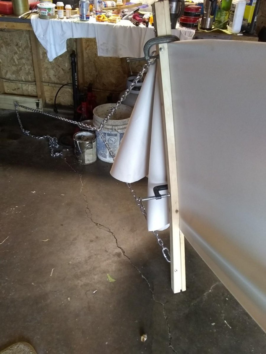

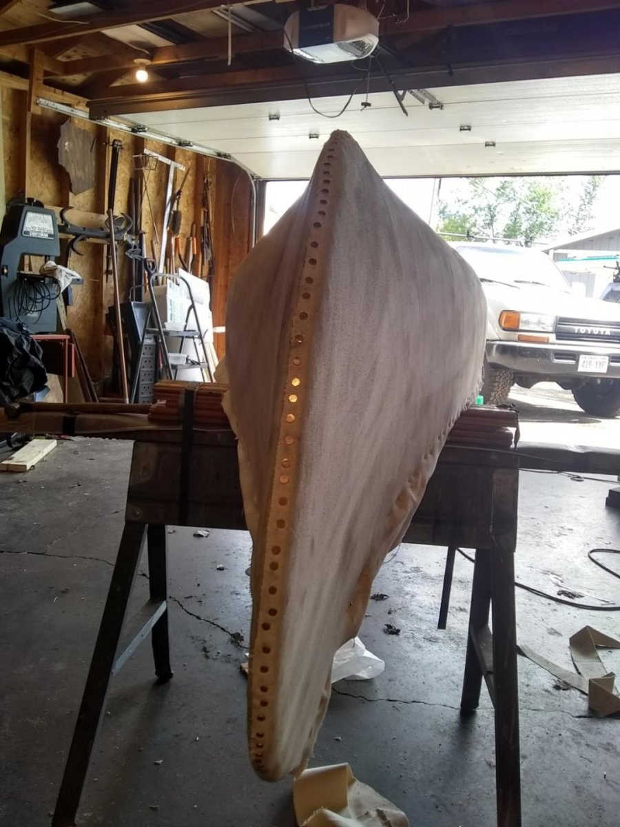

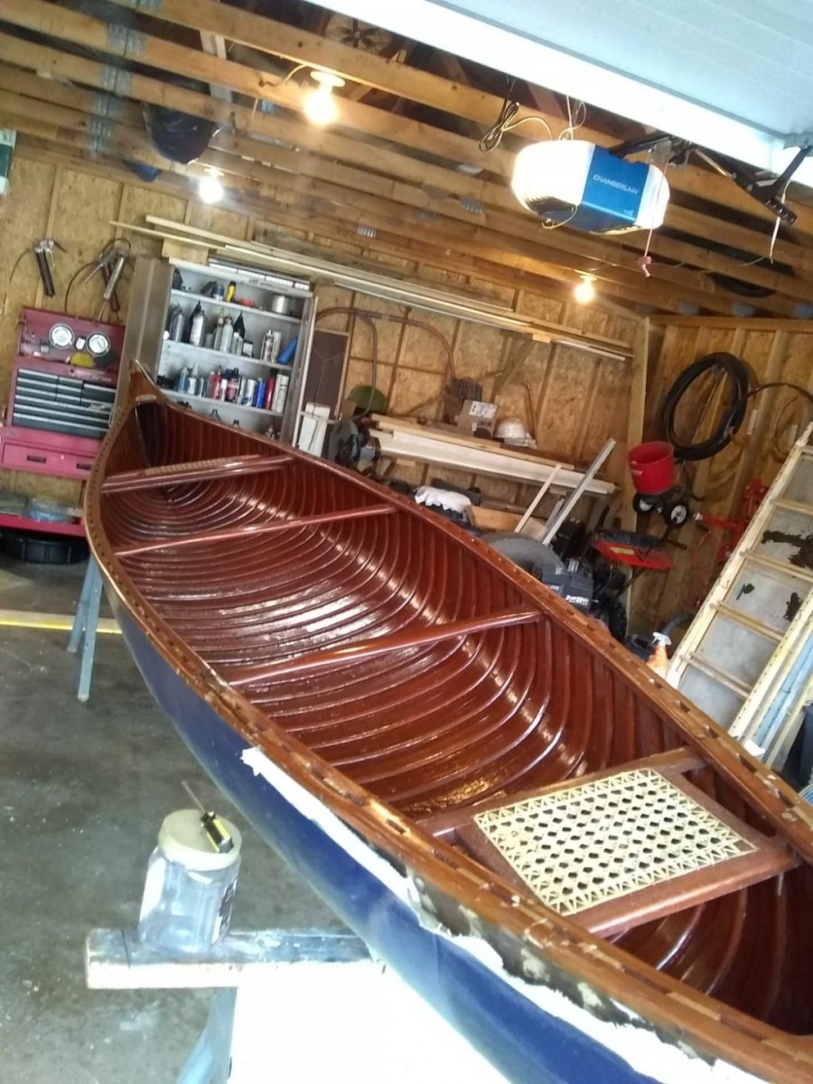

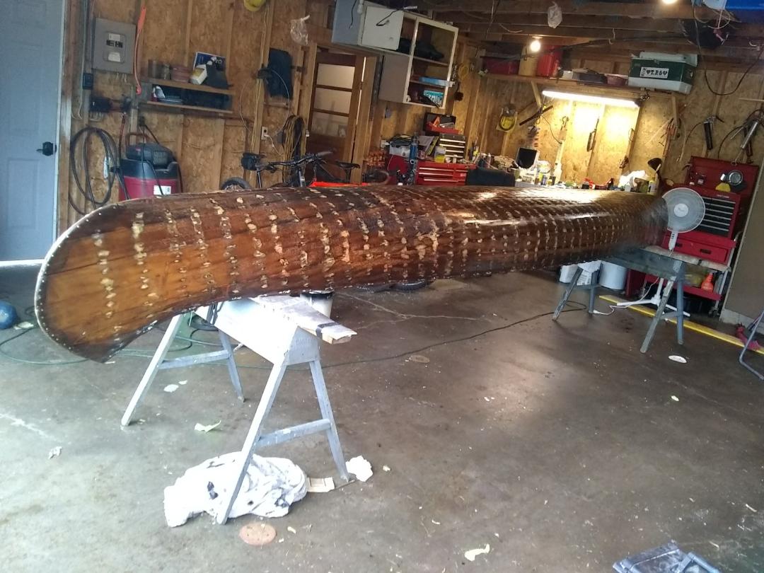

Made some progress. I got the hull soaked in the linseed oil/turpentine/mineral spirits blend and allowed it to dry. Fixed a few little spots on the planking with new white cedar and then used the come along with "clothespin" style clamps that I made on the table saw and router table and chain. Turned out really nice but I did have to spend some time on the stem area to get everything stretched taut properly with no scallops as this canoe has a very curved stem.
Next is adding the filler and the paint and final assembly.

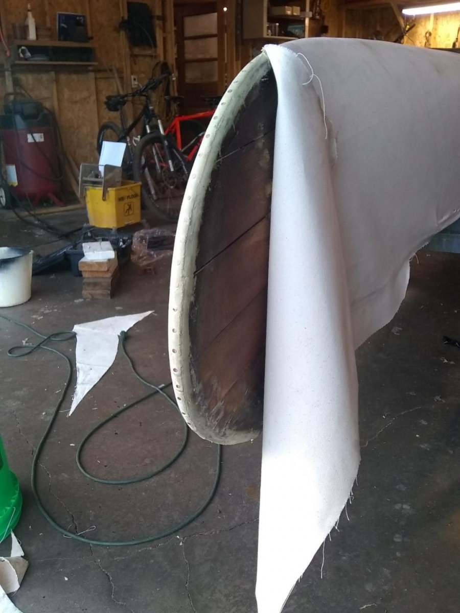

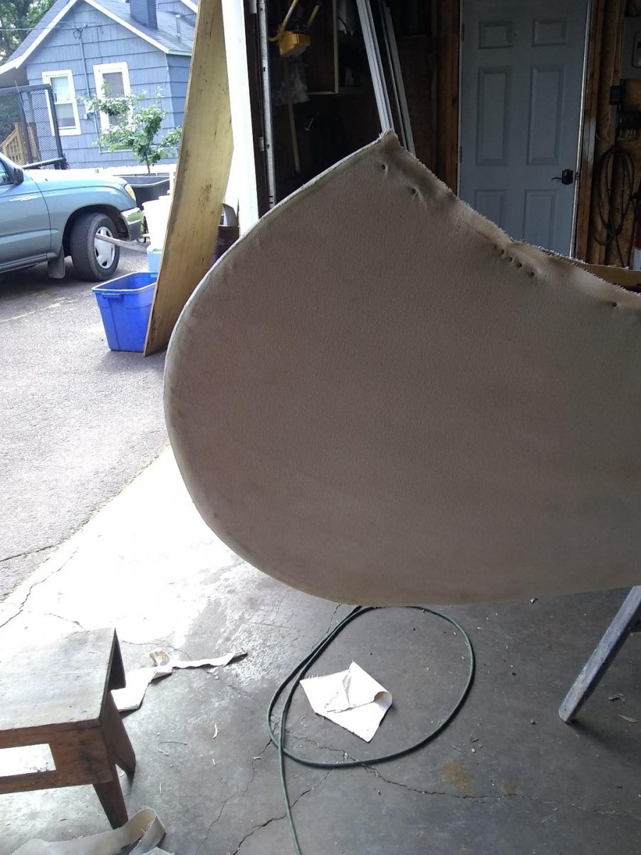

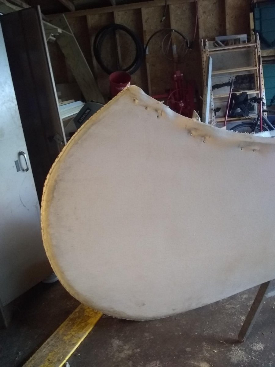

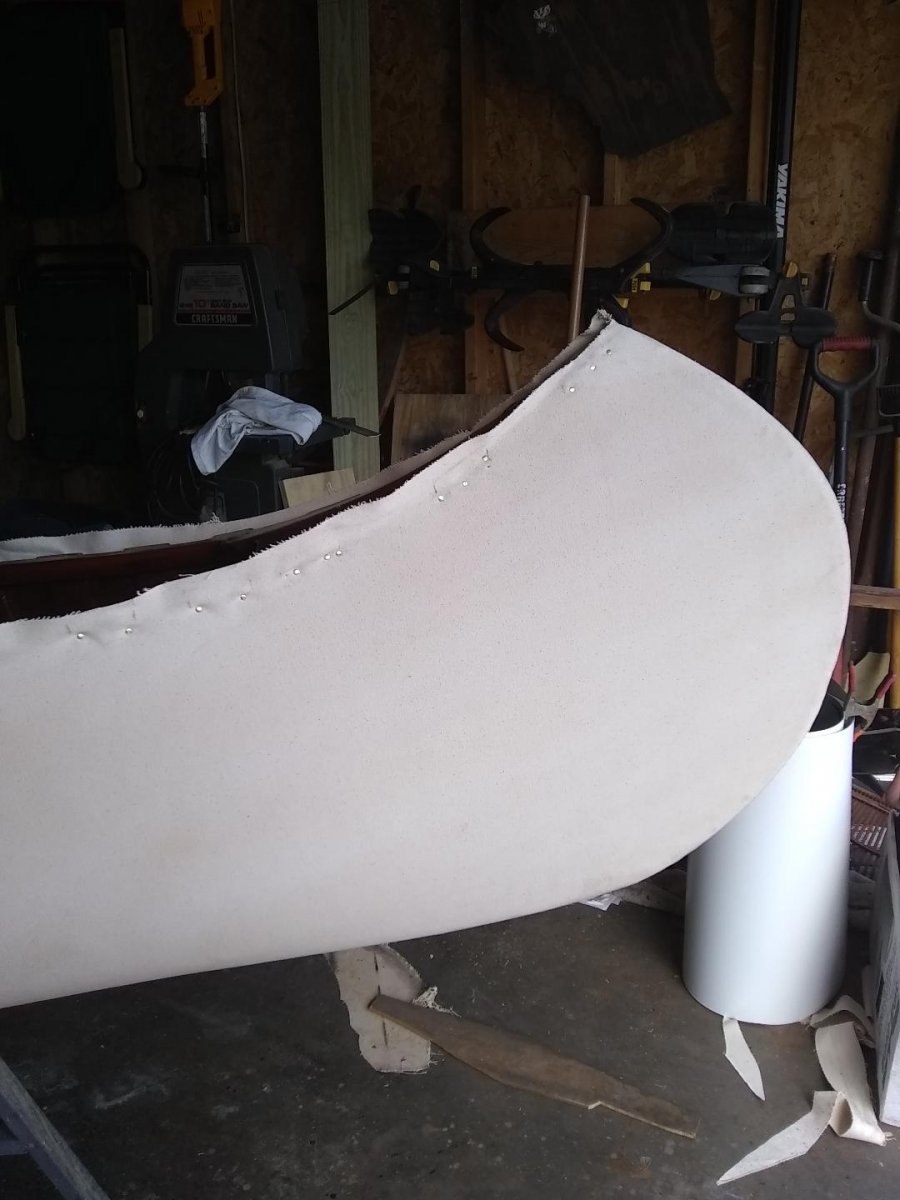

Few more of the stems. I ran into an issue with the tacks that held the ends of the planking to the stems popping out when I tacked the canvas to them. The starboard side stern was bad enough that I decided to glue the tacks in once I had them holding again. I might end up regretting that I didn't do all of them, but it was too late to do anything about it except for the last section. The canvas is tensioned properly though and that should help keep them in place, even if you end up seeing a few down the road.

Nice work! Noticing the ring nails along the stem sitting a little proud. You can leave them proud but you will really need to take care to not sand through the canvas. You can drive them in after the canvas is on. But again you will need to be careful not to put holes in the canvas. Or another option, you could try to build up the filler along the stems there. The extra material may buy you some fairing material to cover them. Some guys take filler from the bottom of the pail and sculpt up that area to cover the seam and smooth everything out. I've done it prior to filling the rest of the hull with pretty good results.
