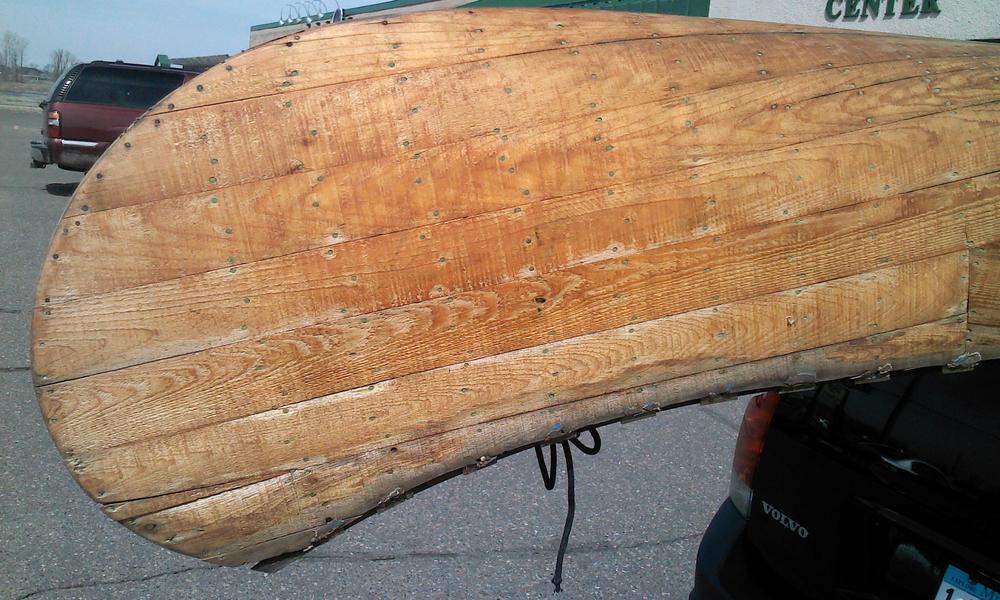

Hi, I just got a 1947 Old Town Canoe that I would like to restore, and I'm looking for a club or org in Minnesota. I would also like to ask if there are any good links in taking on a project like this? I would be looking for parts, wood planking, etc. I was also wondering where I would find the history of her, I think I found the number on the bottom of the canoe. I have attached some pictures of her. Thanks canoe2 003.jpgcanoe2 006.jpgold town canoe 023.jpg

Hi, I just got a 1947 Old Town Canoe that I would like to restore, . . . I was also wondering where I would find the history of her, I think I found the number on the bottom of the canoe.
The Old Town canoe with serial number 147575 is 17 feet long, AA (top or premium) grade, HW (heavy water) model with Maine cedar planking, open mahogany gunwales, and while not specified on the build record, the seat, thwarts, and decks on a AA grade canoe would usually be mahogany. It was fitted with a keel and a floor rack. It was built in 1947, with varnishing finished on March 25, 1947. The original exterior paint color was dark green. It was shipped on April 2,1947 to Minneapolis, Minn. A scan of this build record can be found by following the link behind the thumbnail image attached below.
It is also possible that you could have another number or manufacturer if this description doesn't match your canoe. If that is the case, photographs of the deck, side profile, seats, and other details would be helpful in identifying the canoe. Feel free to reply here if you have any other questions. Feel free to reply here if you have any other questions.
