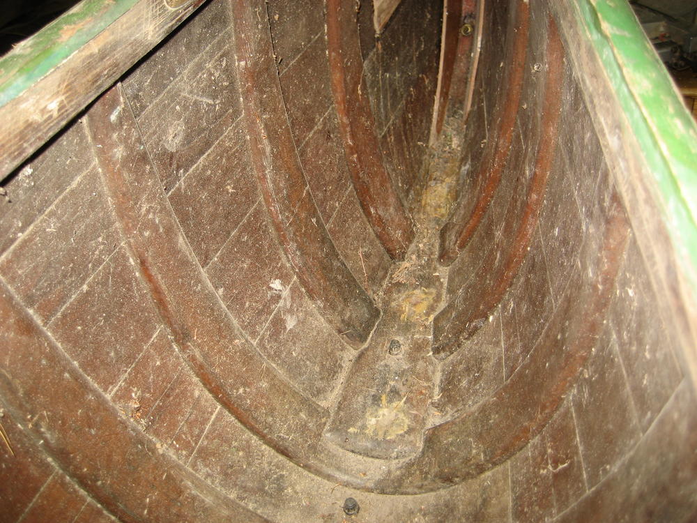

IMG_0045.jpgIMG_0048.jpgIMG_0050.jpgHi everyone From what you have said I think it is a Morris. The seats and thwarts are Mahogany. It has two sets of cant ribs under the deck, and the third rib does touch the stem. Will try to post some pictures. Thanks for your input and help HarryIMG_0047.jpg
Hi Harry-- Yes indeed, your canoe is a Morris. Congratulations, and thanks for sharing this information. Several of the folks who inhabit these Forums on a regular basis have intimate knowledge re the restoration of these great boats, so if you have questions, please post them... and we love pictures of on-going restoration projects... and launchings. It can help to have a cheering squad!

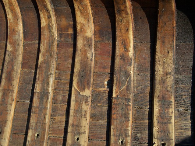

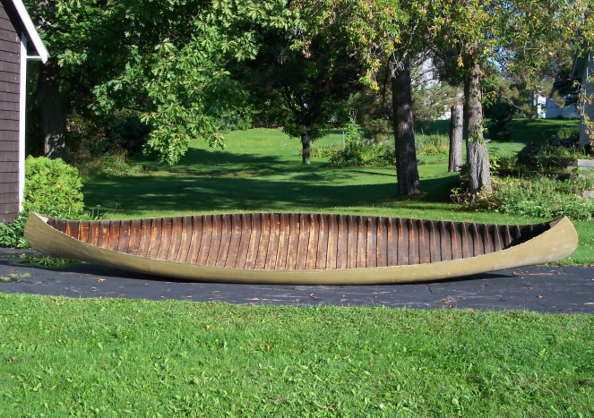

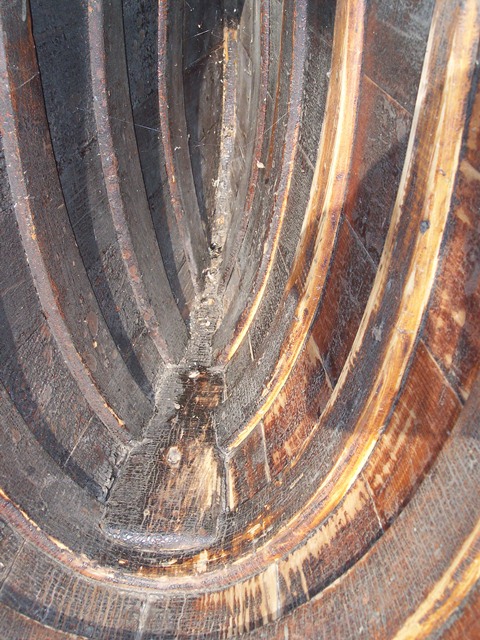

Harry --
Your Morris may not be in great shape, but it is better than some (and it has only canvas, not fiberglass, to remove)
sm cr 100_1783.jpg ssm 100_1915.jpg ssm 100_1924.jpg ssm 100_1769.jpg ssm 100_1788.jpg
While I do have the original seats (which I have recaned and refinished after rebuilding one of them), two of the three thwarts, and the floor rack, I have no outwales or cap rails, and just a couple of fragments of the inwales and keel. Several ribs need replacing, and a bit of planking also.
But I hope to have Morris 6466 done in time for Assembly 2015 -- bring 2073 restored, and we can compare notes.
