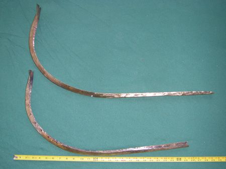

I'm near the stage of putting the original 1948 White wrap-around stembands on the rebuilt canoe, but there are two puzzles: neither of these stembands extend all the way up to the underside of the outwales. My guess would have been that they should have, but I have a gap of about 3 inches. I can assure you that I did NOT add an additional strip of planking, :) . How would these stembands have looked on the day the canoe left the factory? And the other thing that I notice is that the two stembands do not have the same length extending along the keel. My guess would be that the longer stemband went onto the bow. Is this guess correct? Tom McCloud

Paul, Thanks for the photos. It certainly shows the stembands extending all the way to the top. The stembands on my canoe are shorter by ~4 inches. Unless it is possible to braze and extension on, guess I have to live with what I have. Tom McCloud

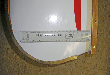

Hello, Rollin, Thanks for the info and photo. The shiny brass makes me think this is a canoe you built rather than a 50 year old one. The attached photo show the two brass bands I'm working with, and clearly shows that one is longer than the other. And the next attachment shows that the stemband does not reach the bottom of the inwale. I can only assume that it was shortened during some previous repair. Maybe I could re-form the stemband, leaving less sheathing the keel?! This is the canoe I will bring to Assembly. Maybe you can stop by for a chat. Tom McCloud STH71365bresize.jpgSTH71362bresize.jpg
Yes, you can have an extension brazed on. I have had this done to preserve original stem bands and when you finish trimming and polishing, you cannot tell where the new material is. Patience is a virtue.
Hello, Rollin, Thanks for the info and photo. The shiny brass makes me think this is a canoe you built rather than a 50 year old one. The attached photo show the two brass bands I'm working with, and clearly shows that one is longer than the other. And the next attachment shows that the stemband does not reach the bottom of the inwale. I can only assume that it was shortened during some previous repair. Maybe I could re-form the stemband, leaving less sheathing the keel?! This is the canoe I will bring to Assembly. Maybe you can stop by for a chat. Tom McCloud View attachment 31500View attachment 31501
Tom.. braze or solder (I'm sure solder will be ok for this) the piece at the bottom end so the joint doesn't show to the casual on looker :)
TOM.....You would not see a joint with brazing, but sure, the solder probably will be fine, especially if you have the shape just right prior to adding on. BTW....if you need to do any reshaping/reforming of the curve....it can be done with hardwood blocks that are shaped at the ends to conform to what you need. These blocks would be correct for the width of the stem and the curve as they change along the curve. Line an expansion joint in your garage floor with a folded towel, on bended knee lean the stem against your shoulder and using the appropriate block inside the curve gently, tap and tap to resize......remember , no rush here, and it will be tough, I MEAN TOUGH, to correct for too much correction. You should be able to get a perfect fit on your stem....so much so that it will hang right there even without nails, for the moment. ANAL, YES. But once in a hundred years for a good old boat ? We should be so lucky....have fun !
