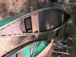

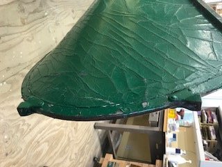

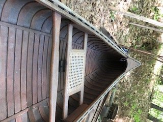

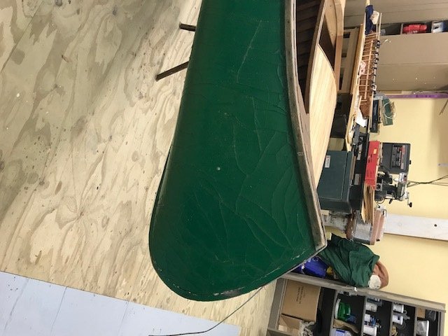

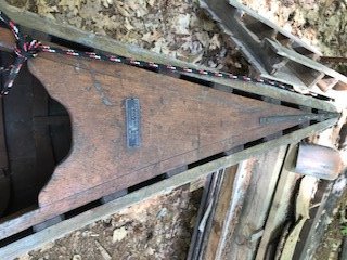

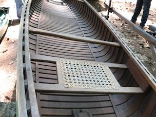

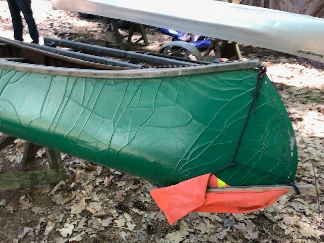

Attached are photos of my current project. I have the Thompson Catalog thumb drive Dan created but having a problem identifying the correct model.
I was leaning towards the Ranger, but the specs regarding ribs and spacing don't match. The gunwales curve up more like an Indian rather than a Ranger. In the end I guess it doesn't matter, but I'd like to get an idea the year it was manufactured?

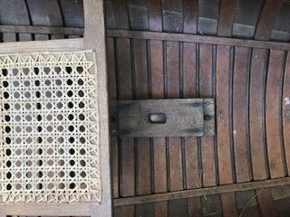

A couple other questions. I've had to replace 8 broken full ribs. They match the unbroken, original ribs, white cedar, 5/16" thick, 1" width, and 2" spacing.
The original planking is 4" wide red cedar. I have plenty of is 3" wide white cedar. How dumb is it to use white cedar planking? I think I can come up with a good color. Plus, how bad of an idea is it to use 3" planking instead of 4" wide planking?

I'm no expert on Thompson, but I think the Ranger has lower ends and circular stem profile more similar to Old Town and others, while the Indian and Hiawatha have higher ends and a different stem profile, not so circular. And I think the Indian lacks half ribs while the Hiawatha has them. None of your photos shows the bow or stern in profile, but if all of the above information is correct you may have a Hiawatha. I think that somewhere around 1940 the half ribs changed from filling the entire spaces between ribs to only partially filling them as in your canoe, so yours might be post-1940 or so.
What Mike said - post a good image of the end profile to be sure. The Indian and Hiawatha will have a higher "pulled back" profile. Indian's rarely if ever have the 1/2 ribs.

Carleton
I live and professionally restore vintage canoes and small boats in Northern Wisconsin. Thompson Brothers Boat Company was about 3 hours from me, and they actually had a retail outlet just 10 miles from where I live. So, I see a lot of Thompson canoes.
Michael Grace stated the difference between models perfectly. I researched the catalogs several years ago to try to figure out when the ribs and half ribs went thinner on the Hiawatha model. While we can’t give it a specific date, the catalog artwork changed in 1938 I think. So that’s all we really have to go on and call it good.

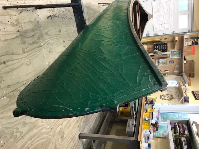

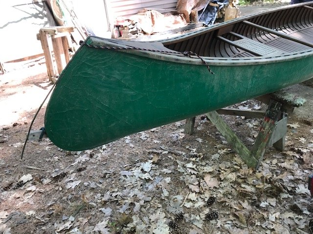

Thank you everyone for the information and suggestions. Attached are additional photos highlighting the bow and stern.
