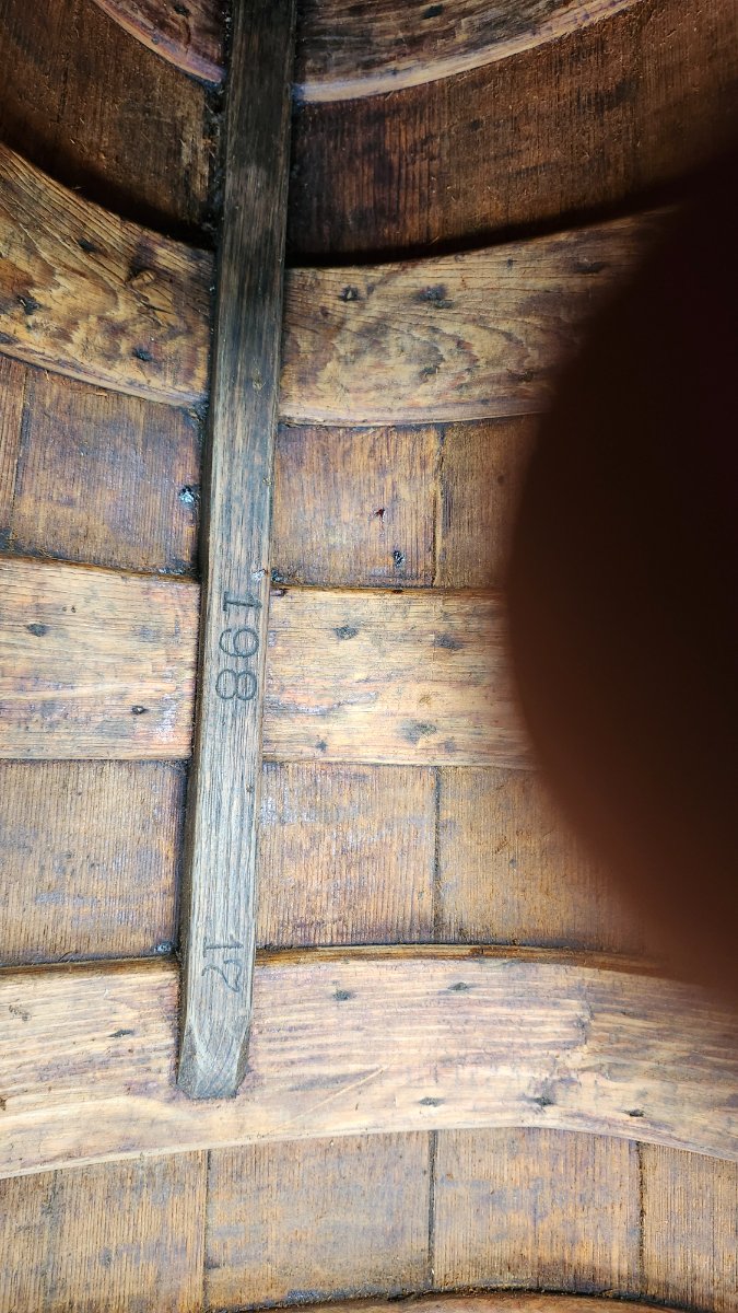

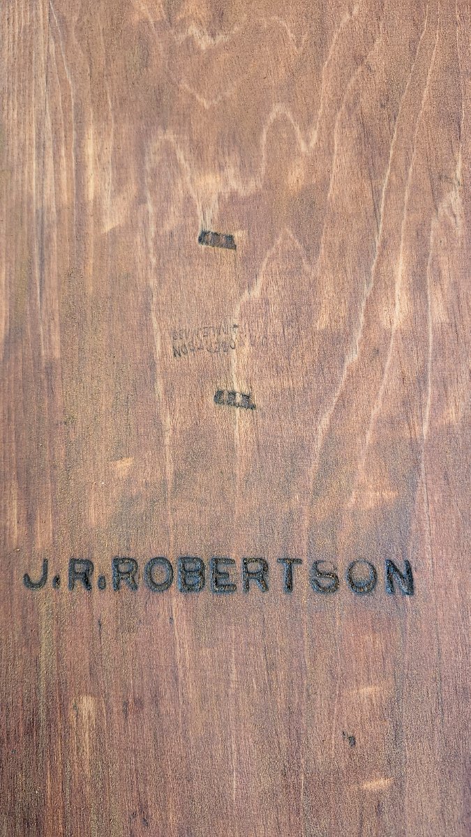

While stripping this canoe i found this under the front seat. Is it normal for all the fasteners to be iron? Dose any one have info on the date when this canoe was built?
Thank you for any info.

Nice find, iron fasteners are not unusual, unfortunately. There is very little information available about Robertson's serial numbers. It appears that he may have not have used the same sequence for his entire career. The name stamps, deck shapes, build style, and serial number fonts all show a lot of variation. The only hard evidence may be the invoice below for number 1088 from 1908. That canoe hasn't shown up yet, so we don't have much to go on. The link below has some more speculation.

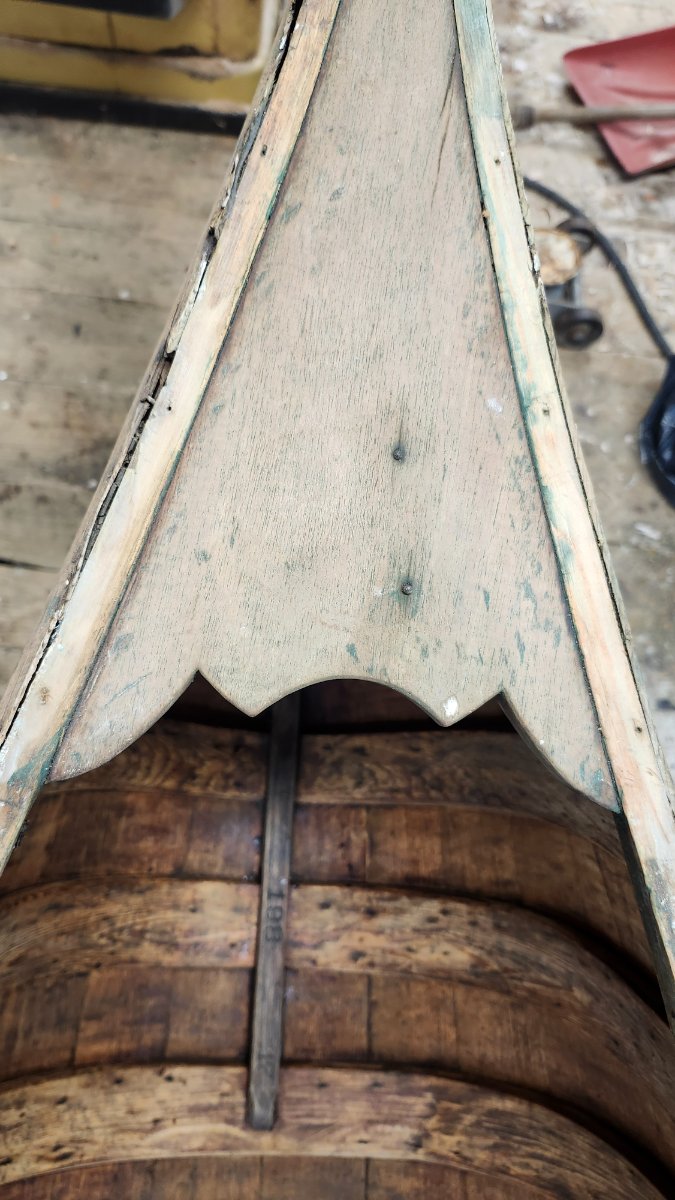

Also note the detail at the end of the stem- also an identifying feature of Kingsbury’s canoes.
Thanks for the info it is very interesting. The seats fit perfectly made of manhogany . We're Robertson's seats shaped like Kingsbury?

Well, here is the up date after stripping paint and varnish and removing planking and deck to repair damage.
Dan, you are rightt. The canoe most likely is a Kingsbury. Looks like the cained seats were replaced with solid manhogany ones by Robertson. The wood on the seats is different.
The iron fasteners are screws. Nails hold the deck and rib tops and a few plank repairs .
The rest of planking looks to be copper.
