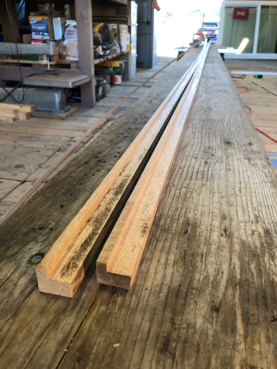

I'm going to steam bend mahogany outwales soon. Although the bending is not extreme in any way, I've been reading a bit about steam bending mahogany and some suggest that it's problematic at times. I believe my material is an African mahogany variety, probably Sapele. I read that adding a surfactant such as fabric softener to the pre-soak apparently reduces surface tension in the soaking water aiding in penetration of the fibers. Does anyone have experience with this, or comments pro or con? The material has been rabbeted for the plank/canvas overlap but left unshaped until clamped and dried to conform. Final shaping, tapering at the ends, etc will be completed with hand tools prior to final installation.

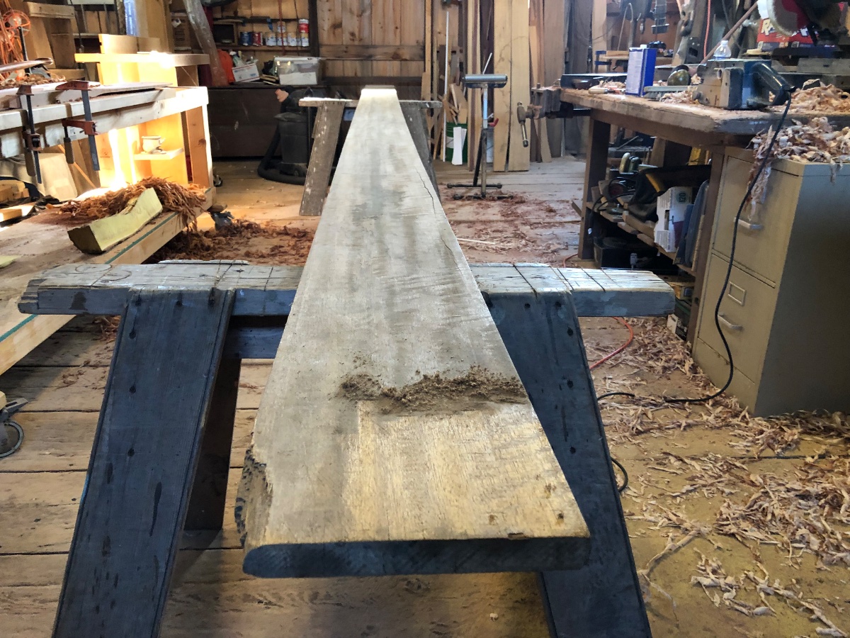

Sam, yes I am aware of the method by which the cells move. I really don't know what species I have but it is prepared and I'm confident it will work. As I said, the canoe (Rollin's Atkinson Traveler) requires relatively gentle curves- no outrageous upsweep at the stem. If it doesn't work well I'll try this stuff; it's 18' long so great for a 1-piece outwale. It's also a so-called Mahogany!

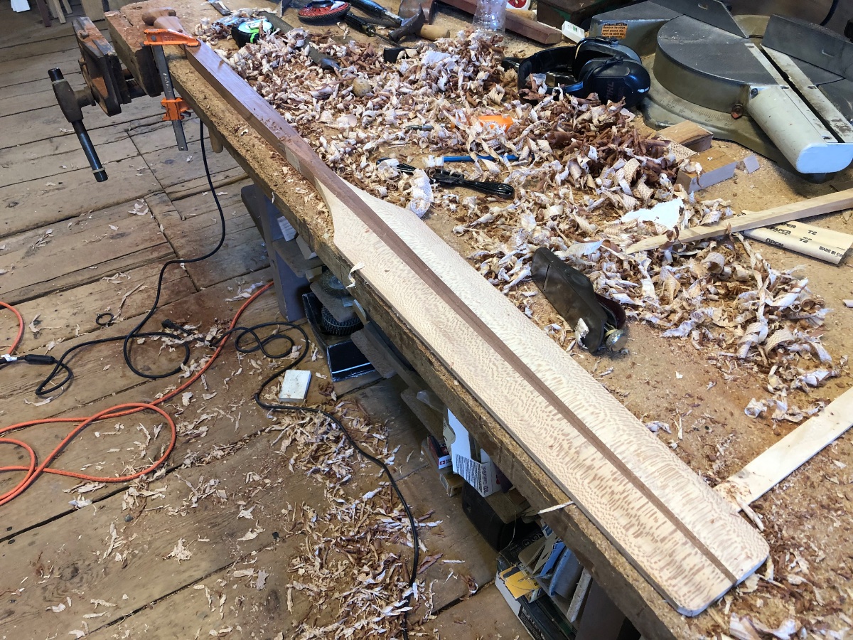

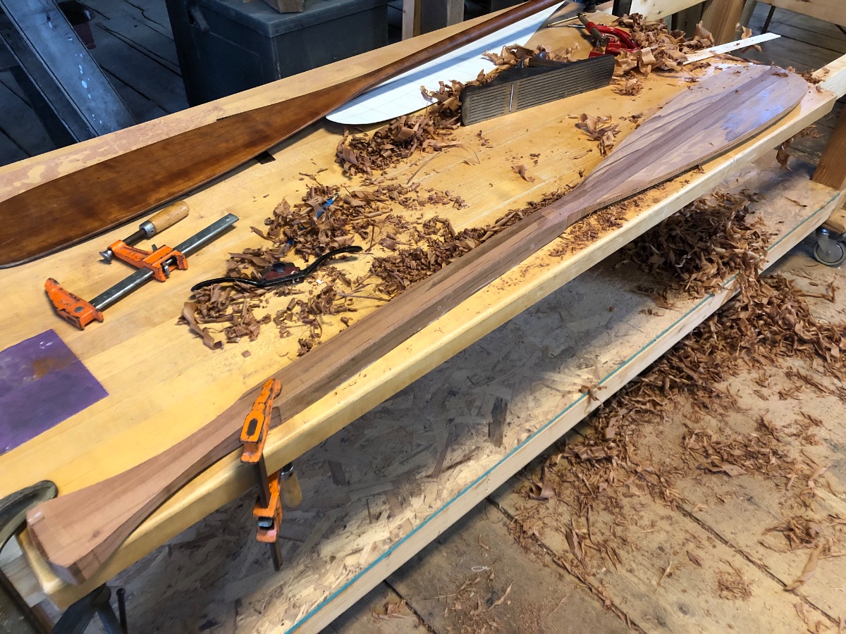

Patrick, Nice shop!. I likes seeing all the wood shavings and the work bench on wheels. The board looks like mahogany to me but whatever it is, you should be able to bend it on the Traveler without steaming. Of course the steaming will make it a little easier to bend and its always fun to have a successful steaming operation. You have to take your victory's where ever you find them!
Thanks Rollin! The shavings are from two fun paddle projects made from scraps in progress: Red Cedar for the beavertail, and red cedar/sycamore for the more radical looking one. I guess you'd call it a modified otter tail?

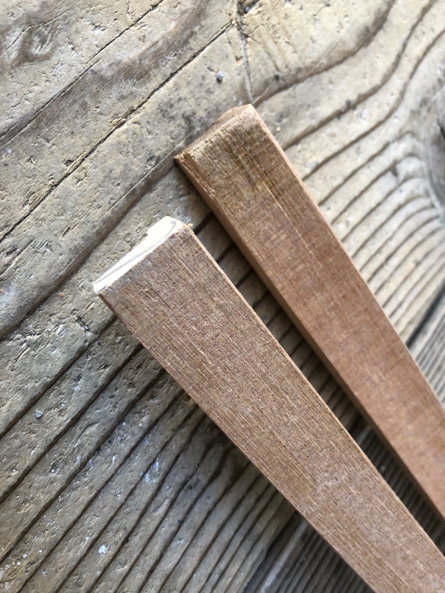

Okay, I dunked the outwales into water for a 4-day soak, steaming them this weekend. I do recognize that these could be applied without steam, but an initial trial suggested that the last 30" or so would be fraught with potential trouble. Besides, my logic (for what that's worth) suggests that steamed outwales once dried in place won't, or are less likely, to harbor tension trying to get back to straight! Maybe they will rest easier on the hull once steamed and dried.

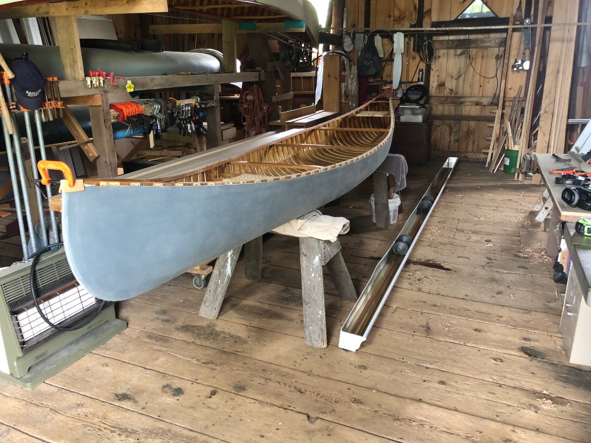

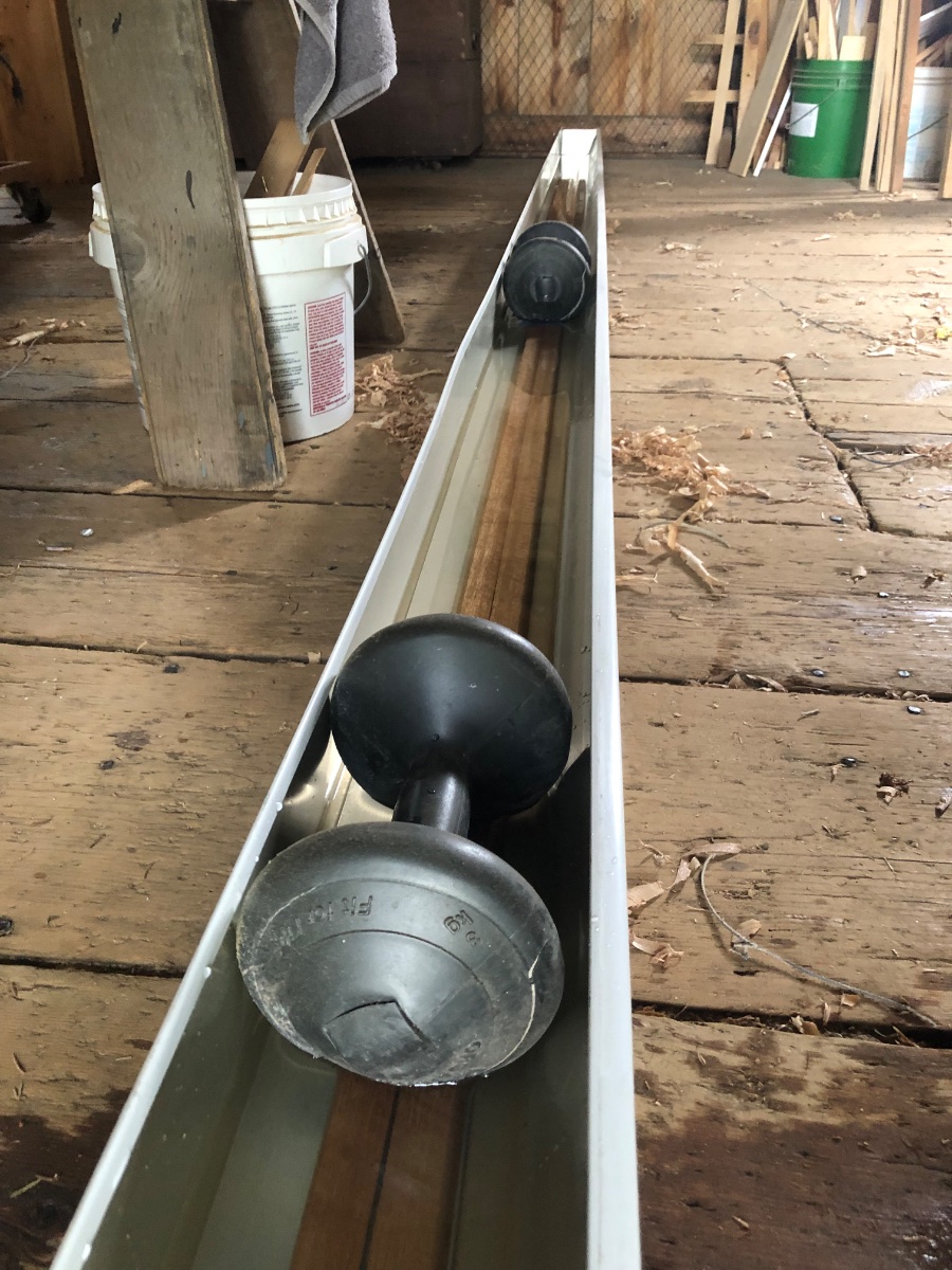

I soak in a closed aluminum gutter 20' long. Just seal up the two end caps and pour in 5 gallons of water. I'll probably use that water for the steamer since it's already up in the barn.
Weighed down with two plastic coated dumbbells.
The water will help for sure and should SET the wood when dried after a couple days. Certainly won't hurt! I use the gutter as well. Generally, I soak for 48 hours before bending using the bag method. I have some rail caps soaking for a Thursday steam currently.

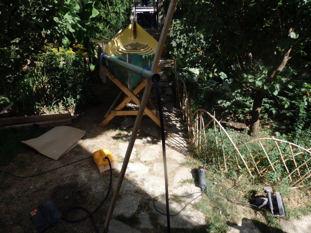

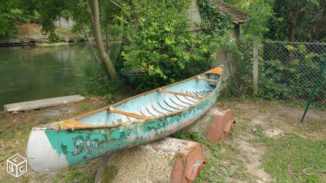

at the first time to bending in 2015 on my alu canoe with fir tree , so I try the same thing from mahogany last year ... mahogany from old stairs ramps too short ... sawed in two ,planed , scarfed , glued ... I begin by the middle , half and half , 8 times in a row
my aluminium chymney is not fixed as you can see , so a cork with a wet laundry and a steam wallpaper stripper , and you progess with temporary screw
sorry no picture from this second renovation , but very easy , with gloves of course , you work , and the steam work with you
I hope you understand how I do ... and you can use the tube for bending with an helping wood pole who do the third hand as you can see

So many screws penetrating the bottom for the outer skid rails and inner strips! Does your canoe leak? Certainly a unique canoe, at least from my experience.
Sometime , when the wood is dry in some scrw holes, but after no problem ... I had put some Blackson for car chassis in the holes

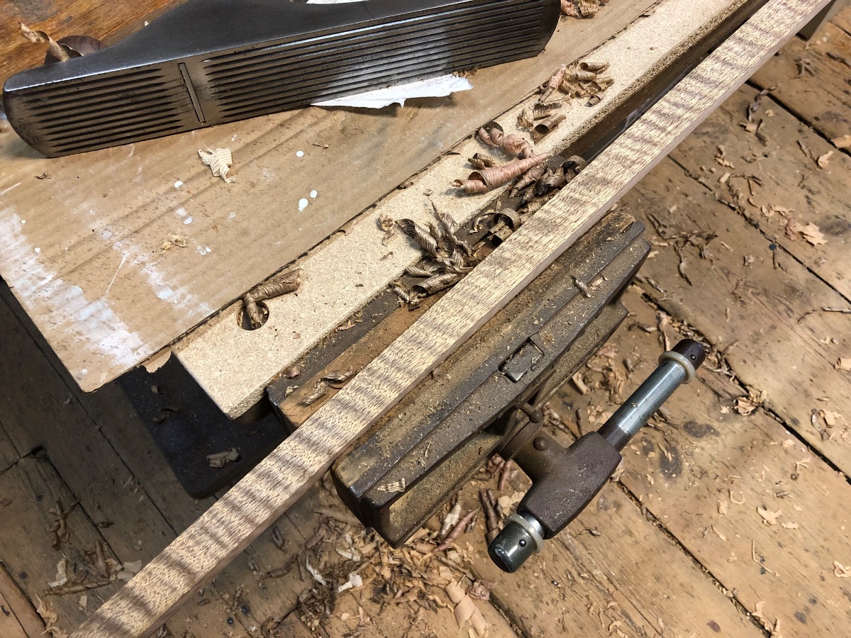

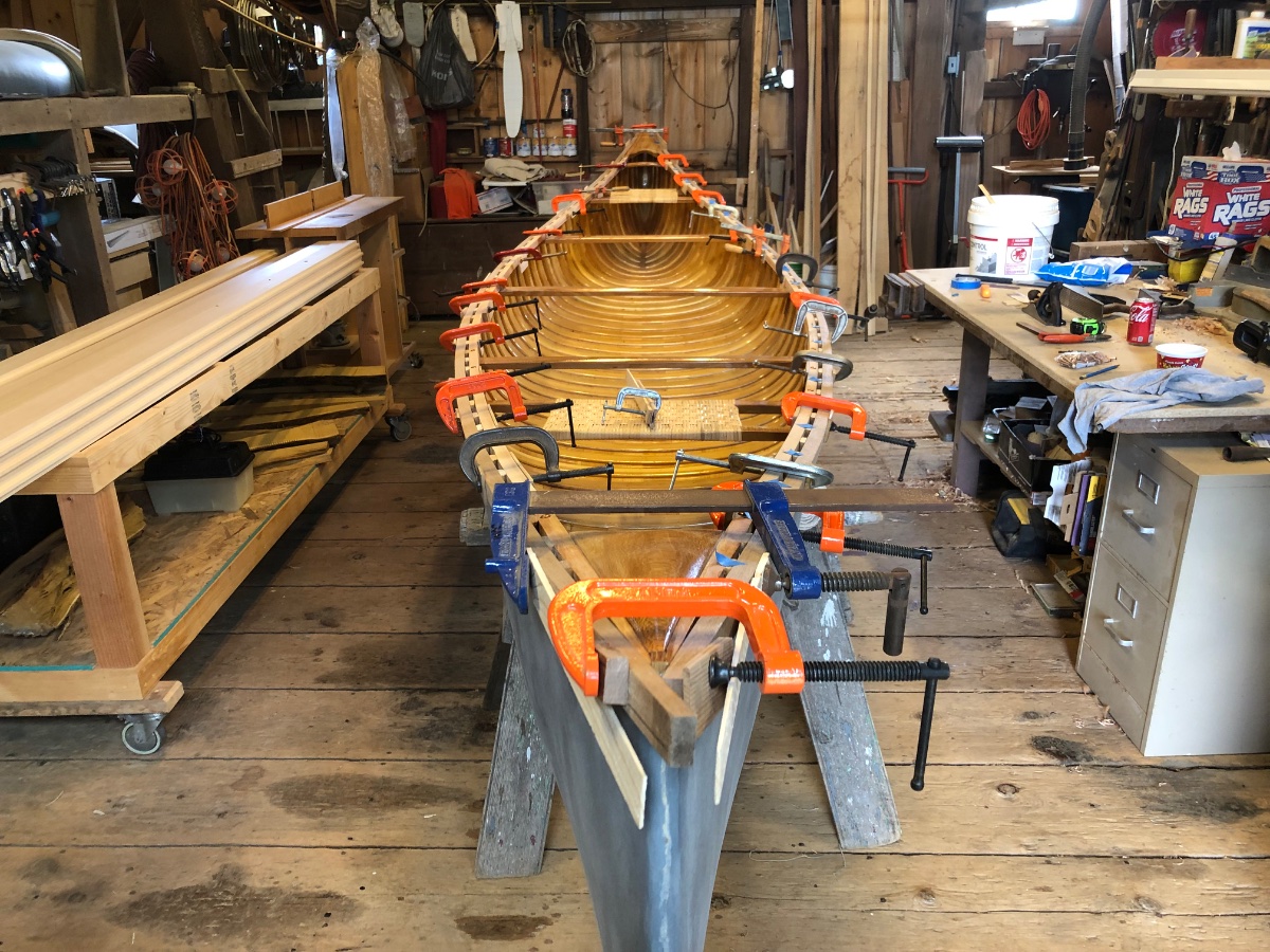

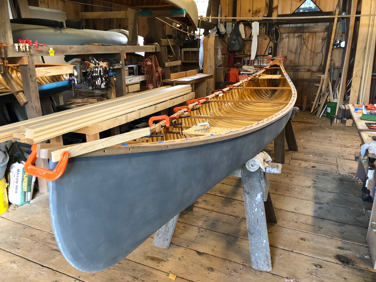

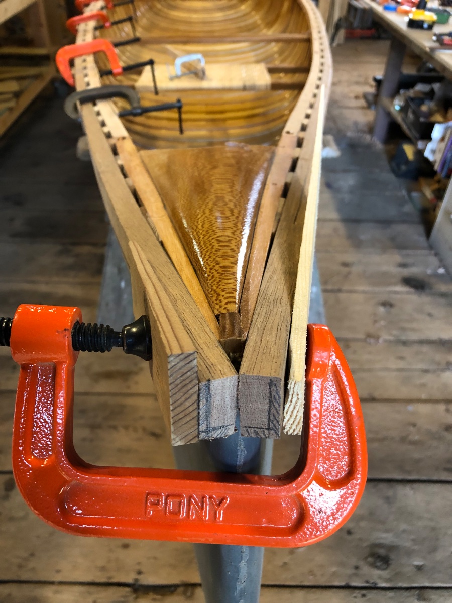

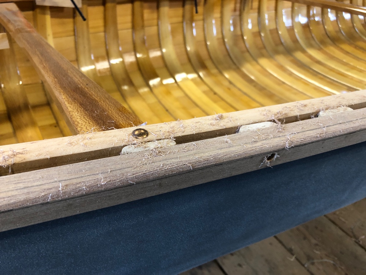

Both outwales successfully bent on, and one side drilled and screwed. I started shaping with block plane, spokeshave and rasp. I typically scribe a top line and a side line to delineate the extent of the round over. The ends of the outwales will be slightly reduced in both height and thickness as they reach the stem stem at the stem band.
This time I tried a wallpaper steamer I found at my local Habitat for Humanity store. 20 bucks, so I couldn't pass it up. It worked... slowly and didn't inflate or create any pressure within the bag. The process was rather uninspiring as opposed to the fiery propane burner and water filled metal can I've used in the past. Much safer for my all-wood barn this time, but none of the drama!
