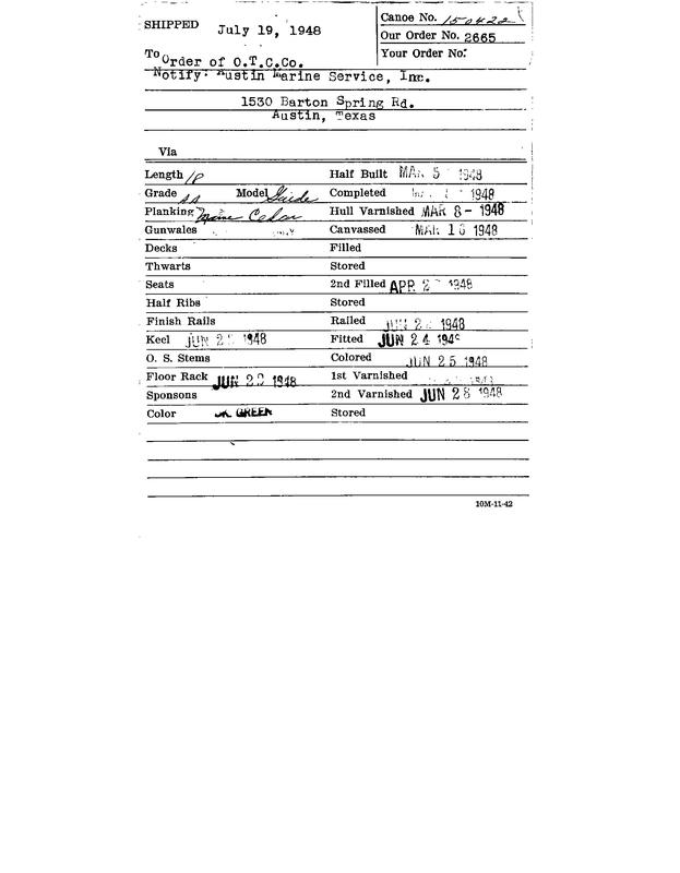

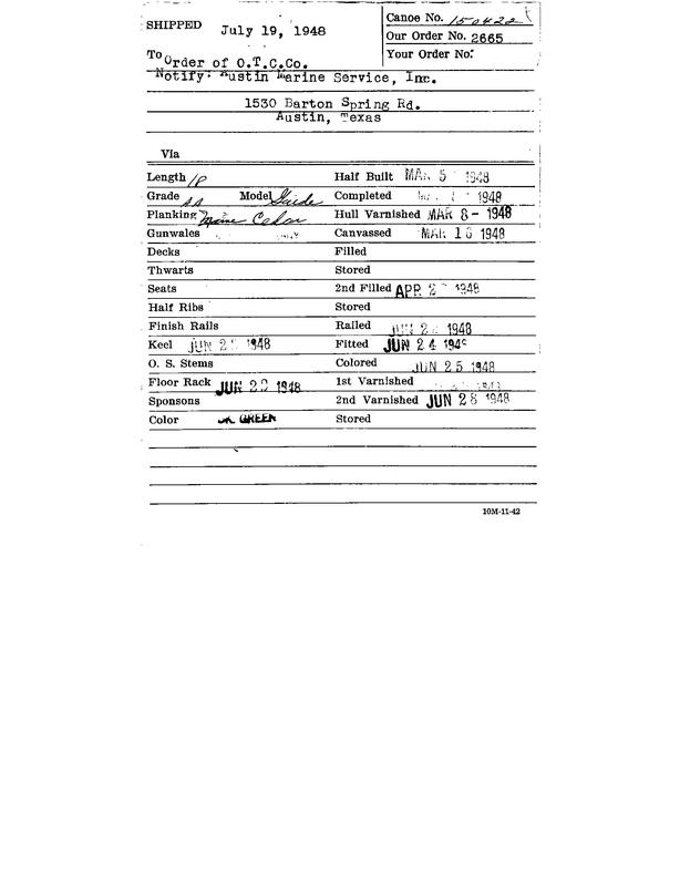

The Old Town canoe with serial number 150422 is an 18 foot long, AA (top or premium) grade guide model with Maine cedar planking; AA grade canoes usually have mahogany gunwales, decks, thwarts, and seats, though this is not specified on the build record; this canoe was equiped with a floor rack and a keel. The canoe was built between March and June 1948. The original exterior paint was dark green. It was shipped to Austin, Texas on July 19, 1948.
A scan of this build record can be found by following the link behind the thumbnail images attached below.
