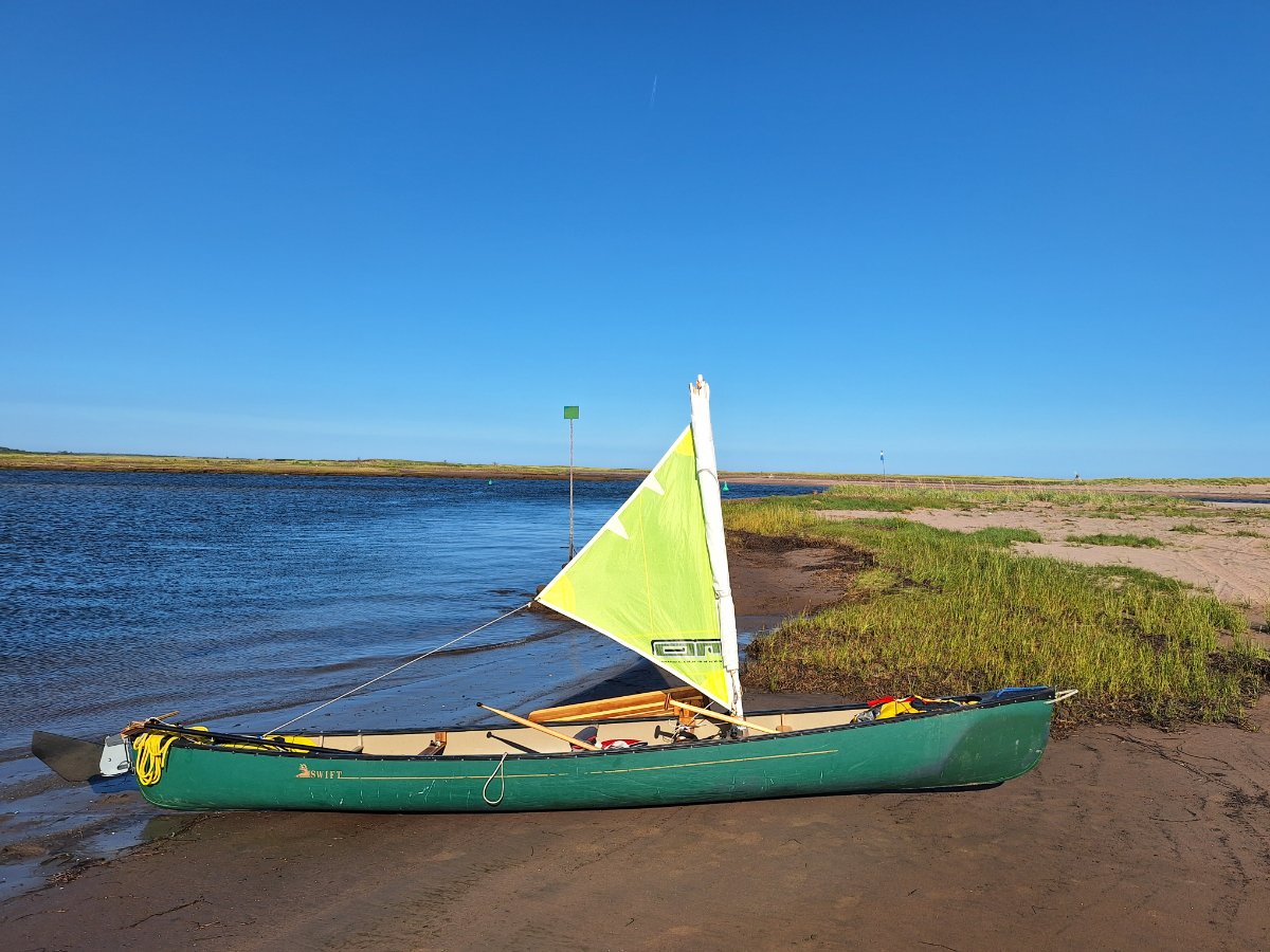

In 2022 I built a four-cornered spritsail kit from Sailrite. I found it on a webpage of options available from Sailrite and this sail seemed to best fit my needs. I cannot remember the details but the kit came from a boat called “JWB” (or something like that). It is about 30Sq. feet in size.
I have used it on a sailing canoe and the kit has worked out well. More recently I built a small jib from an old kitesurfing kite to increase sail area, improve upwind performance and help with tacking. This small sail has done all of the aforementioned.

Do you have any thoughts on a new sail that might be suitable for my requirements? I have attached a photo so you can get a better picture of my boat and its rig. (Sorry it's sideways and I don not know how to straighten it.)

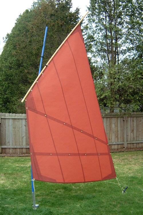

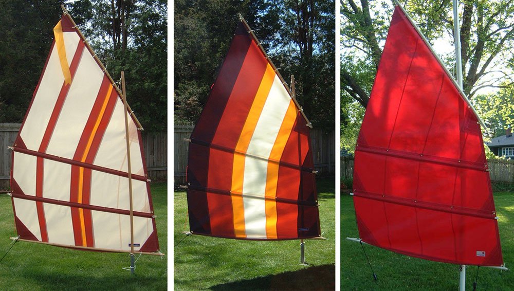

The most common quickly reefable canoe sails that I built over the years for customers were battened balanced lugs. like these. Having the battens at the reef lines was the fastest and most orderly way to reef, though the ability to do it out on the water in a blow can be questionable. If you have enough extra mast up high you could probably rig it with a jib, but it may or may not be worth the extra hassle.

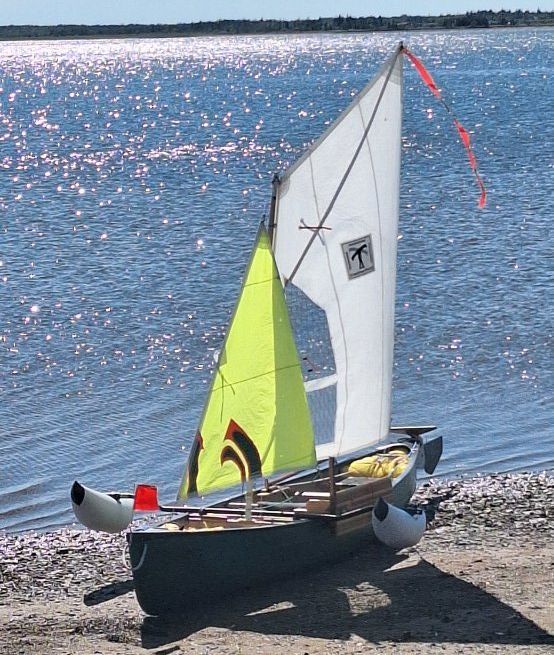

4) A split rig strikes me as heading in the wrong direction with respect to close windedness. though I agree that they offer lots of flexibility. I do a similar thing with my jib which can be used as a storm sail (see photo). This shortening of sail must be done on land though and I'd like to be able to reduce sail while underway.

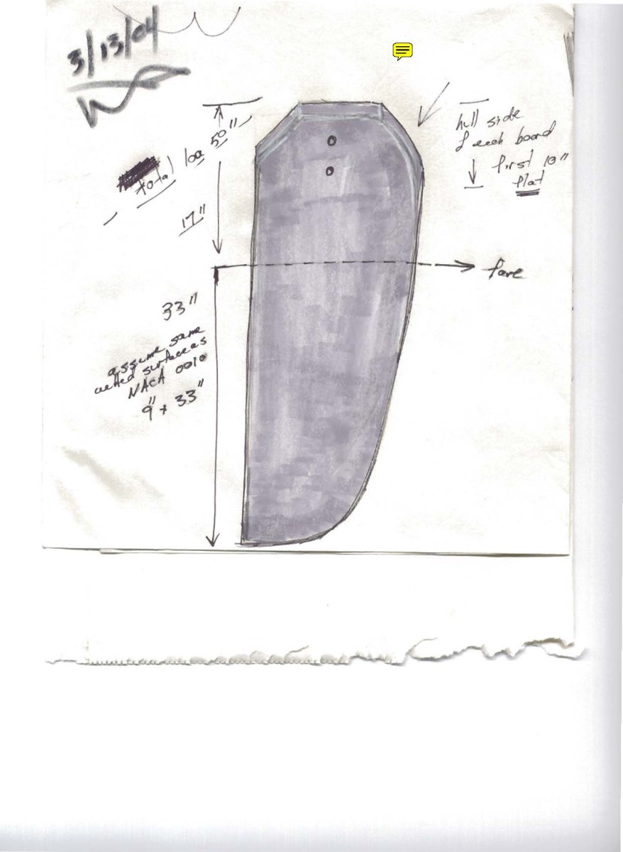

The rig/sail is just half of the upwind equation. The other half is underwater. I think my leeboard is a little too low aspect. It's about 11 inches wide. I built it this way to help reduce stalling following a tack but maybe it's too wide for optimal upwind performance. (My kite hydrofoil mast is only 5 to 6 inches wide and it goes upwind like a demon)
My leeboard is a NACA cross-section airfoil so this is not likely an issue. What do folks feel are good parameters for chord width and draft for a canoe leeboard? Also do you find that the boat performs less well when the "leeboard" is on the windward side of the boat? I really don't want to go the two leeboard route - too much additional weight, stuff to fiddle with etc.

Picture #1 - Jib used as a storm sail

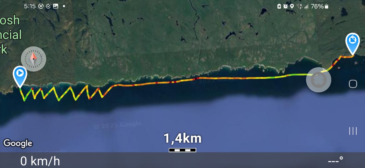

Picture #2 - A typical track. Upwind at first followed by a 180 degree wind shift. Note the tacking angle - I'd like to tighten those "Z's" a bit...

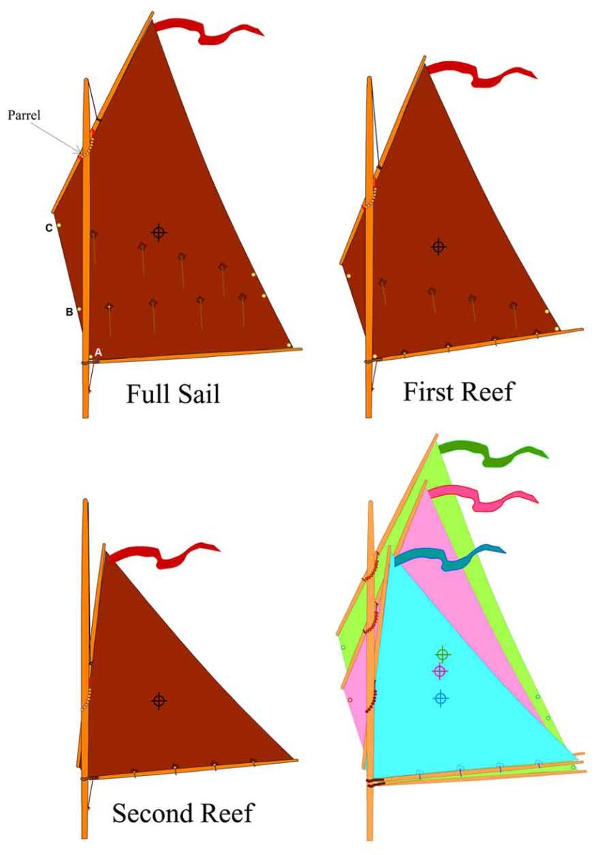

One thing to keep in mind about standing lugsails has to do with putting in a dep reef, like a second or third reef. Since in any case, the reef's tack ring (which when unreefed used to be out in space ahead of the mast) must be brought back to the mast to be put to work as the new tack corner. This action will tend to raise the heel of the yard and boom and often the only way to correct this is to untie the halyard and move its tie-on point on the yard to a different spot, leveling out the yard again. However, not only is this a pain in the butt and probably best done on shore, at the same time, it changes the CE vs CLP helm balance equation and probably not for the better.
You can usually get by OK with a single, first reef as the shift isn't that dramatic, but a second and deeper reef will likely screw up your handling. So, if you want to be able to deep reef without needing to move the halyard attachment point on the yard, and without changing the fore and aft relationship of the sail's center of effort and the hull's center of lateral plane you will need to change the angle of that upper reef line, similar to this.
I think you could tack a jib across the yard of most standing lugs as long as it isn't under tension at the time.

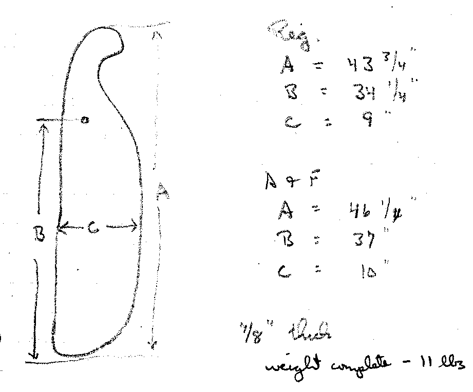

The image at https://forums.wcha.org/attachments/1065/ shows the basic dimensions for the standard Old Town leeboards along with the slightly oversized ones requested by Abercrombie & Fitch. These and the older shallow water versions show up regularly on eBay. I don't know of anyone who has really researched the optimum hydrodynamic shape for a canoe leeboard or the performance differences between a windward or leeward mounting position. I suspect that improvements with the sail rig are more likely to generate noticeable results (unless you plan to experiment with foils). Good luck,

There is little difference in terms of lateral resistance. Either can do a great job of keeping the canoe from sliding sideways. A sixteen pound bronze centerboard offers wonderful stability when hanging down below the waterline. The ability to easily adjust a leeboard's position makes it simple to improve the sail balance. Each comes with their own assortment of strengths and weaknesses so a general comparison is not very meaningful. Sorry,
