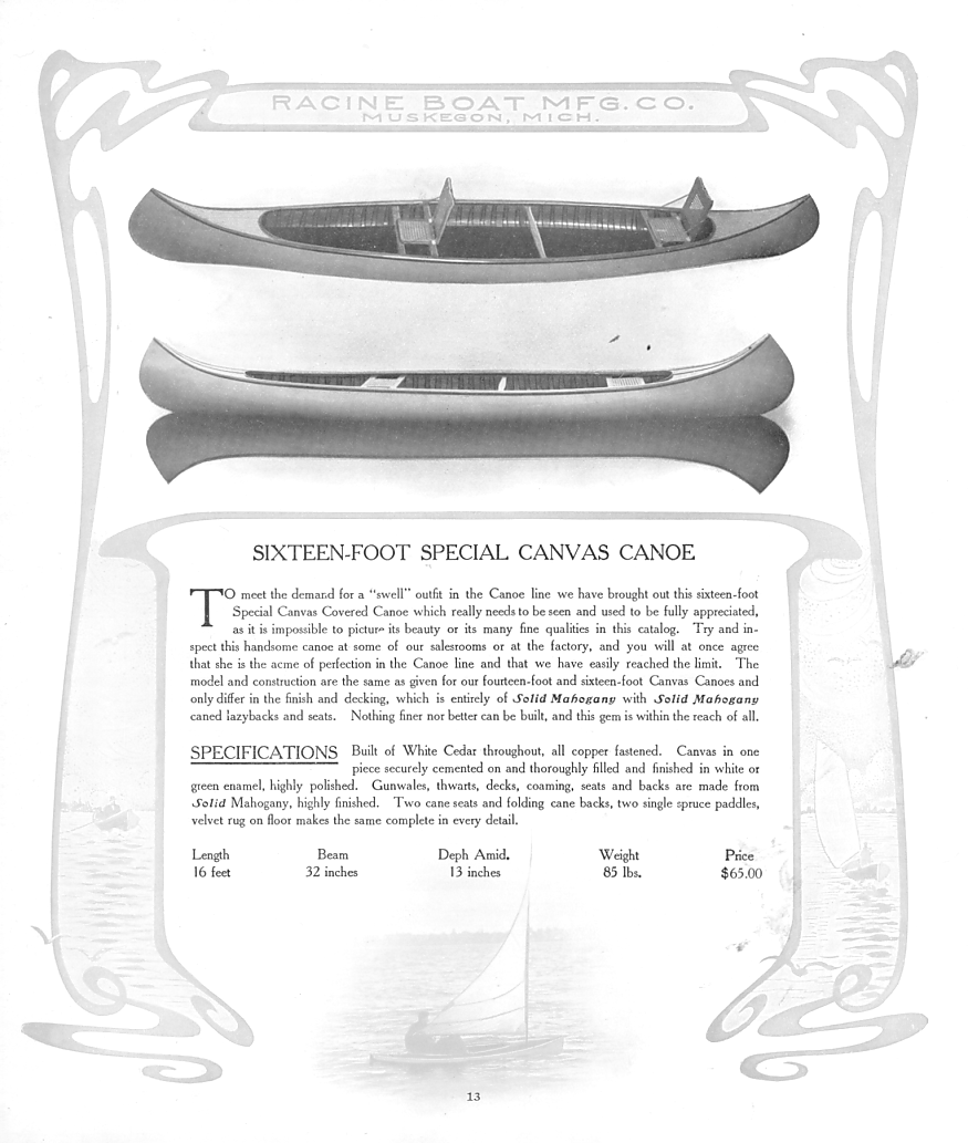

There were a variety of Racine builders who made canoes including the Racine Boat Company, Racine Boat Manufacturing Company, Racine Hardware Manufacturing, Racine Yacht & Boat Works, and others. Their building styles were not all the same and I haven't gotten all their catalogs loaded into my searchable database yet. The Racine Boat Manufacturing Company catalogs from the first few years after 1900 include the “ironed into shellac” description. This was changed in 1905 to say "Canvas in one piece securely cemented on and thoroughly filled and finished in white or green enamel" as shown below. It appears that they may have been using shellac (and heat) to adhere the canvas to the wood. This is different from the Maine canoes where shellac was used on the outside of the canvas below the water line. Let me know if you have other questions. Thanks,

I should have specified what Racine I was talking about
I’ve wondered about that ironed into shellac description, I don’t know when my RBMCo boat is from, but the canvas is not adhered to the boat and I don’t see shellac remains in the hull outside. The filler of the canvas seems very smooth, not sure how to describe it, still pliable more than an original OT canvas. I think it is original to the canoe.

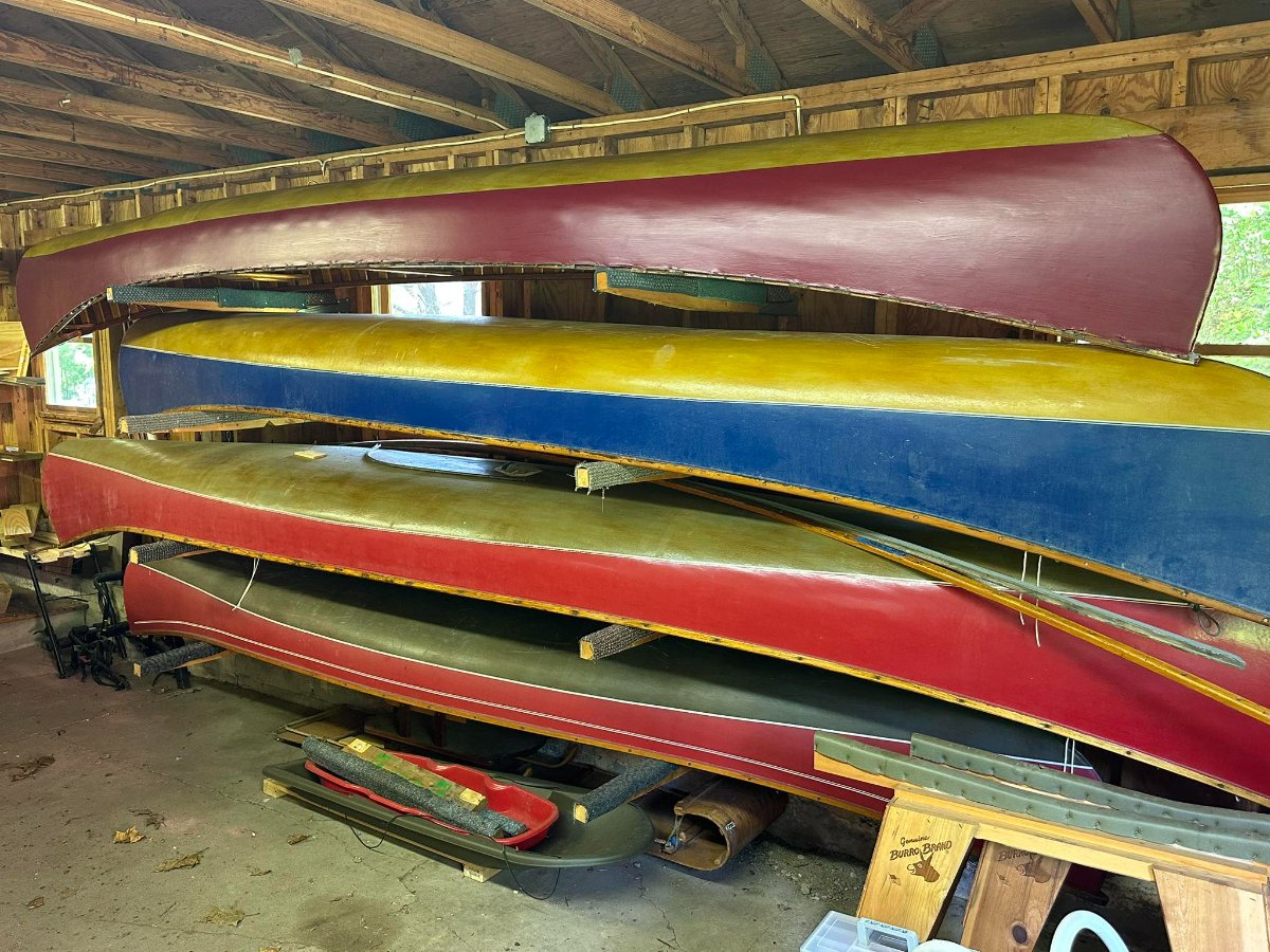

The stable/rack of canoes used by Maine Guide David Lewis
