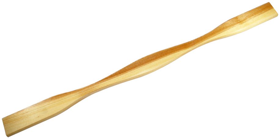

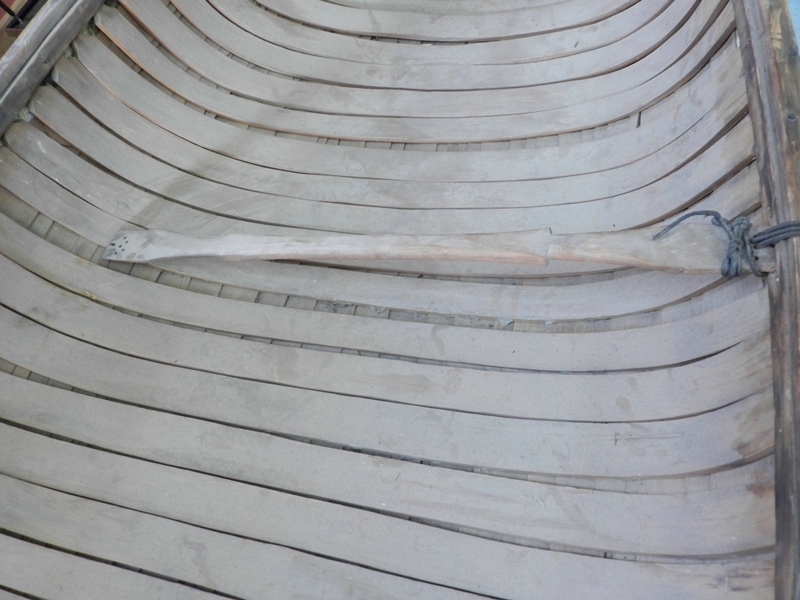

It may be impossible to avoid the C7 pain with the "traditionally-shaped centre thwart" shape that you describe, i.e. the widest part of the thwart is in the center.
1198_1198_1
The irony is the the shape isn't all that traditional. The whole carry bar & paddle system evolved from usage with birchbark canoes. If you look at early photos or existent samples, bark canoes nearly always had either a straight shaped thwart or one that was shaped to have the narrowest part in the middle with widening ends and notches for the tumpline. Below is an example from a circa 1910 bark canoe that was on display at the 2019 Temagami Canoe festival...
Many more similar examples found on canoes at the Canadian Canoe Museum. I believe modern builders like Steve Cayard and Henri Vaillancourt also design their centre thwarts like this.
I carved out this design for my bark canoe build and it made short carries (i.e. without strapping in paddles) much more manageable. That gradual narrowing towards the middle helped to clear the problem areas of the neck.
