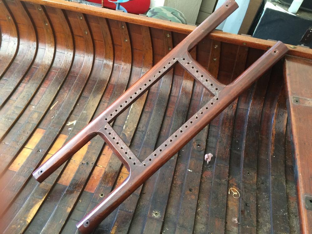

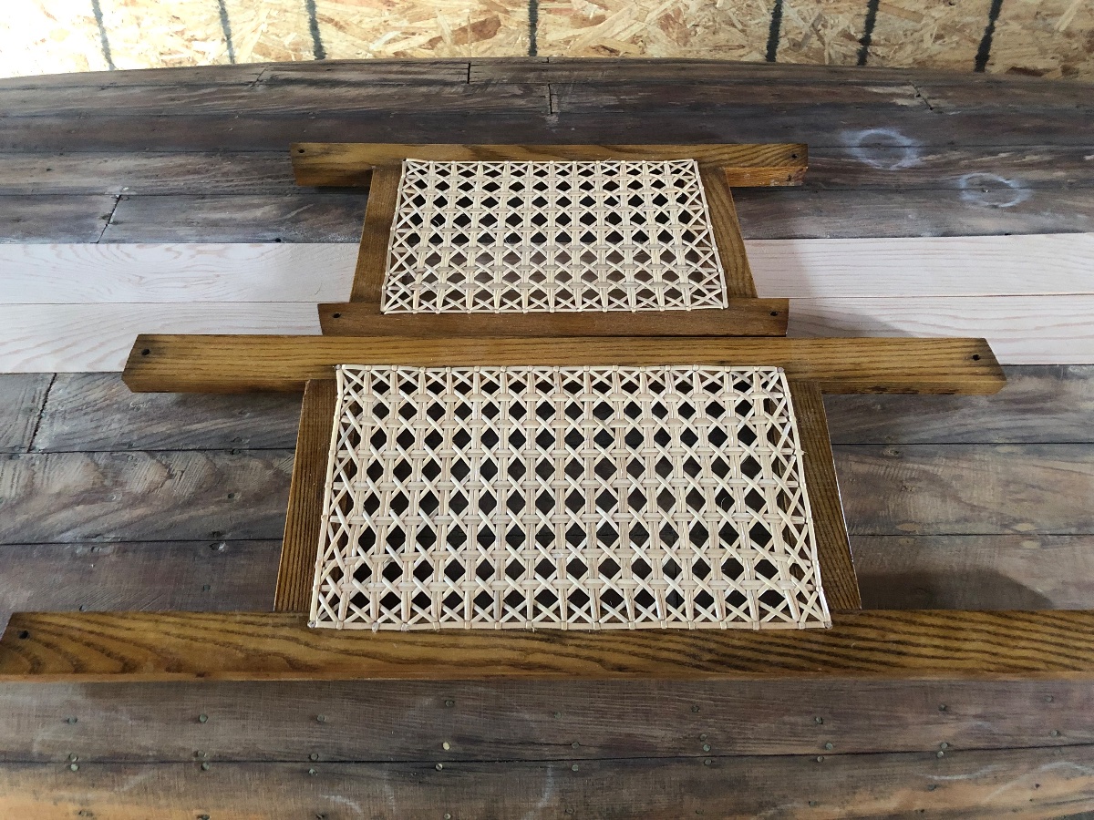

Is there a period correct treatment for the frame members on a 1938 era Old Town Canoe seat? I have made the frames from air-dried Ash (noted as the species on the original build sheet) but I'm unsure about the treatment of the corners of the frame components. Leave 'em square, small round over, larger radius round over, chamfer? I have made them square for Chestnuts,

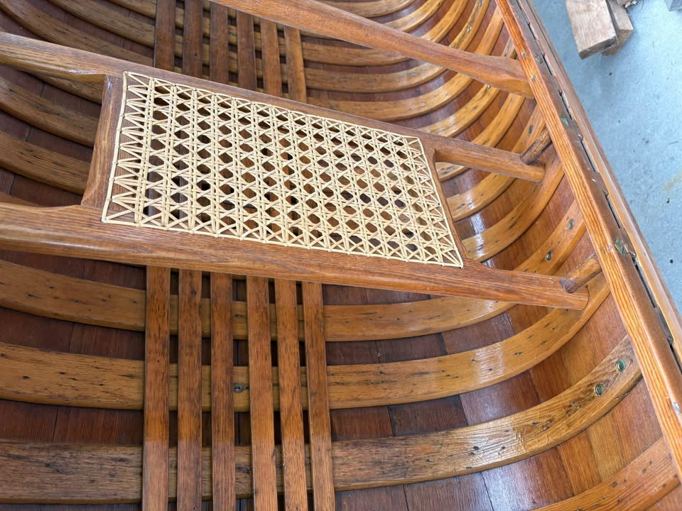

and here a solo seat for my Island Falls Willow which has a stopped round over shown here:
Or... is this larger round over posted by Dave Osborn in a 2016 post more appropriate?

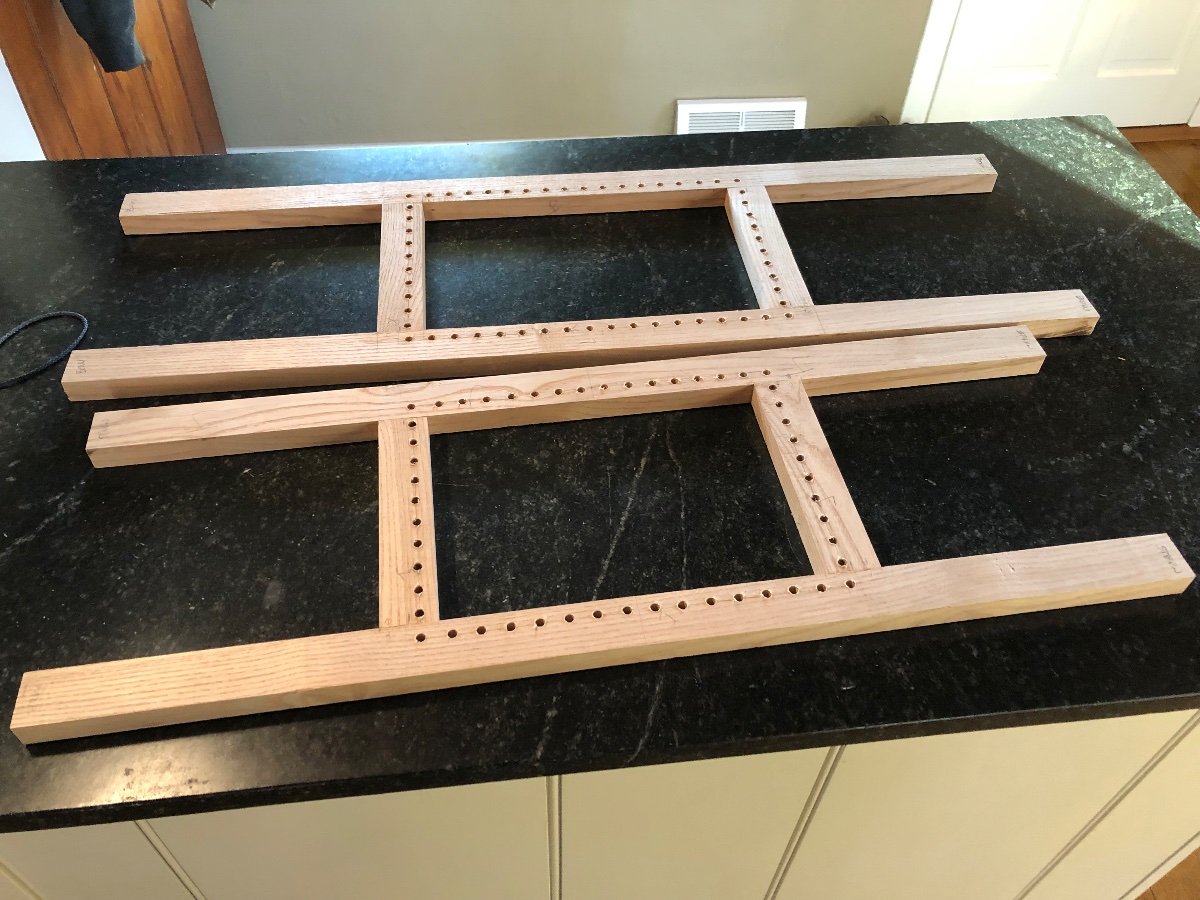

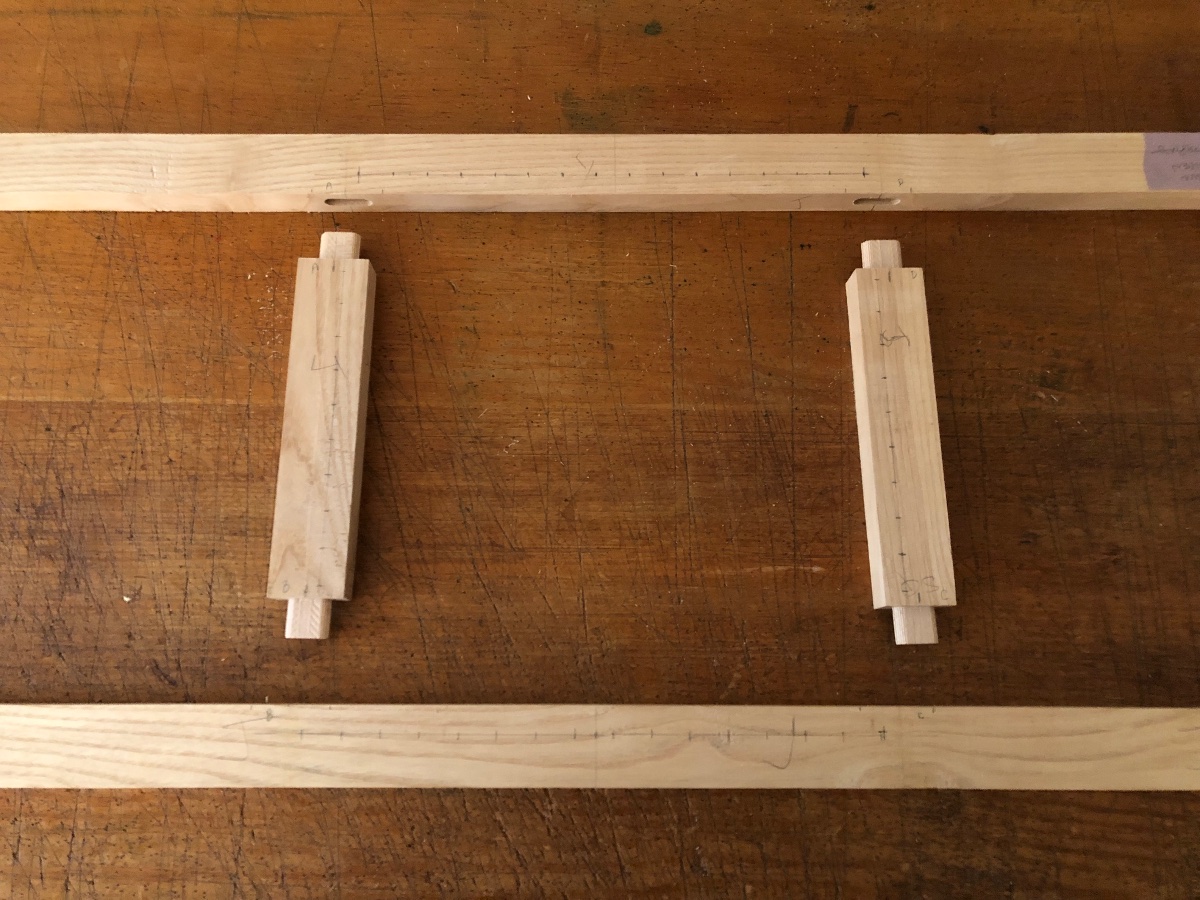

Here are the frames; still to be sanded prior to final detail. By the way, I chose to join the rails & spreaders with loose tenons using a Festool domino tool which worked quite well!
I would encourage you to round them like Dave's picture. The image below shows the the Old Town canoe seat from serial number 125927 which is slightly less than your serial number.
Yep, just like the seat in the image from Dave Osborne - appropriate throughout that time period. Note that sometimes they had corner holes and sometimes not, so either way is fine.

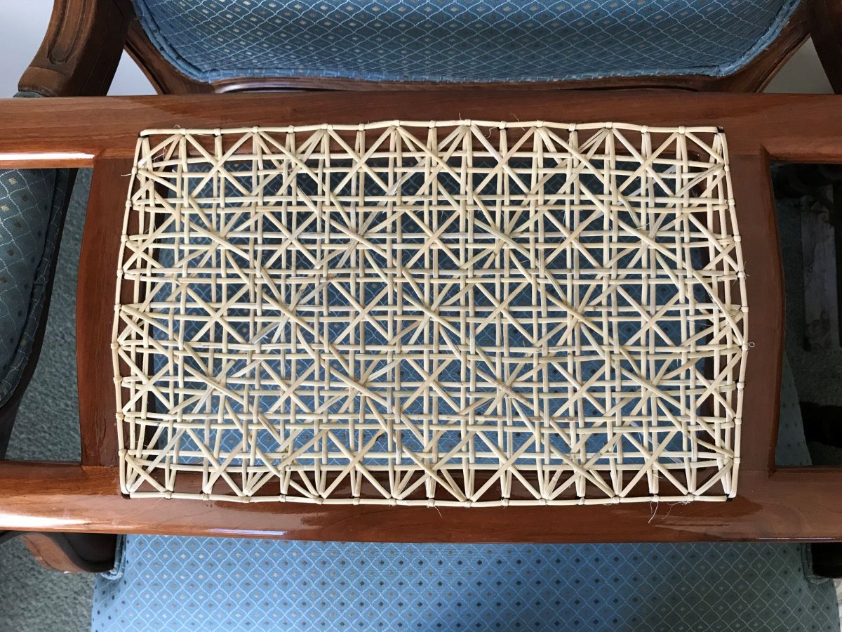

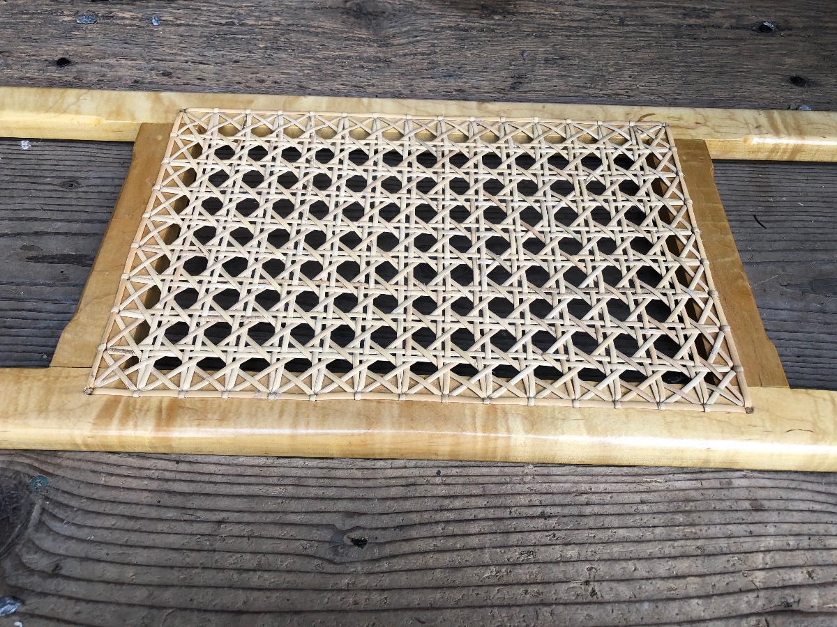

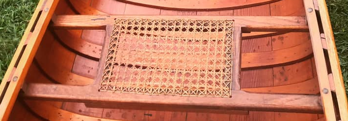

Yes, I did notice this on the pictured frame. On a purely aesthetic note, the lack of a corner hole appears out of character with the right angle of the frame. Without the corner hole the cane must make a 45° angle across the 90° corner. Also, without the corner hole the pattern lacks the two converging diagonal canes pictured in my first two pictures. I did say aesthetics.... or maybe I should have said "obsession with minutiae"?
Your first picture caning pattern is impressive!
Thank you Todd. The pattern in the first picture is that used by the Chestnut Canoe Co. of Canada. It's remarkably similar to the second picture, but differs only in that the vertical and horizontal strands do not "weave" at their intersections. Other than that the process is the same and perhaps takes less time. Digging deeper into the weeds, I think but I'm not sure, that the Peterborough Canoe Co. used a similar pattern except that the diagonals crossed over the verticals and under the horizontals rather than the way Chestnut did it. Maybe this is true, and maybe I made it up.... I can't remember all my lies!!

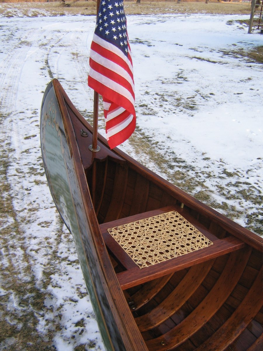

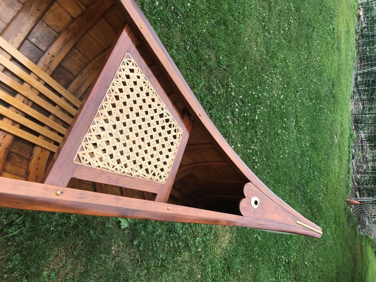

The first and second pictures show a variation on one of the patterns in Patrick’s first post. I believe it’s called the Diamond Pattern. The difference being that there are two diagonal strands going each direction rather than just one. In doing this pattern you must pull both diagonal cane strands through at the same time. You can’t do one strand and then try to pull the second one through – it doesn’t work. This pattern makes for a stronger seat because there are eight cane strands running across the seat as opposed to six. The first picture is a Morris the second is the stern seat on my Rushton. When you have a non-rectangular seat, like the Rushton, you have to plan ahead a little so the pattern lines up on the correct holes. I should also add that when you start the first diagonal strand that you run it through the correct hole on the opposite frame. Count the holes back to the corner and make sure they are the same number.

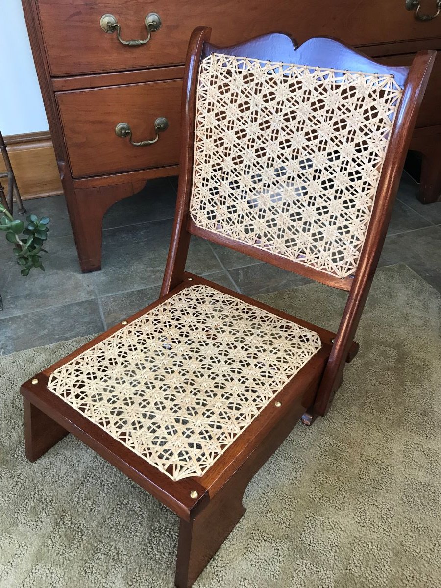

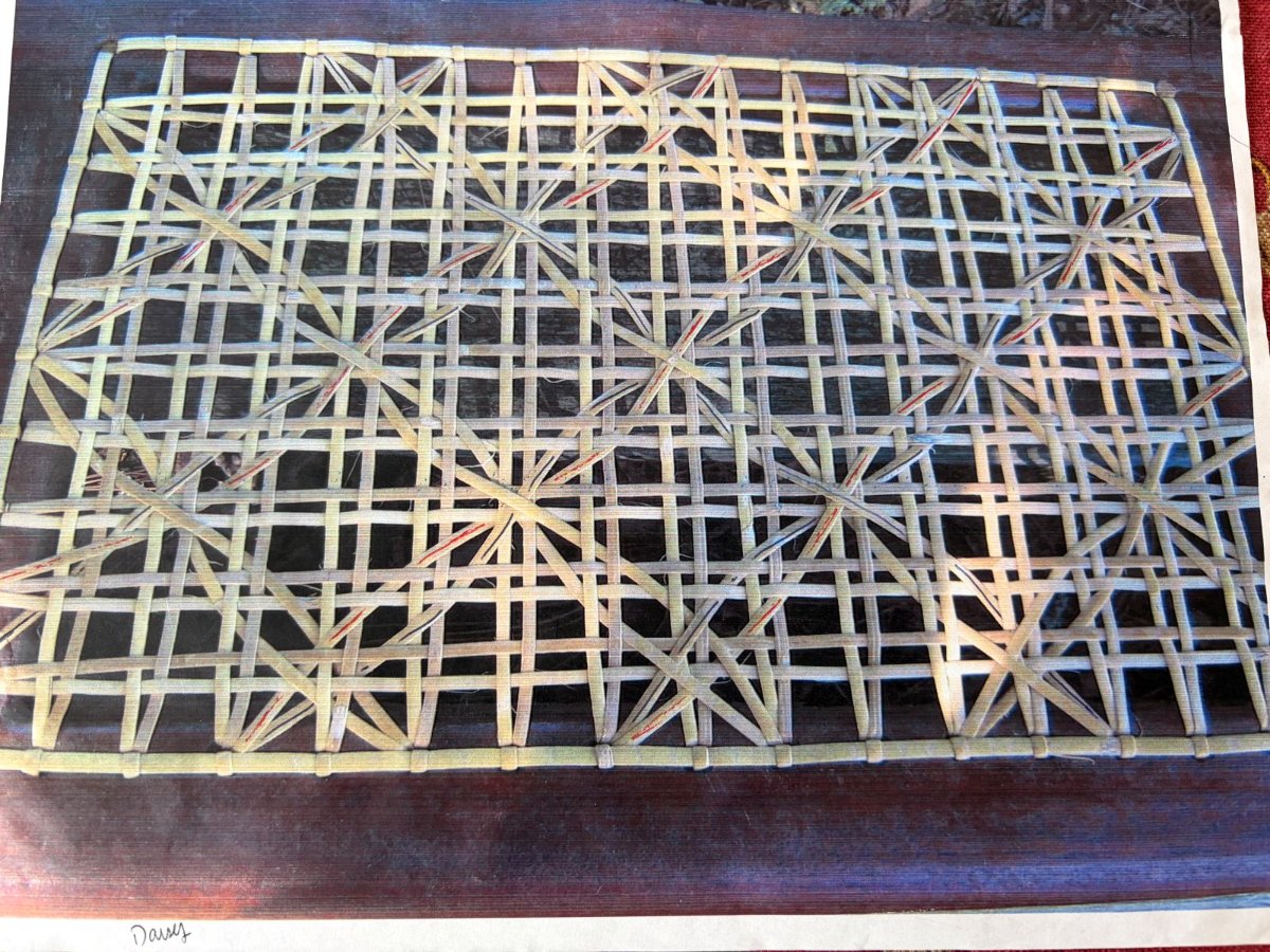

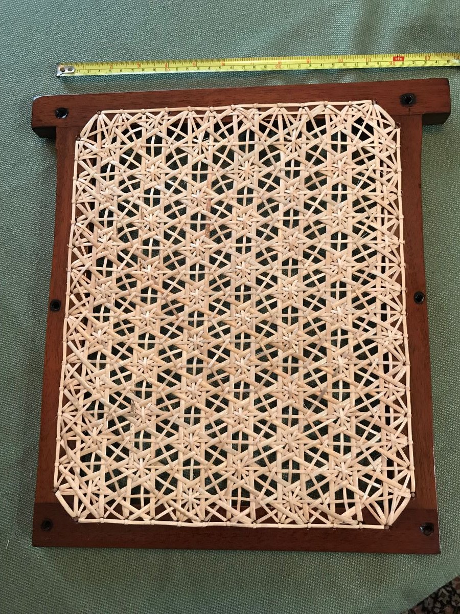

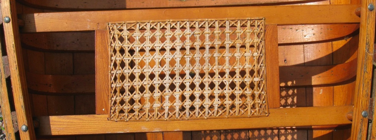

The third picture is of the seat in my Crandell, the fourth is from my Detroit 15. I did the Daisey Pattern. With this pattern you have to be mindful of the number of holes in the frame. You need an odd number of holes (not counting the corner holes) in both directions of the frame otherwise the completed pattern will not be centered on the seat. With an existing canoe seat frame you are stuck with the number of holes provided so avoid this pattern unless you don’t care that the pattern ends up one hole off center. On my Crandell you can see that the pattern on this seat is off center. The bow seat is correct. The casual observer will never notice but people like us will.

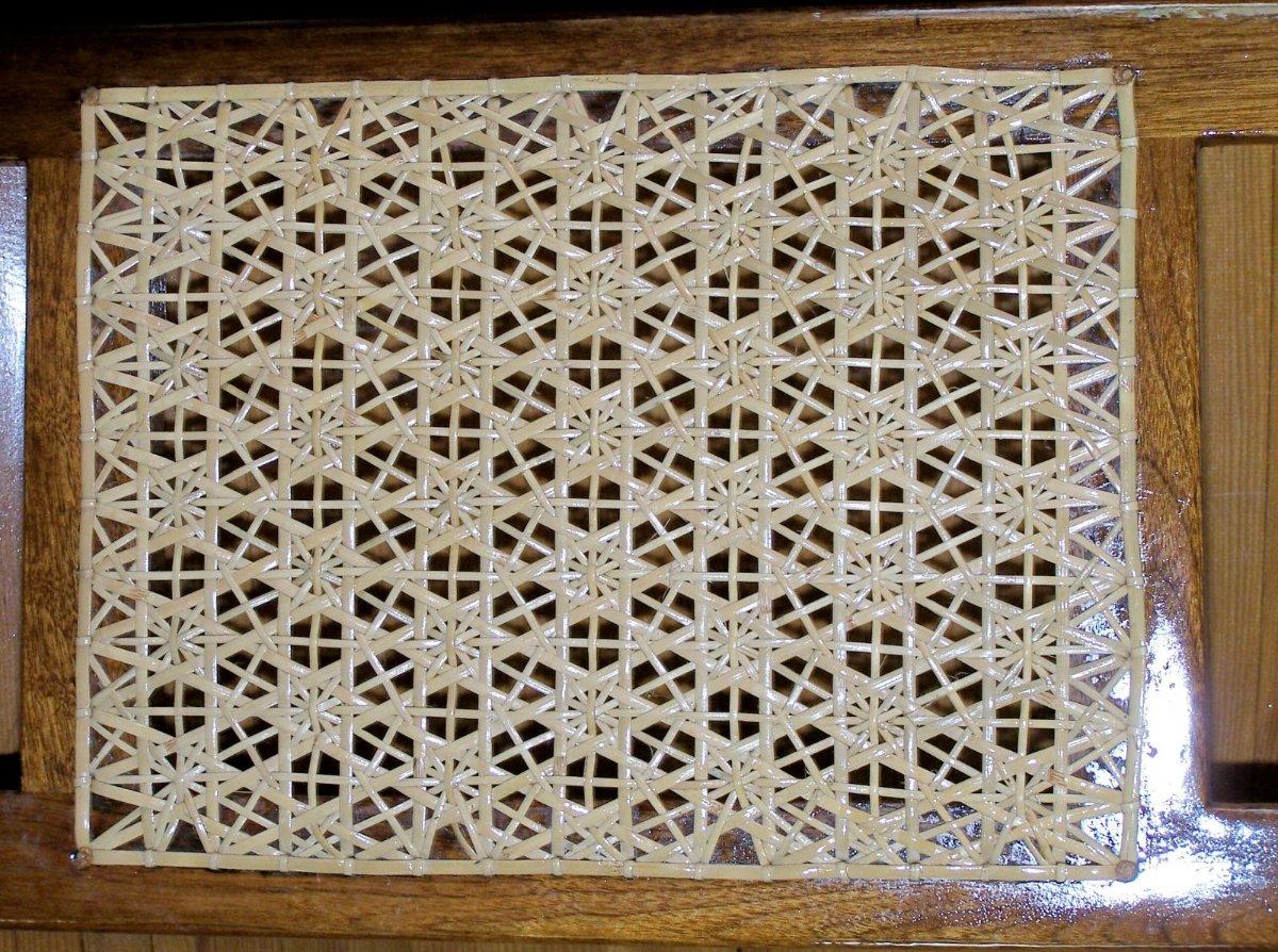

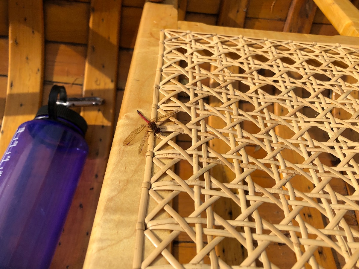

Pictures 5 and 6 show the Star pattern. I did this pattern on an E.M. White folding canoe seat. This pattern works best when you have a bigger area to cane. The caned area of a canoe seat is not really big enough to show off this pattern well but it does work on a standard canoe seat. Picture seven is a seat done by Jean Bratton that shows the weave well. This is a difficult pattern to do. It uses two different size cane strands and it’s easy to mess it up. This pattern requires an even number of holes on both sides of the frame, not counting the corner holes. My seat originally had the old standard seven step cane pattern that is seen all the time. I wanted to try the Star pattern. My mistake was not realizing that the existing holes needed to be bigger to accommodate the increased number and size of the strands going through each one. It added to the difficulty. Next time I’ll drill out the holes a little.

So far none of the canoes I own and have restored, or the one I built from scratch, are historic or unique, so I have chosen to use patterns which are appropriate mostly in my own mind. For example, I made a seat for my Island Falls Willow canoe which when I acquired it had no seat at all- just a kneeling thwart. Since it's an adaptation of an E.M.White design and therefore of American origin, I chose not to use the Chestnut or Peterborough patterns (which I like very much) because they were used by Canadian builders. That's not to say I couldn't.... I just chose not to.

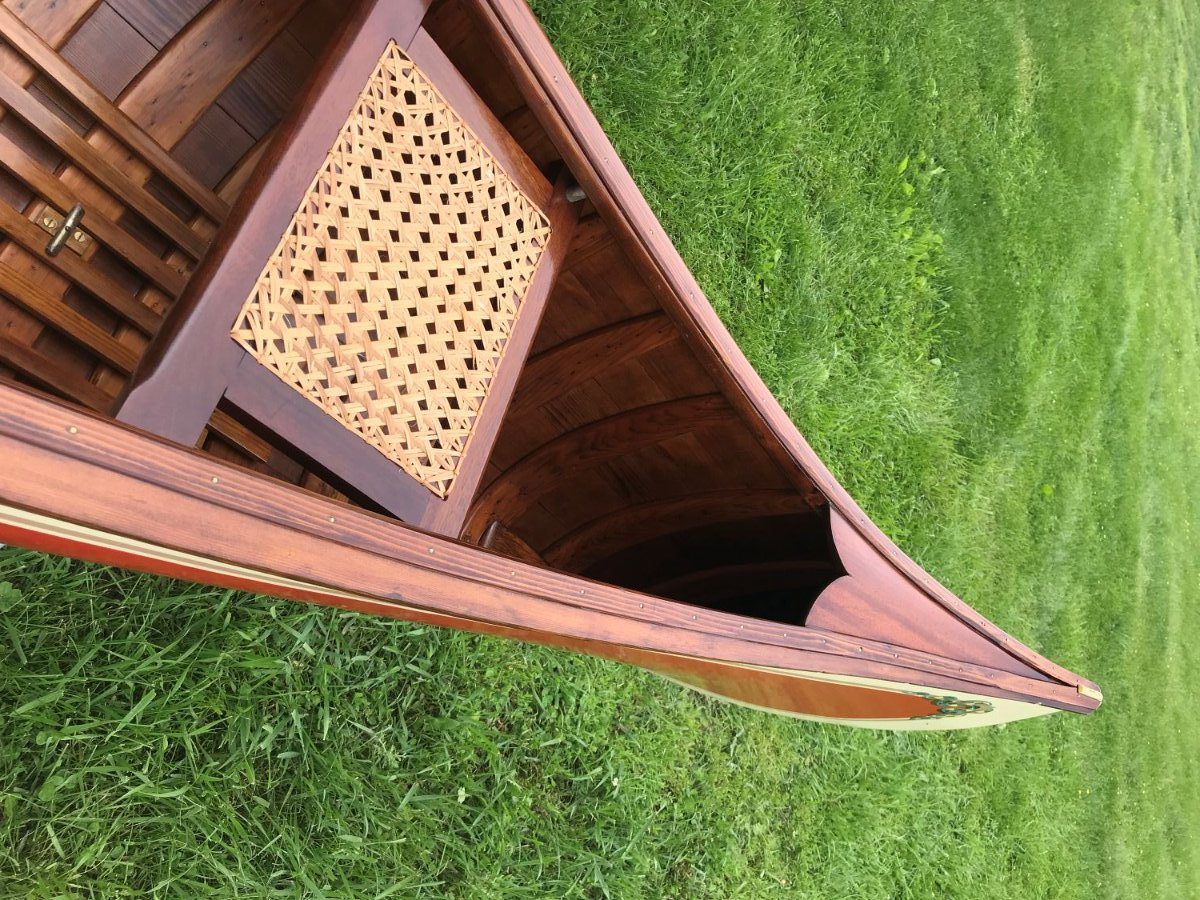

Just for fun, here's my Willow seat with my lunch companion admiring the cane pattern while I was paddling in the Whitney Wilderness in the Adirondacks.
