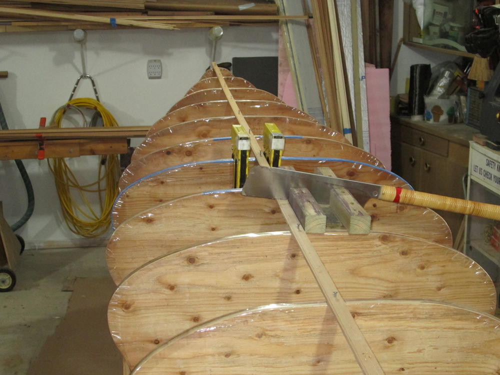

After hashing over, what to build, I settled on a canoe I designed, and cut the forms for in March of 2000. I've not built this one before.
I named it after a lake here, in town, Nokomis.
Here's a few pics. IMG_0568_zpsmwdikbez.jpgIMG_0576_zpslvumybw5.jpgIMG_0580_zpstbyvrf1p.jpg
It will be 16'4" long and a solo. Plenty of tumblehome, flat bottomed, with a little flare.
