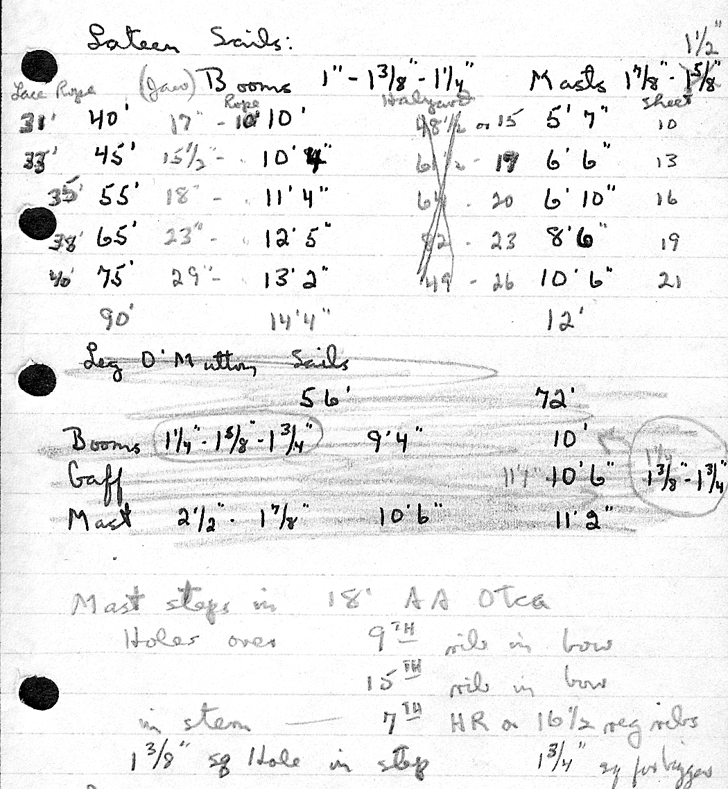

Just got a call from the fella who owns the canoe. Turns out the canoe didn't come with the sail hardware! So I don't know what diameter to make the hole in the fixture! I'm guessing the mast is 1.5" dia. Can somebody please measure the internal diameter of the mast ring on their canoe? Or failing that, the diameter of the mast. To at least 2 decmal points. Thanks!
There are five mast rings on the Old Town canoes in my garage ranging from 1927 to 1958. They all appear to have about a two inch inside diameter. (I don't own a micrometer.) The factory notes at https://forums.wcha.org/attachments/1068/ indicate that the mast diameters ranged from one and 1/2 inches to one and 7/8 inches. Most of the ones in my garage are about one and 3/4 inches in diameter. Let me know if this and the picture below don't answer your question.
