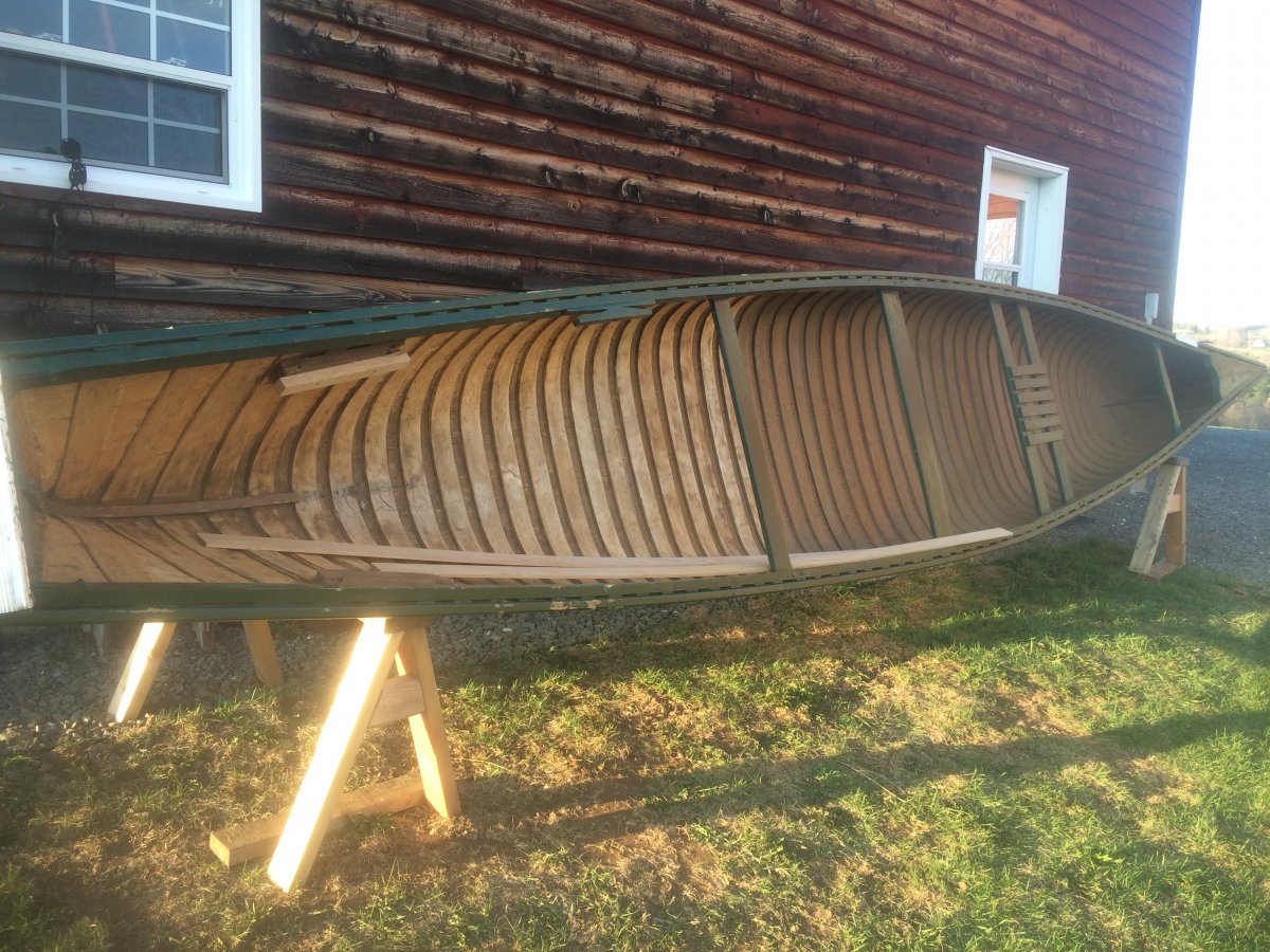

i just bought my first canoe, its a 22 foot miller.
its purpose will be a salmon fishing canoe, functionality and reliability over heritage.
inside has a couple coats of brown paint over varnish. i am sanding down to bare wood.
it has some broken ribs, which i will sister with half ribs and epoxy to gain strength
the ribs and planking seems typical old, somewhat dry, but all there.
will linseed oil add life to the inside ribs and planking ? or should i go straight to a couple layers of epoxy?
the outside has 1 layer of fiberglass with some paint, i will be removing paint and adding 2 layers of 10oz cloth with a few layers of epoxy.
purpose is to make this baby strong and reliable. weight is not an issue nor are looks.

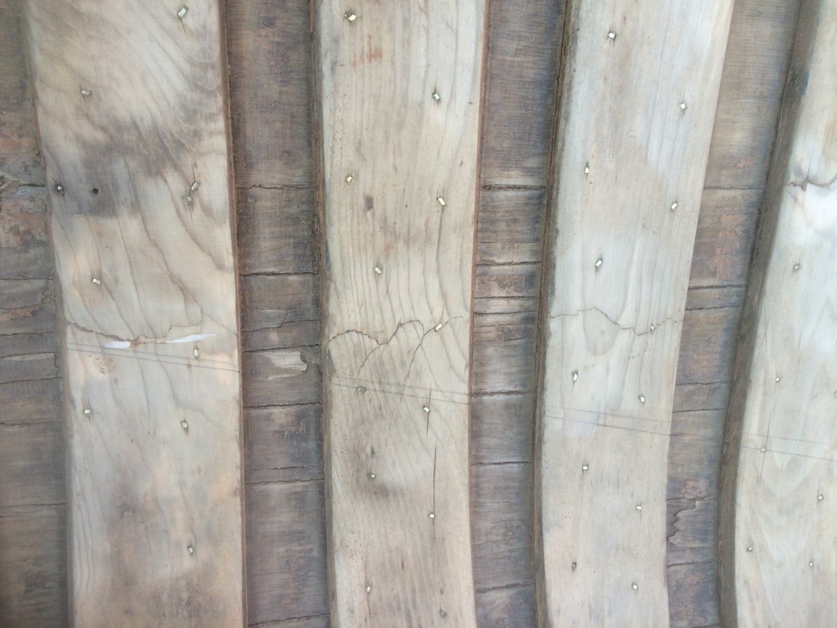

Some of the broken ribs that I plan on resin and sistering.

as you can see from the picture above , i have about 8 or 10 cracked ribs. during my sistering repair, what are adequate adhesion glues. I'm looking at the west system with the 403 filler. is there any glues or resins that are adequate at a reduced cost ?

I understand the ongoing debate of adding a keel to the underside of a canoe. How ever , is it worth adding a keel inside the canoe down the center of the floor affixed to each rib. I'm not sure the proper name but will it add strength to this old girl ???
A "backside " repair requires access to the backside of the rib...unless you are going to remove the fiberglass from your boat there is no practical way that you would be able to make that repair. If you took the time to remove the glass then you'd be better off replacing the ribs given that you want the boat to be battle worthy. For your situation screwing and gluing patches over the cracks is probably your best bet.... use brass screws and use the same cedar you would use for a rib. Reach at least 3 inches past the crack on each side if you can.

Crap, wasn’t aware of the glass. Backside repairs and rib replacements are not options. Thus a good argument against applying glas.
Sorry.
Sistering is about the only option.
"Keelson" is the term for an inside keel. It will minimally add some strength and stiffness, at the cost of providing something that will perpetually be in the way -- something to trip over and to keep things (coolers, bait buckets, etc.) from laying flat on the floor. I wouldn't bother -- the folks who built the canoe didn't, and your canoe looks like they know what they were doing.
If you look around, you will see that keelsons are very rare in canoes -- when they do exist, as often as not they are present as part of a home-built or kit canoe, where the keelson served primarily as part of the construction apparatus rather than as a necessary structural part of the canoe.

Further. your photo above shows the canoe supported on two horses near the ends of its length, leaving the middle inadequately supported. In such a situation, you are going to see the canoe flex, and indeed, if you were to step into the canoe supported that way, you well might break something. But you have a canoe, not an I-beam, and neither it nor any boat should be expected to act like an I-beam. A canoe (and most any boat) is designed knowing that it will be supported by the water along its entire length. You would likely not see any flex at all when in the center of that canoe while it is floating, even with a heavy cooler or another person right next to you. It is probable that you are seeing your empty canoe flex as you lift it and move it around on dry land, especially on those horses. But with even a heavy load spread out normally -- people and impedimenta spread along the length of the canoe -- you would not likely see any flex.
Move those horses closer together -- generally try to have about 1/3 of the length of the canoe on either side of the canoe -- the center of the canoe, being wider than the ends, usually has more weight and support should be placed to take that into account. The stern of your canoe has a transom, so your supports might be
placed asymmetrically, with aft support might be a bit closer to the stern, to deal with the slightly heavier stern.

I just finished milling some cedar to cut and sister the broke ribs. Super excited to glue this old girl back together and lay the spar to the inside !
In an earlier post you mentioned that this canoe was going to get hard use. Some camp canoes and others that got rough use doubled several ribs, sometimes termed wanigan ribs, because they supported the wooden box 'wanigan', protecting the floor planking. Rather than glueing only a short splice over a cracked rib, maybe double it from bilge to bilge, particularly so if the position of these heavier ribs will support the sports gear, food box, cooler, etc. that you plan to carry. Tom McCloud
Chestnut’s Ogilvy canoes, which were intended for use salmon fishing on NB rivers, were built with extra thick ribs and very closely spaced. From the pix you posted, it appears Bill Miller may have also used very thick wide ribs and close spacing. Before I added a keel, outside or inside, I would consider that Miller knew what he was doing in the first place and you likely already have a tank. The one Miller canoe I know of, a 20 footer, WAS a tank. What are the dimensions of the ribs and how close spaced are they?

The existing ribs are 2.75 inch wide and spaced at about 1.5 inch.
I plan on over lapping and sistering broke ribs at least 3 inches on either side of the crack.
Must I also use screws or will glue be sufficient.
I would use screws, primarily to serve in place of clamps to insure good contact between the pieces being glued as the glue set up. You could, I suppose, use weights to hold the parts together, but somehow I'm never quite sure that weights are doing enough. A proper glue joint with Titebond 3 will be stronger than the wood, but getting that joint tight enough as the glue sets up is critical.
