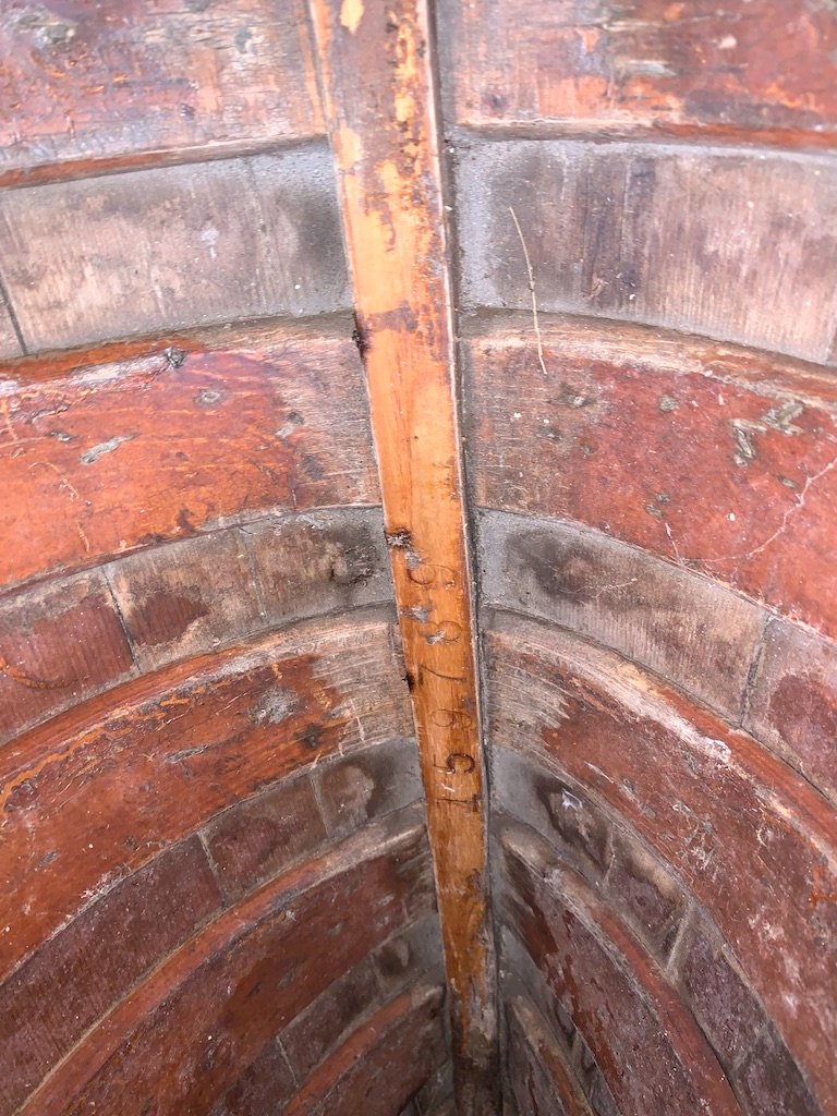

I have been striping this Old Town Scout down. Well I think it is a Scout. It has the extra short rib in between the full rib on the floor. No decal.

It didn’t leak much before I started removing paint with a heat gun but it was cracking bad.
#159789
You can easily paint it and see if that will give you another year or so.
The Old Town canoe with serial number 159789 is a 16 foot long, CS (common sense or middle) grade, Yankee model with half ribs, and a keel. It was built between April and October, 1953. The original exterior paint color was dark green. It shipped on July 9th, 1954 to Columbia, Missouri. A scan of this build record can be found below.
It is also possible that you could have another number or manufacturer if this description doesn't match your canoe. Page 11 of the 1954 catalog at https://www.woodencanoe.org/_files/ugd/537308_1114e7b1c8f541d480d8ff52c4eb10e3.pdf has more details. Feel free to reply here if you have any other questions. Thanks,
